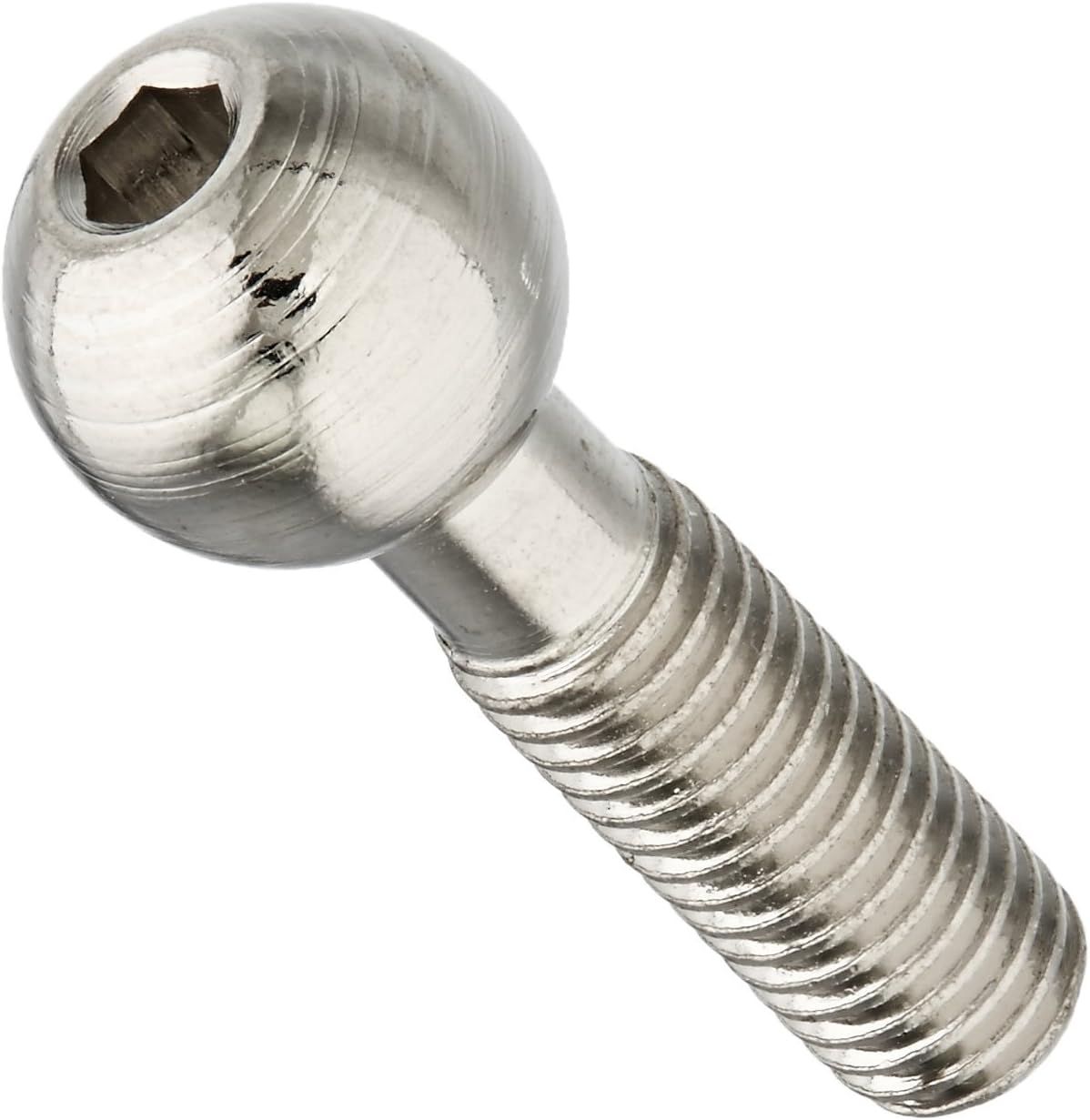

Better laser guide mod?
Thanks! Found them that way. I searched those terms on mcmaster and figured I must have the wrong name!
Not sure if its the right size
Thinking about trying to fab those mounts the reviews were not very good… And they’re not really that cheap… I should be able to make them for at least twice as much money and 8 more hours! :slight_smile:
I too was wondering if those held the lasers secure enough, or were they just fiddly.

Well the lasers arrived today, and only one holder. My stupid fault, somehow, I only ordered one. so here I am waiting again. :crazy_face: :tumbler_glass: :tumbler_glass: :tumbler_glass:
Well, I’m an impatient old fart, so I McGuivered a little something in the interim. This laser cross-hair implementation is pretty damned neat! :rofl: :beers: :beers:
Looking at that I wonder if it’s not a good enough long term solution? The reviews of the amazon mount weren’t great how did you find them @Cletus ?
I am tending to agree with you @ScottNH . I find the commercial mount pretty iffy, whereas mine I’d say is pretty solid.
I think once you’re happy with the alignment, a drop of crazy glue on the balls, locks everything in place nicely. Then, if you really need to move it later on, a bit of force, a heat-gun or both, will loosen it all up nicely.
I would definitely avoid crazy glue on the balls. :rofl:
