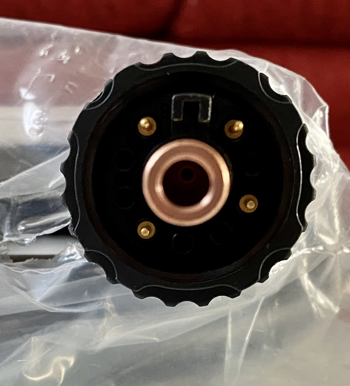

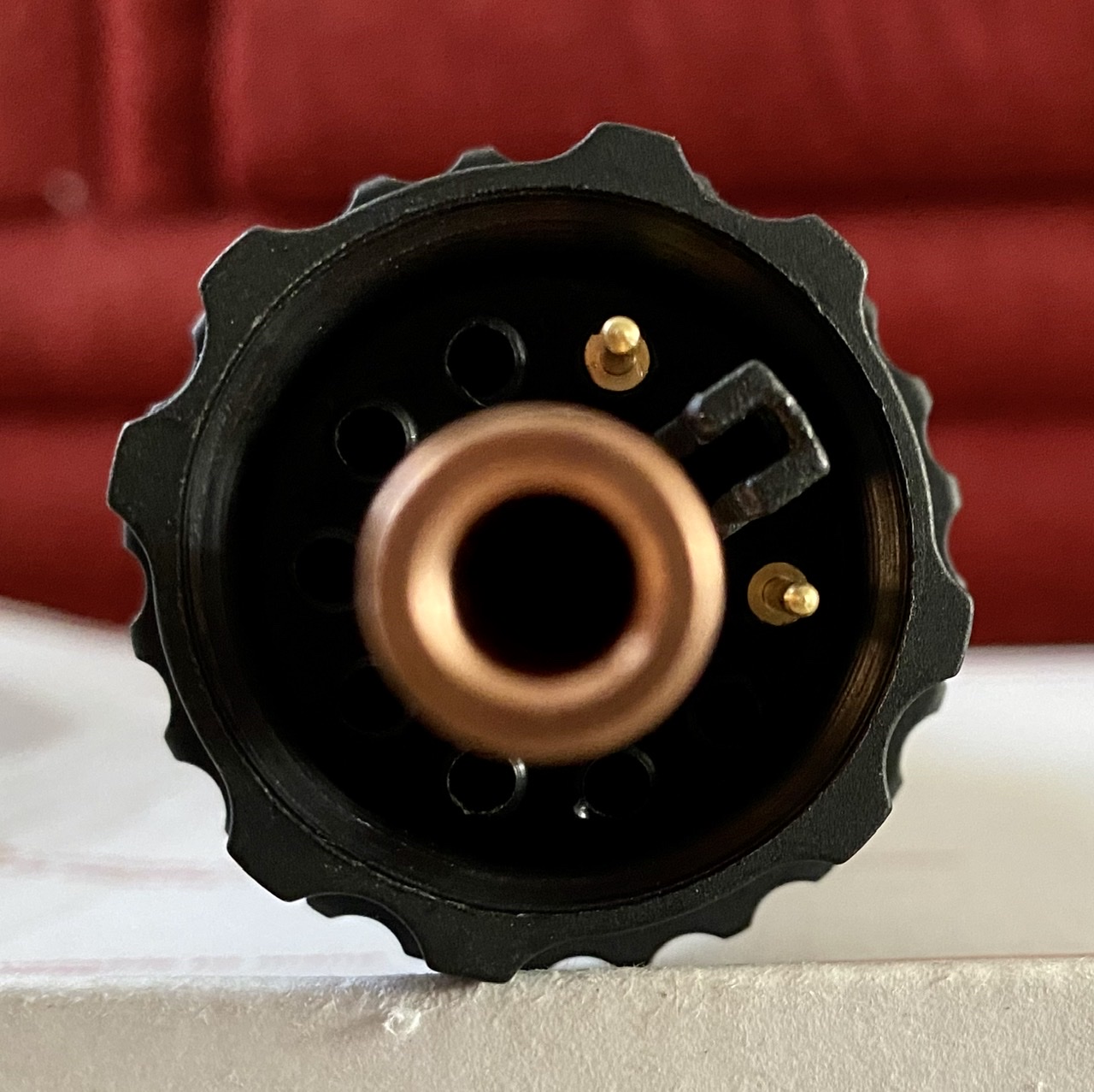

Can I ask who you purchased your machine torch from? In regards to the RazorWeld Cut45, the hand torch that came with it has 4 out of the 9 pins utilized (1, 3, 6 & 8). With the machine torch upgrade there are only 2 out of the 9 pins utilized (1 & 9). As I’m sure you know, no pin set is required for a physical trigger on a machine torch, hence the removal of 2 pins from the hand torch. Here is a picture of the hand torch connection and the machine torch connection for your reference. Let me know if I can help in any other way!
