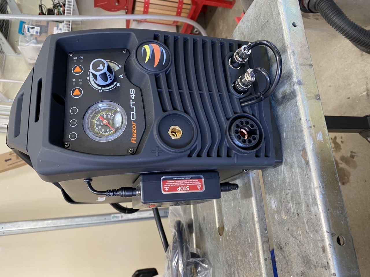

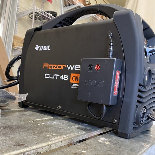

RazorWeld Cut45 has been modified for cleaner wire management and the installation of the Langmuir voltage box for the THC !!!
Clean. Bravo!

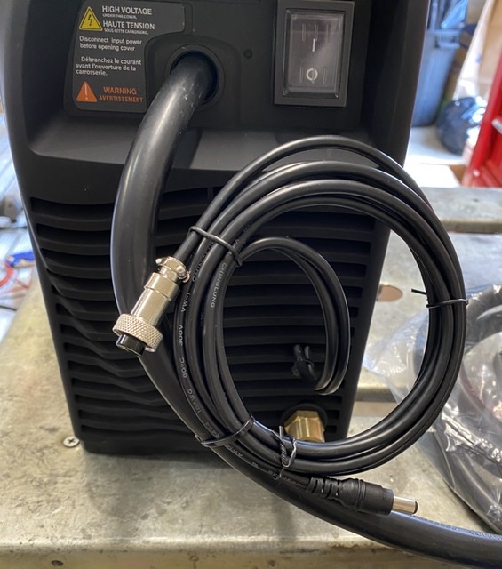

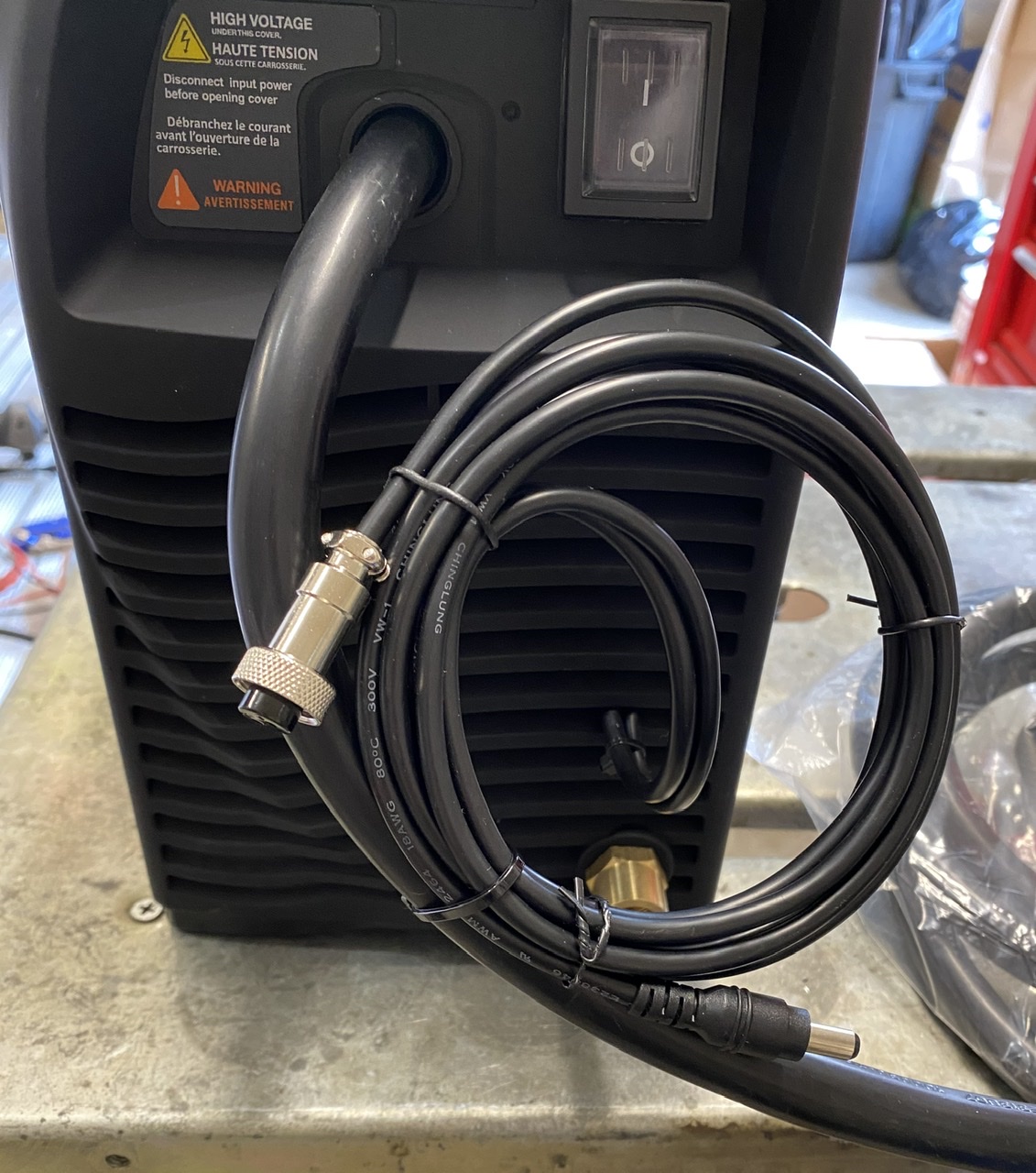

Did you get one of the connectors with the Plasma cutter and the other one with the THC? When my RW showed up, it had the 4 pin connector only. Does the 2 pin connector come with the THC? Thanks
Mine had both the Voltage Divider Cable (DIV) and the Torch On/Off Cable. Both connectors are 2-pin though. Here’s a picture of the 2 cables (left is the DIV, right is the Torch On/Off).
