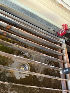

Has anyone from Langmuir tracked this thread and determined that Bar sink drains are preferred on the water tables? As easy as this change was to make, It would seem to me the tables should come this way from the factory judging by the popularity of the mod.

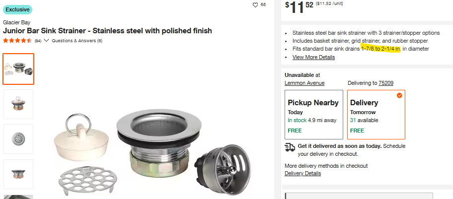

I bought these drains at HD, read that they would fit a 1 7/8 to 2 1/4 hole. Used a 1 1/2 pipe knockout (1.95" OD) and it doesn’t fit flat. The radius holds it up.
Please add me to the list. Thanks
This is the same drain I used. It fit for me
