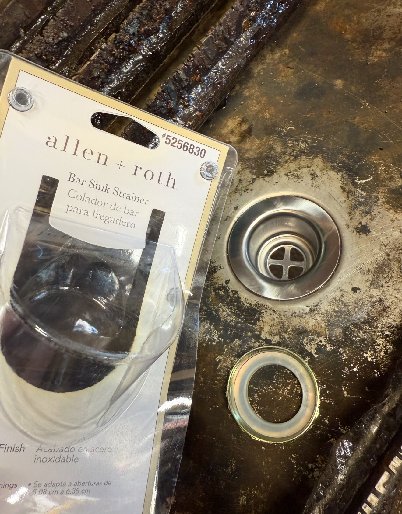

Here is another brand of bar sink drain that works perfect. You can pick it up from Lowe’s for $12
Silicon the drain in and use the large rubber washer the drain comes with underneath with the nut to tighten. Then use the drain nut to either extend a custom pipe section to your liking, OR just cut a thin metal disk to fit inside the drain nut (1.8 in or something) and now you have a stopper cap to plug the drain . Simply unscrew with a bucket under the table to drain. I wouldn’t trust the strainer plug that comes with it as it doesn’t appear to twist and lock like I’ve seen other drains.
Nice flush fit

FYI the Menards bar drain does not fit. the top flange is a little too large.

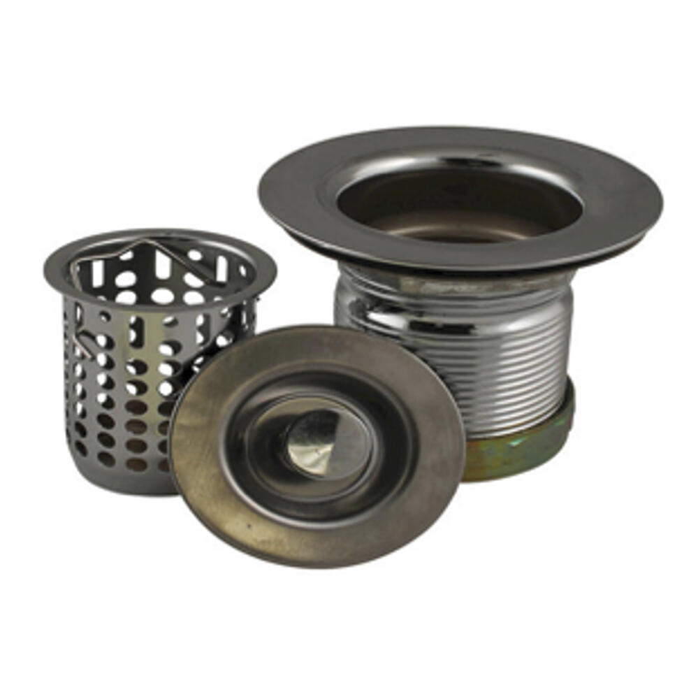

the original Amazon link seems to not be available so I will need to find another option.
This is the one I used, it fit the recess just fine but I didn’t think it tightened down like it should. I cut a 16 gauge spacer/washer to make sure it tightened fits and snug.
I cut a piece of cardboard first so I could fill the table with water and cut my spacer.
