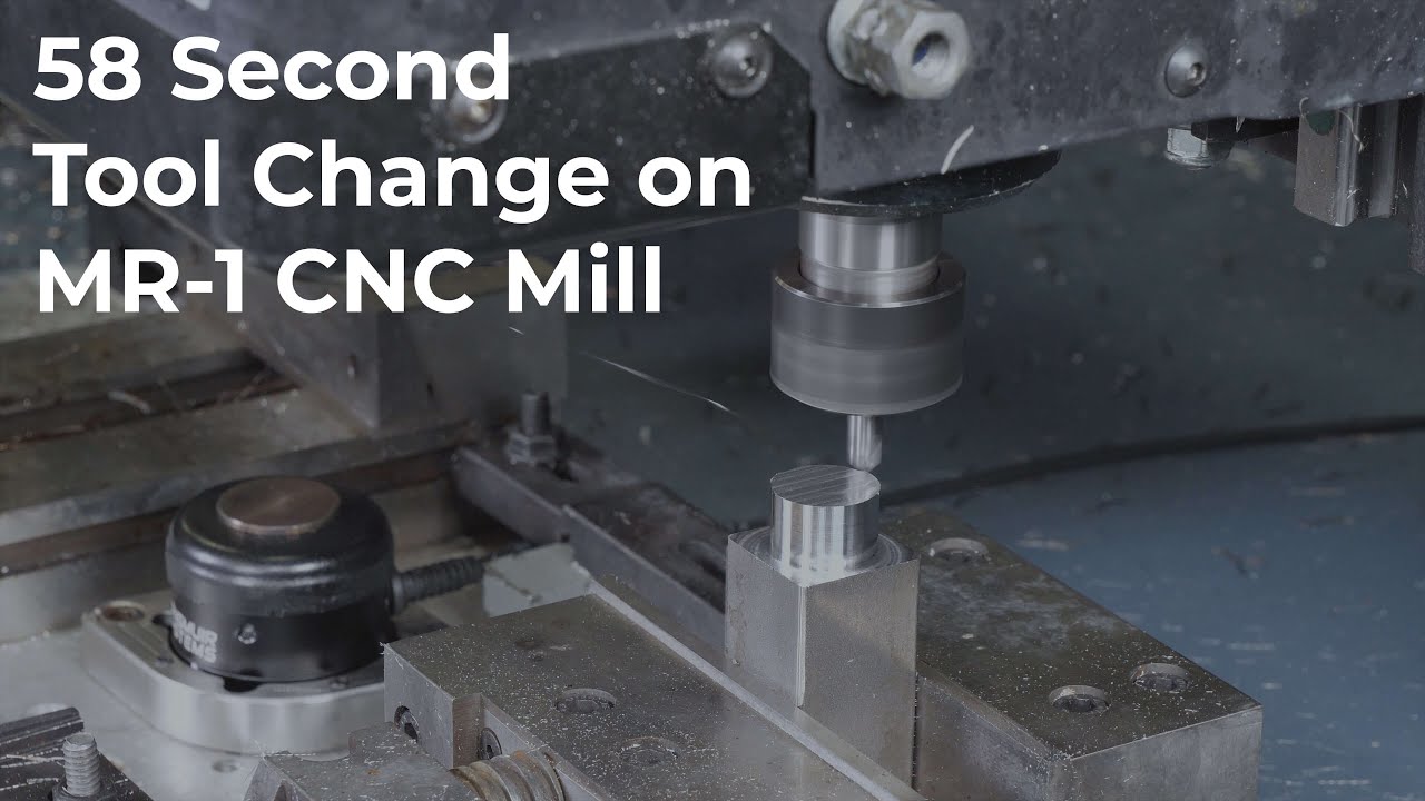

I don’t foresee an ATC for this current design.
I can’t remember where I read it but they already stated there is no plan to ever include a tool changer.
can confirm. Aftermarket will be the only way.

Per a post on YouTube, there are zero plans for an ATC.
The spindle design does not allow for an ATC to be implemented. This discussion keeps coming up in the youtube comments and on social media. There are no plans for an ATC for this machine (As previously stated by Langmuir), as it simply is not designed to accommodate an ATC whilst retaining the claimed repeatability or tolerance.
In addition to it not only being not possible with the spindle provided, the pros and cons of implementing such a system would require a fundamental rework of the machine (And quite frankly in order to hold proper tolerance and run out, it’d contradict the whole gantry style mill idea, as well as further restricting the already limited Z axis height) These design philosophies and decisions is WHY this product is available at the price it is, and capable of what it is - at it’s price point.
I understand the quality of life an ATC brings, but unfortunately it will contradict everything this product excels at - and for the price point that it is available, a 60 second tool change really is a small price to pay. My solution to those who will debate about production times being increased - you’re purchasing a hobbyist cnc mill which competes with small production units, and if the 60 second tool change is too much to absorb, then learn to optimize your CAM files better. There is more time to be saved in better CNC practices than an ATC.
This is not a wood router - and does not have the same expectations from the community as a wood router. To my knowledge, there are no other products in the market that compete with the MR1 in terms of affordability, capability, and manufacturer support (I’m sure you can find some unnamed offshore machine to support a debate).
The test machine was getting as close as 0.0005" on the test video. Find me a mill under 10k that can do that (With evidence, not just spec sheets). That is ten times more accurate than the typical accepted industry standard of 0.005".
The 4th axis option is not a bad idea - however it will run into the same issue: How can it be implemented without seriously impacting machine performance.
