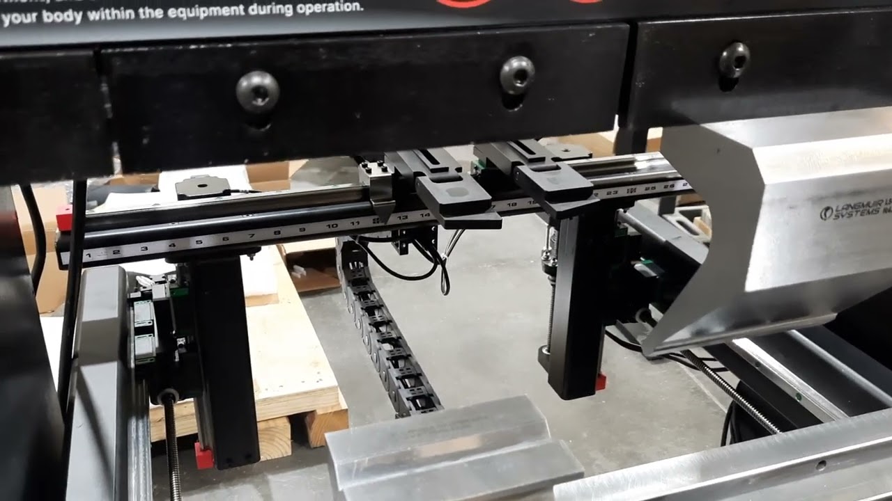

Here is a guide to troubleshooting binding issues on the backgauge. If you go through the guide and find that the R1 motor is failing (like from something like a cut wire), then shoot me a message at support@langmuirsystems.com and I will ship you out a new one.
Will do, thanks Sam.
We switched R1 and R2 connections on the back panel to test that the motor drive current was set correctly. It is, R1 continues to stall. Our next step is to pull off the stage and check the motor, nut and bearings.

R1 rapid stalling workaround. It’s not perfect but functional.
As a senior machine designer, locking two parallel shafts or ball screws is not deal unless the mounting points are machined or at least one side reference. The alternate is let one side float as you have done and not discussed in assy instructions . I guess "Bob is our go to guy?
We needed to remove all the paint paint on 2 sides of both of the front stock vertical guide sq. tubes so they would slide up and down. So now the mild steel can/ will rust… Very similar to the 4x8 XR round Y axis guide tubes no warranty on finish…
My partner, mechanical designer, looked at the 25T backgauge and commented, “this design is heavily over constrained.” I’ll say that the motor torque and lead screw advantage invites tweaking the crap out the backgauge if a stall occurs. Particularly at rapid feed rates

double check the X and R stepper motor wiring. One of X’s had a phase swapped, so jogging one went in, the other out. Tweaked the backgauge, the sliders, mounts etc. Not good.
