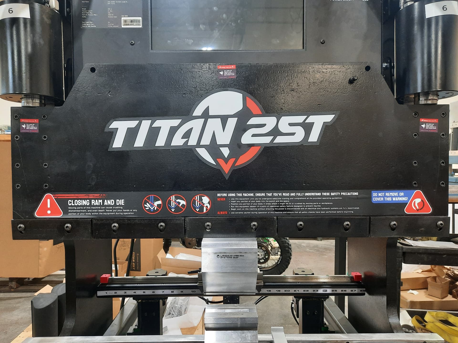

We didn’t notice at first but quickly saw that 4 of the 5 ram stickers aren’t applied square to the surface. Maybe we got a Friday afternoon machine.
They need the assemblers name on every build sheet. That is total “I don’t give a shit crap” This way they can be weeded out or trained properly.
Truthfully that huge sticker is a little too much.
A small brass badge name plate in the upper right would give the whole machine a different look.
I miss older machine and equipment badges.
Agree, we’ll pull it off.

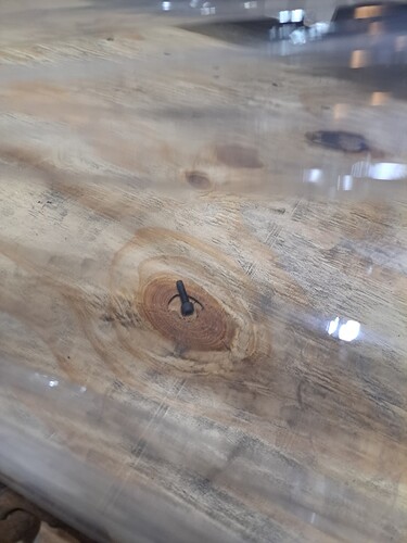

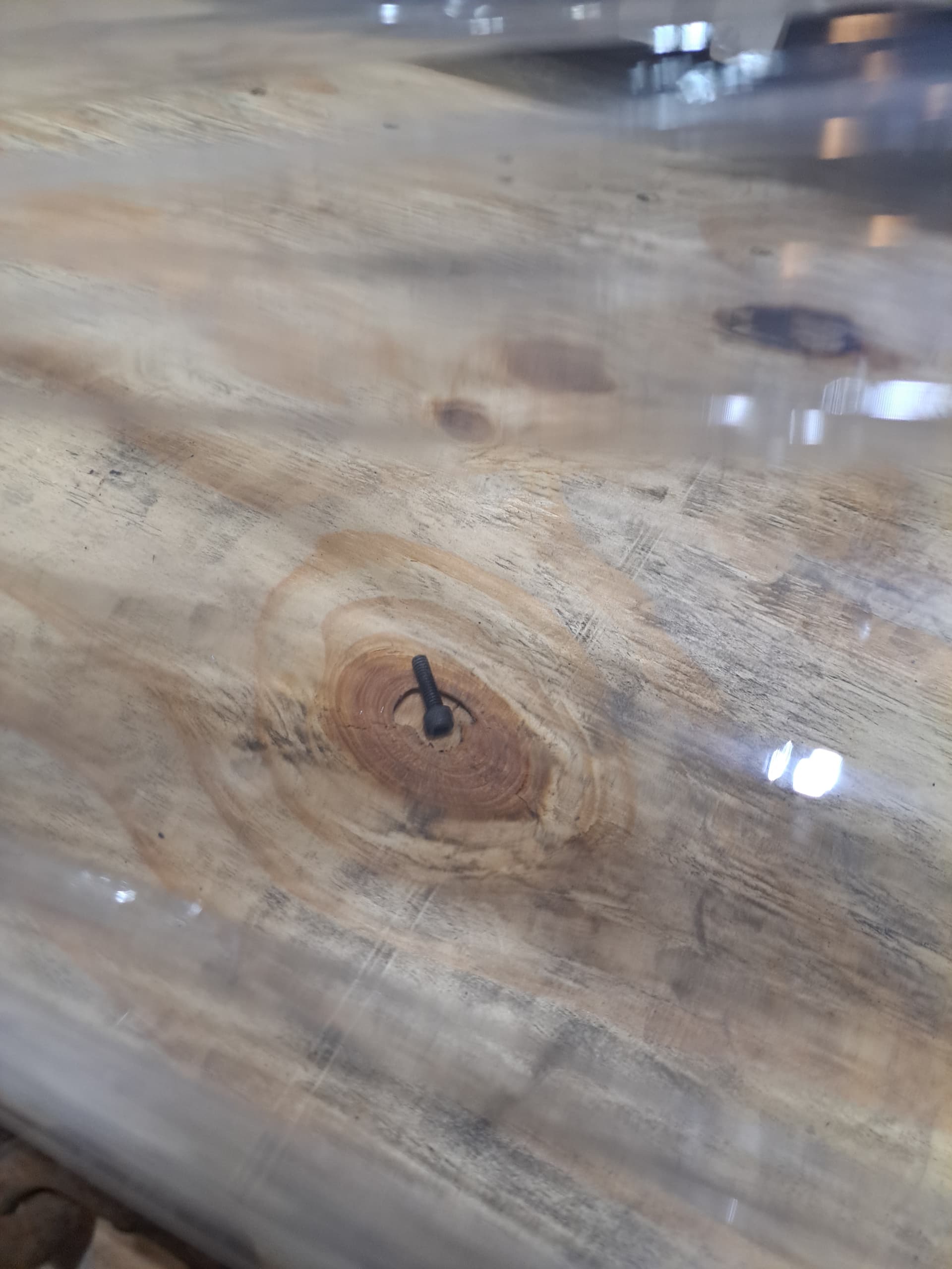

you ever get that sinking feeling in your stomach because you just spent over 7k on a new machine and there is a random hex head bolt lying on the shipping pallet?
lots of loose screws on this thing right out of the box.
we’ve all been there, good luck with your hunt.
I had bolts missing out of the antibind arm, I later found in on the shop floor after cleaning up the mess, it’s a long one just like the one in your pic. After you bend a few things, you will love it :slight_smile: bit of a learning curve but you got this!

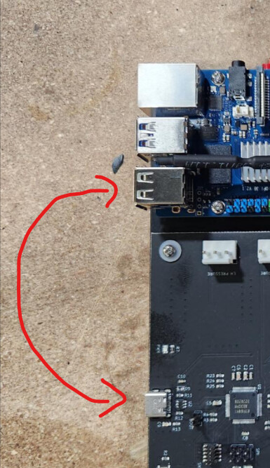

For future users: The ‘unkown machine status’ is this connection failing.
It may have just gotten unseated and getting that properly plugged back in will help.
