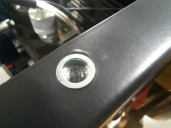

Santa Langmuir dropped our 25T off today. We’re assembling now and found a problem.
We can’t remove the top cover because the press fit rivnuts have pulled loose from the inside and turn with the screws. Not good.
Any ideas how to remove these screws then fix this so we can then reattach the lid? Screw shown is cross-threaded as well.
Drill the head off the bolt then you can install a new one.
This is what I was thinking. Thanks.

All better, I was able to grab a hold of the screw nubs and get them out. Tightened up the rivnuts and ran a tap back down the threads. That took about an hour but I avoided getting steel chips in our new machine.
