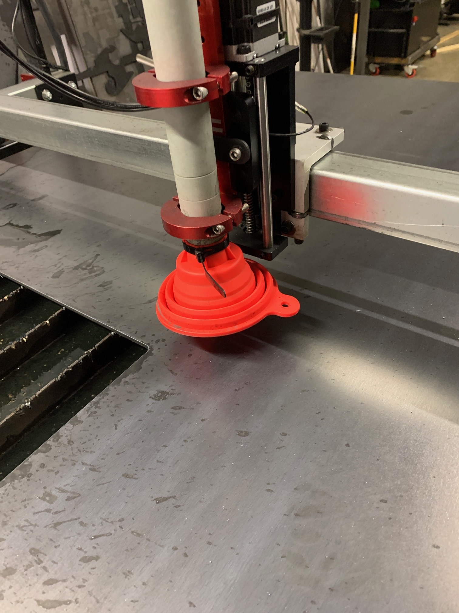

@directioneast have you installed your adapter plates to raise the rails? This is on my list of things that I want to modify on the table. I think that getting some more distance between the water table and the Z-axis carriage will keep it much cleaner.
Hey directioneast. I think a lot of us have that problem. Here is what i did thanks to #mancrafting. It works like a charm. It cut down on the water splashing not only on the z axis, but everywhere.

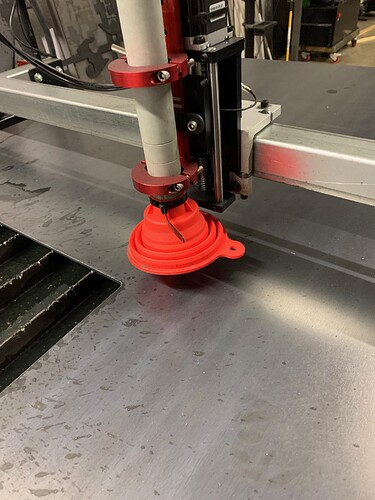

I finally got the 3" stansion plates on. I’ll make my new water table about 1.5" taller so that will still help with splash up. I will be getting a silicone cup to try out also. By raising the rails it allowed me to push my torch down more so its better balanced. Can now actually slide full sheets under the rails too.

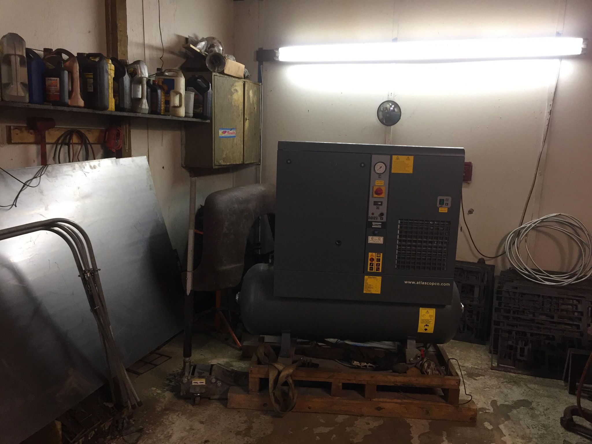

Need to find time to hook my other compressor up and run my air lines. Everything is just a mad mess right now. I been cleaning out my printshop that is 100 miles away, this compressor was used there so thought I’d put it to use. Only 60g but its a rotary screw, much more quite and efficient, also has built in cooler.
That compressor is nice! Will be interesting to see how it impacts your production.
