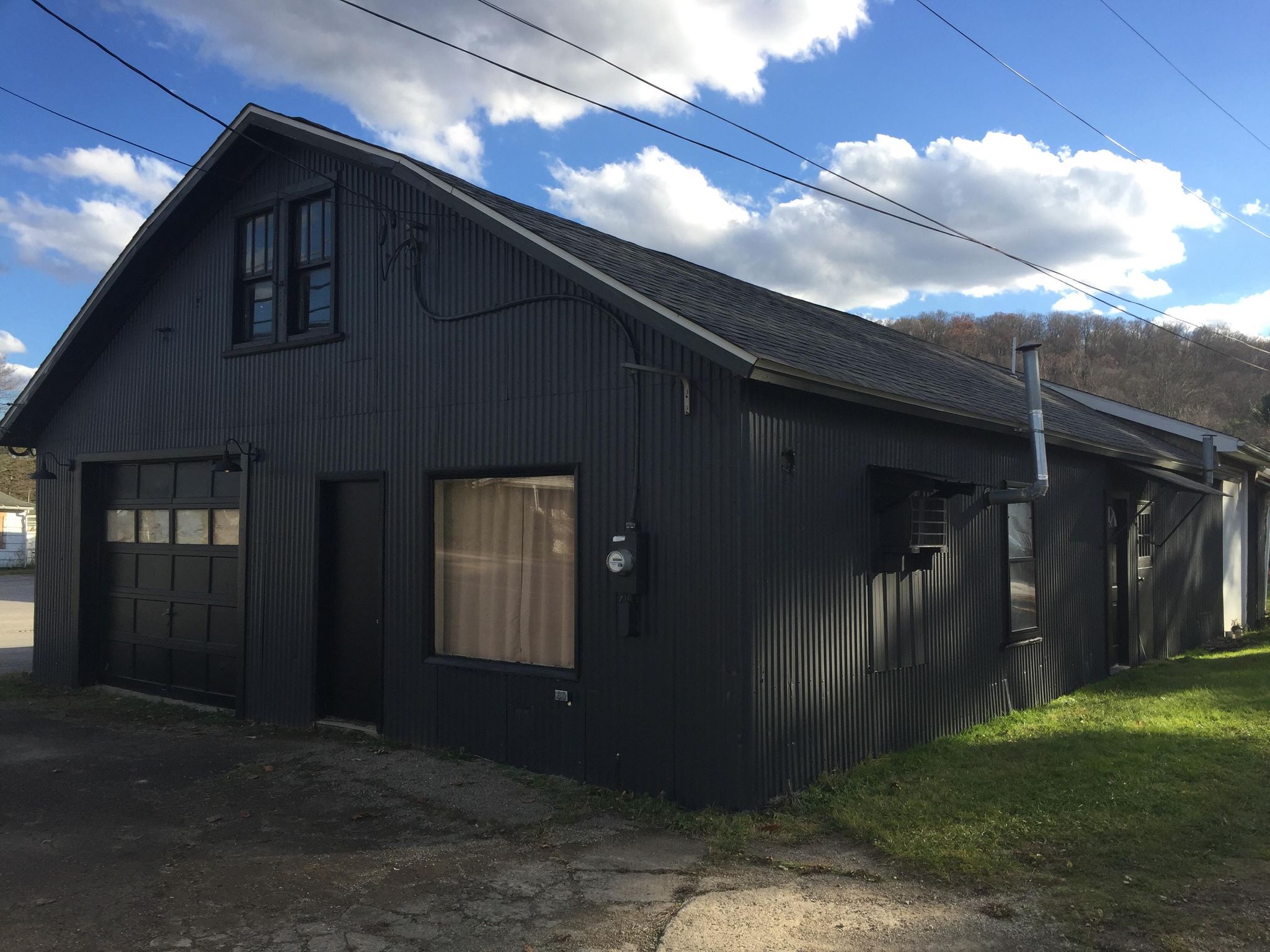

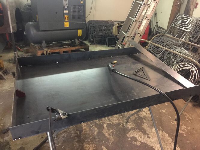

Yeah can’t wait to get it hooked up, air lines ran etc. Much needed shop cleaning. Im always on the scramble so nothing gets put where it needs and or too many things get neglected. My shop floods in the summer so that never helps with time and or where I can put certain equipment. I did manage to paint it right bf snow came so that was a few years overdue! Been working on some electrical stuff too. Need to run some new lines for compressor and welders etc.
Yeah, that looks like a nice compressor.
Yeah they are top of the line, very expensive. I think this unit is like 5500 or more. They are pretty complex inside. Iv already had to have help working on it. Low hours though, should last a good bit. Its pretty quiet compared to normal compressors.

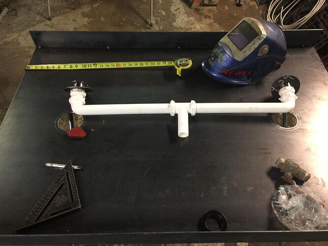

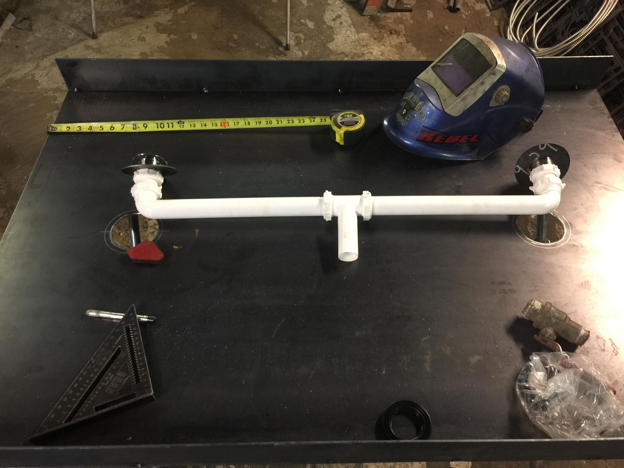

started on the deeper table too. waiting on drains to come. This is about 1.5" taller and wont leak!

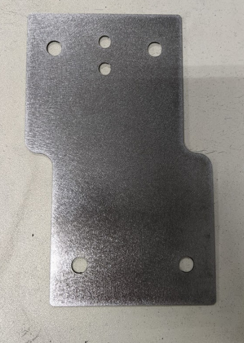

@directioneast how are the riser plates working? I am drawing a set up today and I actually need to shift my Y axis back toward the back of the table with an offset in the plates because of my torch mount. Also I second what was mentioned above with the silicone funnel. I had a chronic THC issue caused by splashing on the Z lead screw and lead nut, the funnel has helped tremendously.
The taller stanchion plates are working great. It has really helped keep the z axis clean and the rails. Still get some splash up on the rails but not as bad. It was nice to load some longer sheets that I wasn’t able to bf. I raised rails up 3". Should have water table done this week I hope.
I added a .75" offset in my test stanchion plates to move the torch back from the front edge some. What thickness of material did you use for your plates? I have some left over 10ga, I wonder if that would be stiff enough.
thats a good idea. I used 3/16 . I been thinking if I had more time, I’d build a new track system that isn’t as wide as LM. you could easily gain 2 or more inches of cut if the Rail system was different. Also I thought by putting the X axis lead screw on top of the X tube instead of behind that would keep more debris off it and get you a little more room too.

Time has been insanely scarce as Im building a 50" press brake and doing some work around shop, filling tons of orders and need to get this water table done. I managed to get some plumbing for it, just need to get some hose to connect to my ball valve, weld it all up and install. Got he drains off ebay, didn’t realize they were plastic so might upgrade later. They are 1.5". I made a recess in the table rather than dimple dying the centers. You’ll see better once I weld it up.
