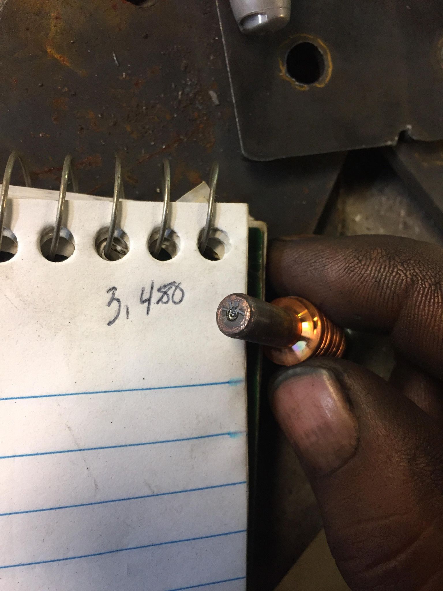

Well this set of consumables is nearing its end. I had about 3500 pierces and I’d guess around 15000 inches of cut. They still cut good but I’m finally seeing a divot in the electrode. I had over 4 misfires today in about a 2hr period. FC detected one of them and that is it. So that type of stuff just hinders production. So I’ll move these onto seconds and see if I can cut some 1/4 with them or use them sparingly. From putting in old consumables Im starting to document some extra pierces from them, example I counted about 300 pierces today from them. The 3500 pierces I got was only on 1/8 and 3/16. I’d imagine I could get much more life out of them on 1/8 and thinner. But any thinner and I’d drop down to the fine tips. The table was fine today, no issues. FC still that glitch of having a pop up warning window after you pause. It only does that if it detects a misfire, then after that every time you pause the file, it pops up that same window. Or if you let FC set too long on paused it will do that also. At any rate, the cut quality and consumable life is what Iv gotten in the past, perhaps a little better now. The machine is cutting and acting good. I wish it was like this in the beginning bc the first 5 weeks just seemed like a nightmare. I’v been thinking of possibly selling one of my CF tables and getting another pro. Was also really looking into a JD sq table which is over 4x’s the cost of the PRO. So next year I’ll cross that bridge. Maybe langmuir will offer another platform.

Here is a pic of my consumables at about 3500 pierces. I can def use these on other stuff but I’ll take them outta normal production.

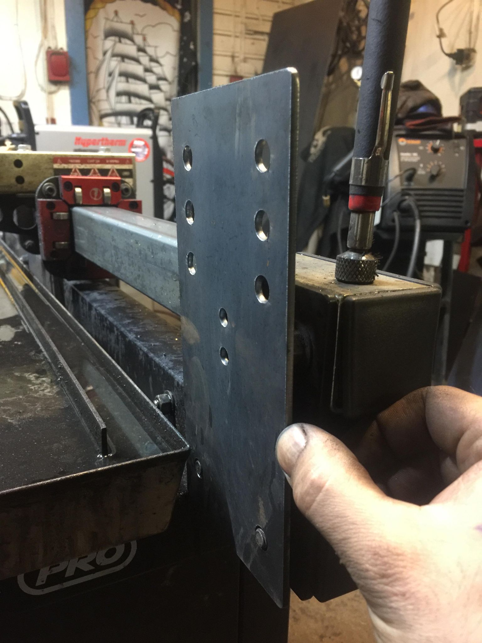

Been so busy its hard for me to get anytime to do anything outside of running my business and family. I tested a moch up plate to raise the rails up. I did a 1, 2 and 3 inch increment. I think I’ll go straight up to the 3 and see how it goes. This will allow full size sheet of material to stick outside of the table while cutting, which is a big deal IMO. Hoping it will keep the rails a bit cleaner. Also I can now lower my machine torch so it will proportionately balance better. I’ll also be able to clear more parts that are cutting on the outter edge of the X axis. The way LM designed the support angle gets real close to tipped parts. Lastly this will allow me to make a deeper water table.
