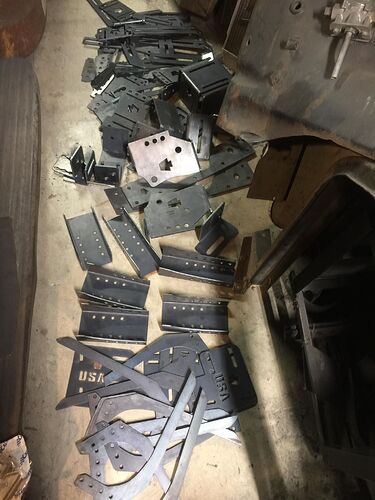

I had new consumables in today, well they had 200 pierces on them. I got 3 misfires at around 520. So after that file, I stopped and cleaned out everything and put back in. I then ran from 520 pierces all the way to 860 pierces with no issues at all, even letting the compressor run its balls off. I then took them out and used some old ones to cut some other sheets. So that is the plan as of now is rotate older consumables in on certain sheets that don’t have a million holes in them.
I was able to my whole kit cut in 2hrs and 25 min and that is with the Z axis issues and somewhat taking my time. In that time I scrapped a ton of my parts which is a huge time saver come fab time. So a day like today is all I ask right now! Here is a pic of around 750 pierces and 4500 inches of cut.

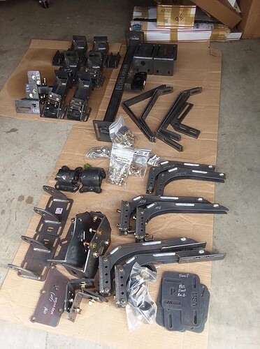

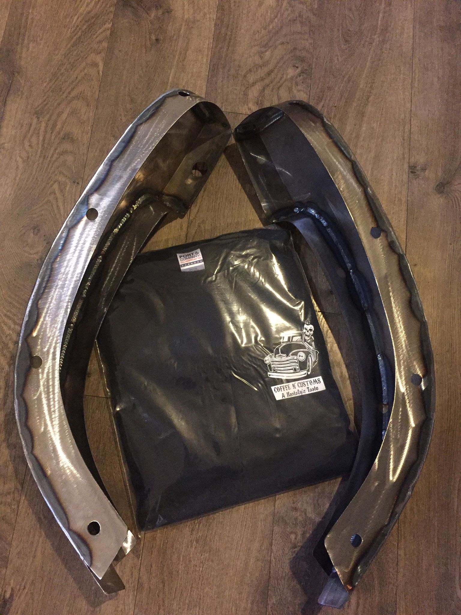

Here are some product pics. Everything I do is proprietary and geared specifically for 47-55 chevy trucks. the main stuff I do is swap kits to put them on modern chassis. I have people all over the world hitting me up. I make motor mounts and patch panels too. Im working on a 4 link for air ride, just pressed for time right now.
