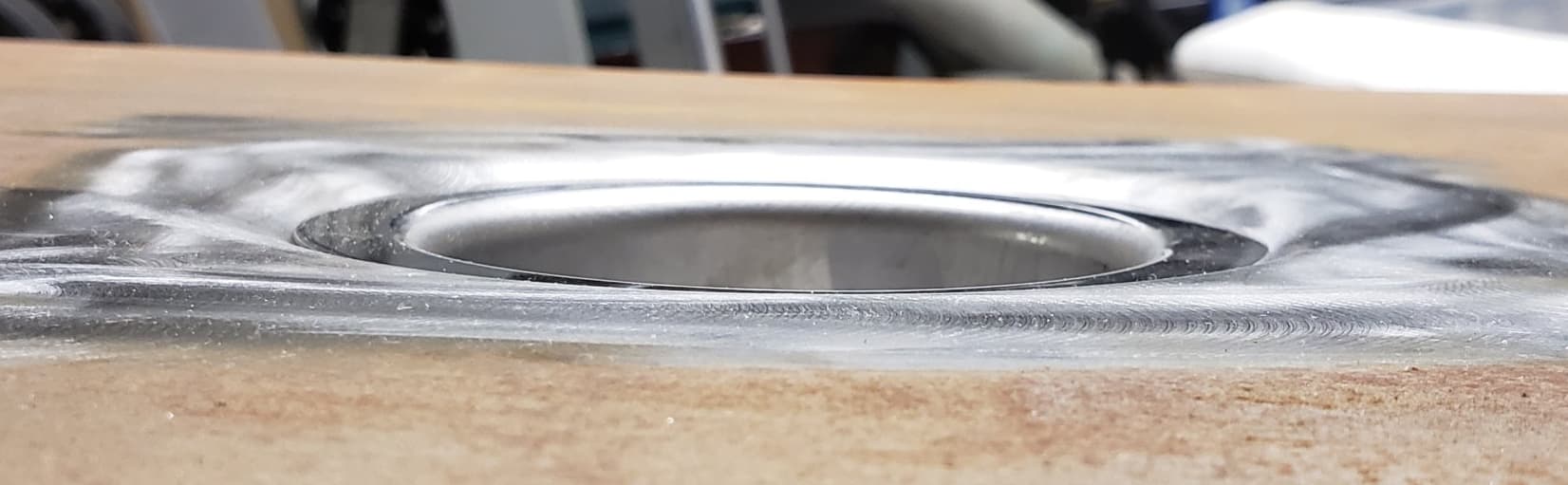

I have already dimpled my tables but the flow is too slow. I want to install kitchen sinks that stay well below the surface so I can drain the tables in seconds. I never re-use the water as I give it to the trees.
This is the prototype dimple on 1.6mm steel. As you can see the kitchen drain is fully under the surface unlike it happens with some of the dimple dies I’ve seen.
https://www.homedepot.com/p/Glacier-Bay-Fixed-Post-Kitchen-Sink-Strainer-Stainless-steel-with-polished-finish-7043-103SS/207144421
This is the drain I used that is easily available at most Home Depot’s for relatively cheap.
These are the 3D printed dies. I need to work on the final form that I will distribute in the public domain as it needs some parts with 100% infill to withstand the compression force and others that are just for alignment. I’ll post an update soon but I would like to test this on a piece of scrap stainless
could you take a picture of the drain again but with a straight edge going across the drain and touching the pan on each side…

Curious if this worked for you. I designed a 3D printed die for the common Home Depot kitchen sink drain. I used a hydraulic tool and the die failed. The plastic just crumpled or broke. I used 100% infill, trying to dimple the crossfire water table after I plasma cut the stock drain hole to fit the Home Depot drain. I end up installing without a dimple, but I’d be curious if you were successful in your attempt.
