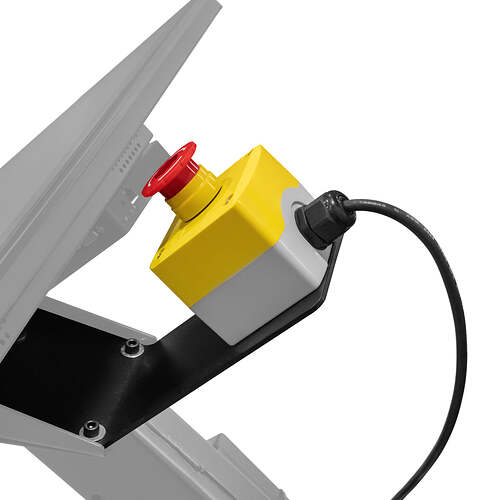

Wireless remote emergency stop
Has anyone built a wireless remote emergency stop?
would be nice so i can stop the machine from across the shop.
You shouldn’t be on the other side of the shop with a CNC table running!!!
The key word here is ‘EMERGENCY’.
I would not trust anything other than a mechanical contact that disconnects power in an ‘emergency’ with a torch capable of producing over 10,000 degree flame (and probably a LOT of RF static in the process).
I agree with everyone here — the entire purpose of an emergency stop (e-stop) is reliability. In a proper industrial setup, e-stop circuits are active, meaning they require continuous current flow during normal operation. The e-stop switch is normally closed so that current can pass through. When the switch is pressed, current flow is interrupted and the machine shuts down.
This design also protects against wiring faults: if a wire breaks and current stops flowing, the system treats it just like an activated e-stop and prevents the machine from running.
Wireless e-stops are technically possible, but must be designed with safety in mind. The transmitter needs to send a constant heartbeat signal—typically 10–100 times per second—to the receiver. If the receiver’s timer runs out because it stops receiving that signal, it will open the e-stop circuit and immediately halt the machine.

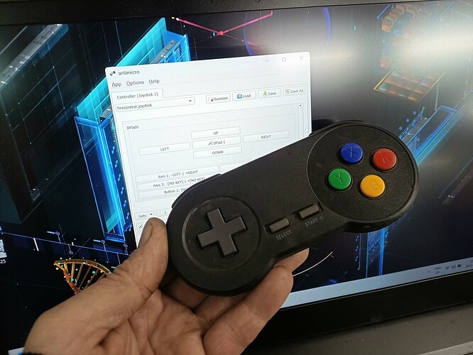

I ran my Crossfire Pro and now run my Crossfire XR with a Wireless SNES style controller. While I do not leave my CNC running unattended I do use this controller to Pause (yellow)or Stop (red) the system in case of a tip up, error or potential crash . It has saved me many times. I beside the controller not connect rarely before i start cutting or going to sleep mode during a long cut ( a key press will wake it and the next key will register ) I have had little trouble. It make is very nice to be away from the computer to input a starting location or to save your from a crash or issues while you a watching the cut closely.
I do concur with everyone about not leaving the machine unattended.

No argument that having remote ‘controls’ is useful, however, the topic is Emergency Stop and I would never rely on such a device for an EStop function.
I do have this one but it’s not wireless

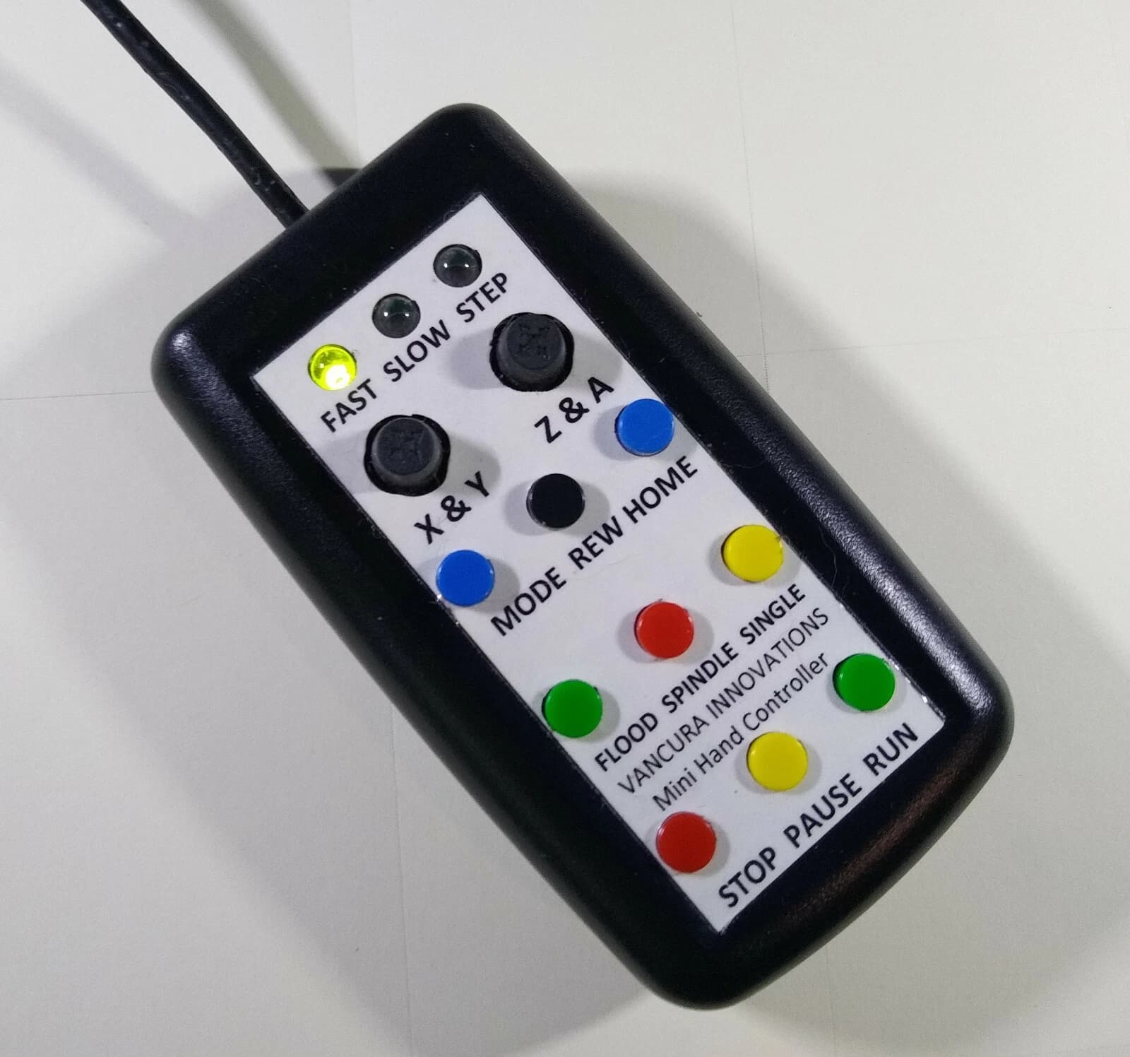

A few years ago, I made a USB connected (not wireless) hand control on a 6-foot cord that allows me to control a http://173.26.168.182/files/Universal_KBD/cnc_hand_controller.jpg
MACH3 based CNC while I am at the CNC machine but more than an arms-length away from the keyboard. The buttons emulate a standard keyboard, so that the program is fully in my control. It, however, doesn’t do E-STOP!
I made it fully user programmable using a scripted text file so that it could be compatible with any control software that uses keyboard commands.
If anyone is interested, I offer these for sale at $65 plus shipping. There is documentation on its use and programming. Default program is Mach3 compatible, but once reprogrammed, it doesn’t forget the new settings. It is also listed on eBay.

I designed the printed circuit board, had a few made, wrote the software, CNC’d the box and decal holes, and assembled it. I just don’t do the big stuff like you guys do, and I like to see what you all make.
You are correct that the E-Stop needs to be hard wired in a closed loop. Safety is everything. Nothing says you can’t have more than one EStop.
wire them all in series and you’re good.
