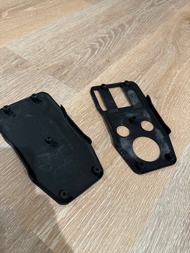

I’ve made some cosmetic improvements. Dongle’s pcb production is complete and I’m waiting for the delivery.

The greatest challenge will be proxying the usb connection, I will receive the new pcb on Tuesday. I guess it will take me a few hours to understand if the idea is feasible. I printed part of the enclosure to test how it fits in hand. It’s a little bulky, but I guess it’s good enough at this point.

I also finalized the pendants enclosure and pcb design:
Another update :slight_smile:
I finished the schematics and pcb layout for the pendant unit.
PCB is currently in production. I’m also waiting for a quote on the membrane switch that will make the buttons work. In the meantime I’m learning design guidelines to make the enclosure suitable for injection molding.

Almost there :slight_smile: I realized the start, pause and stop buttons wouldn’t make much sense so I will also add some features to make it work standalone without the pc as well.
