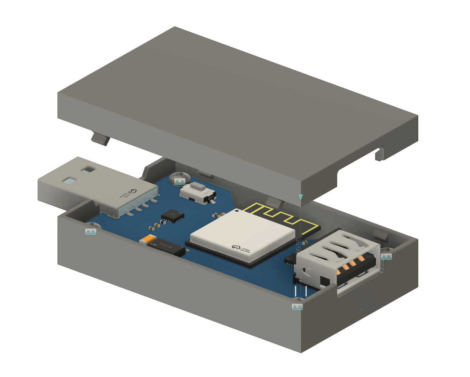

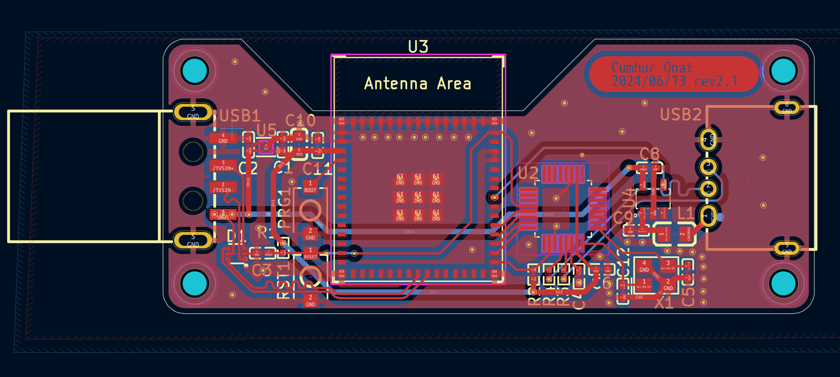

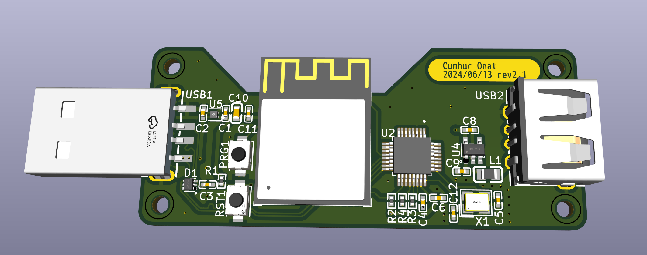

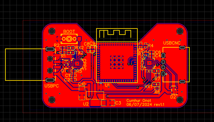

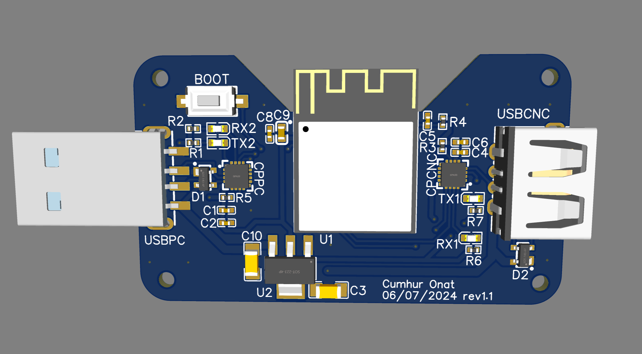

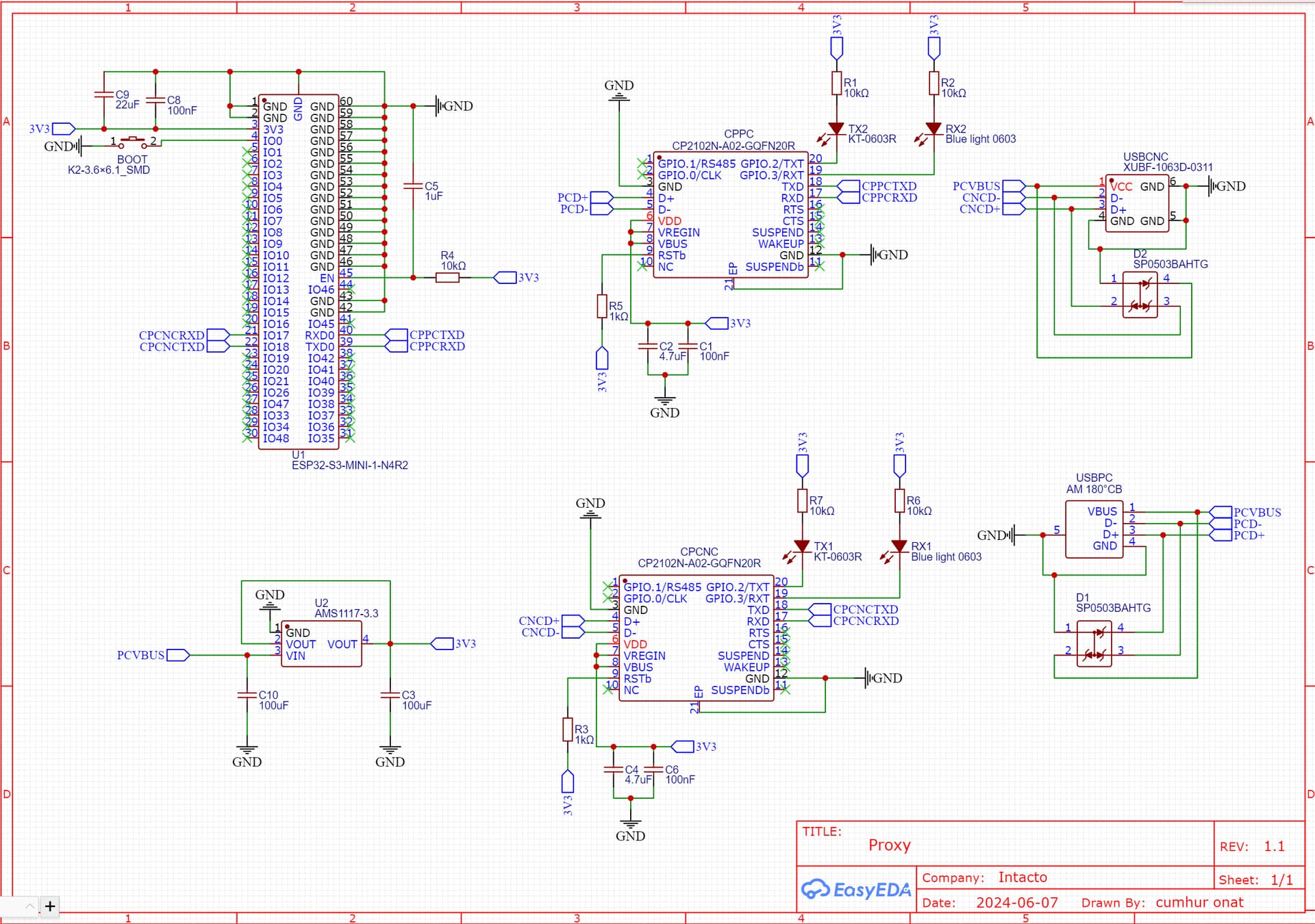

I made the first revision to the usb dongle side according to the feedbacks and created a 3d printed enclosure also.
The previous version of the pcb will arrive in 2-3 days and the new one is in production. I also ordered the following items for the pendant side:

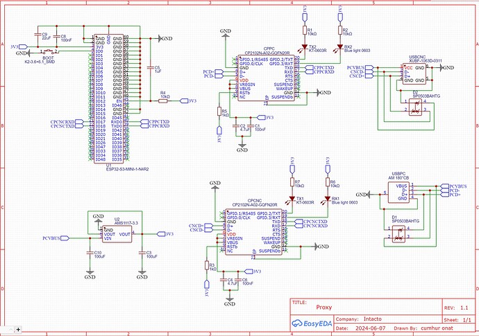

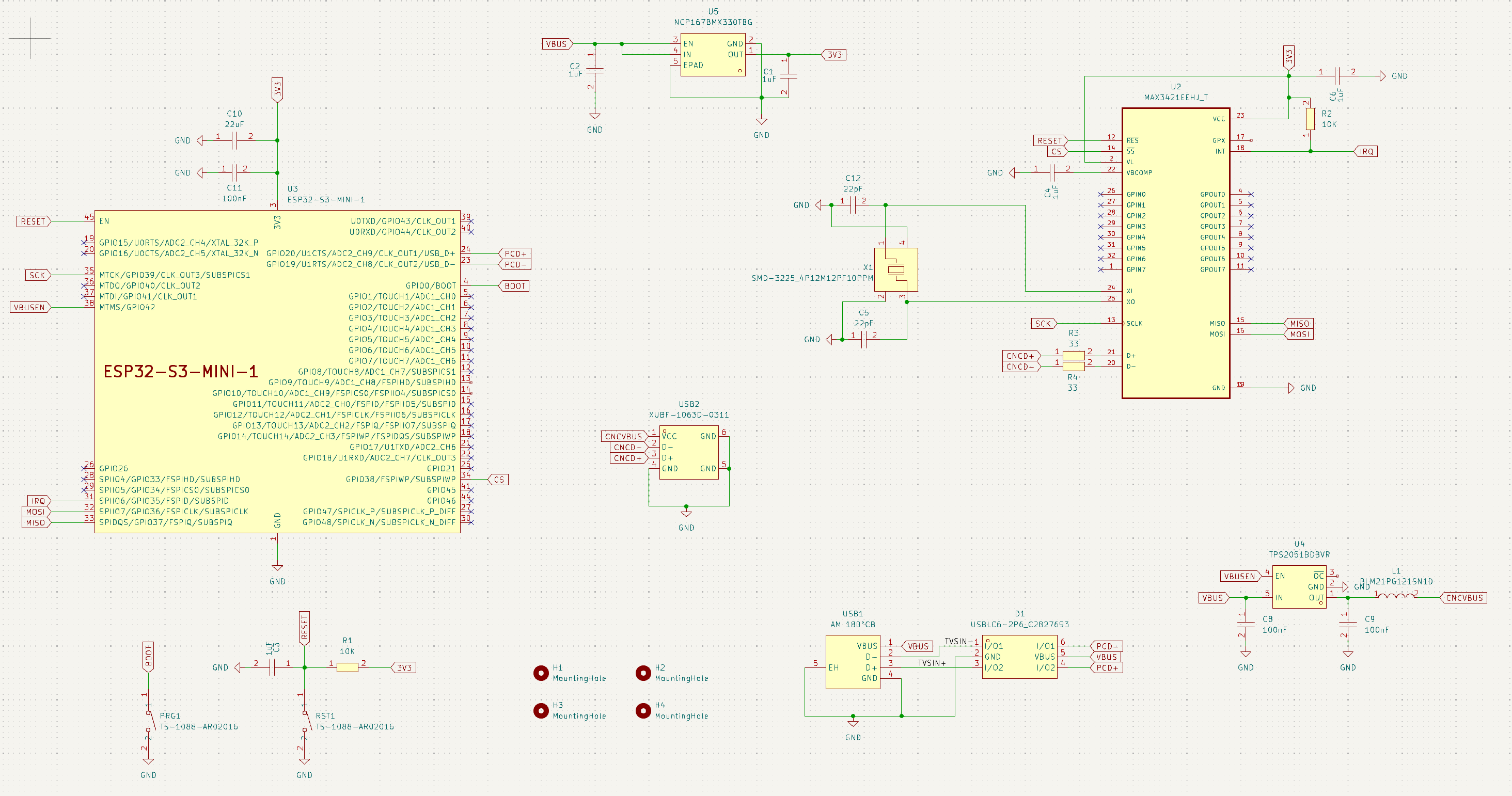

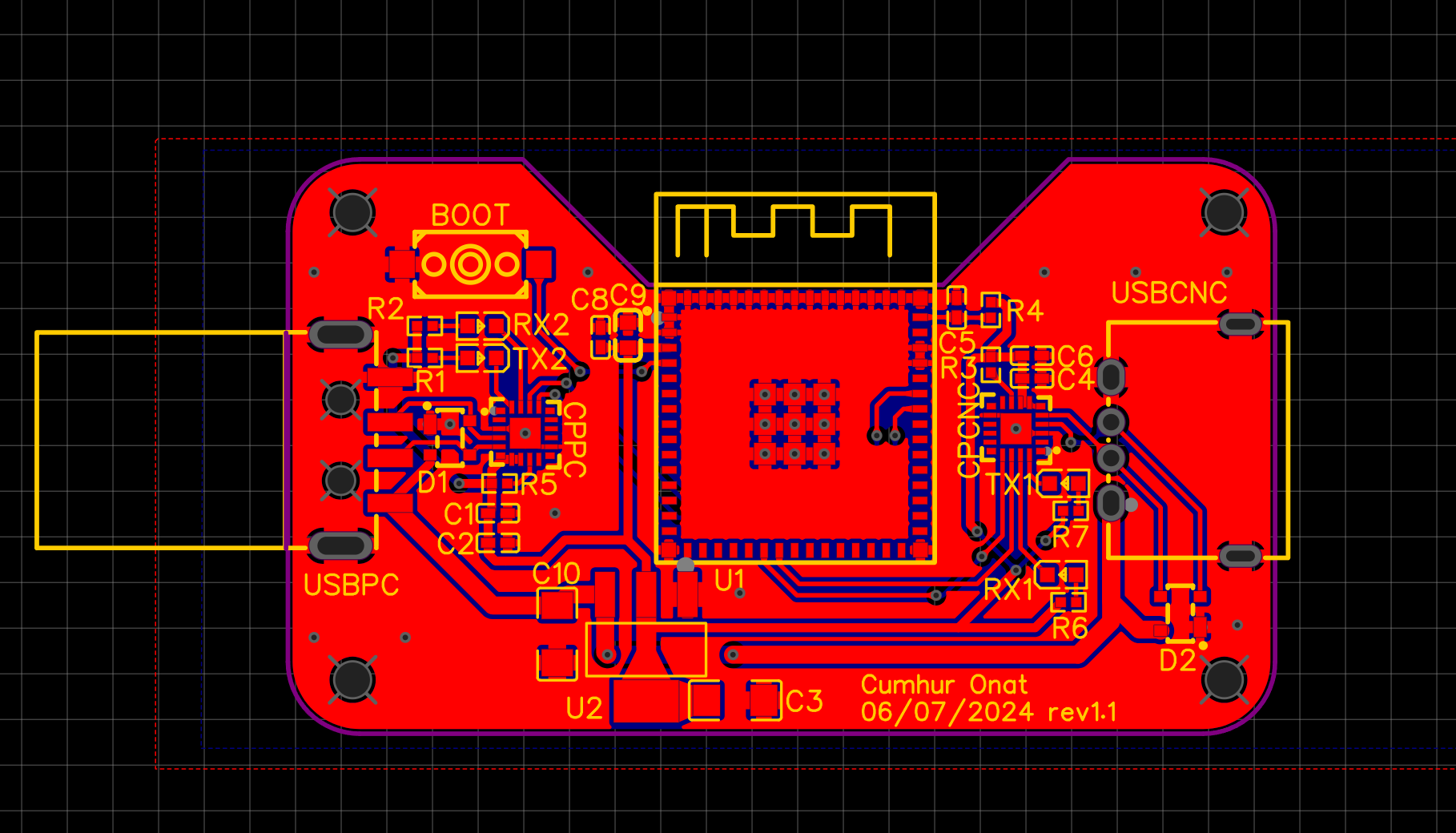

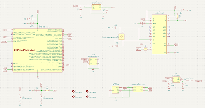

Let me give a quick update. It looks like I made some wrong assumptions. I received both the initial design and the updated one, but both of them are pretty useless at this point. There are two big issues:
  1. Cutcontrol picks the virtual serial com port by its USB VID (Vendor Identifier) and PID (Product Identifier) so for the pcb to work I had to override its factory default VID & PID with the same of the controller unit (0x16d0, 0x103e). But this means I have to create a new driver bundle for the cp2102n and get it certified by microsoft which will cost thousands of dollars.
  2. I was believing that the second cp2102n on the pcb could communicate with the controller unit over the usb line as they both will be using TTL over USB, but that’s not the case. The device that gets attached to the controller unit needs to communicate with it only with some special OS driver.
So, I designed the pcb from scratch. This time ESP32-s3 will handle the pc usb connection with it’s native USB support, the good part is it also supports CDC-ACM which means it doesn’t need any driver on windows 10 & above even if I override the VID & PID. For the controller usb connection side I’ve included a MAX3421 USB controller chip which supports both CDC-ACM, cp210x and some other usb devices. It’s currently being manifactured on jlcpcb.
I’m sure this could be done by using some software and readily available devices, but it’s a great oppportunity for me to get a better understanding about hardware & software aspects of a cnc machine.

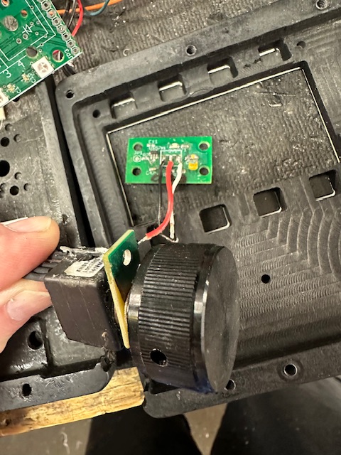

I made a little PCB with exposed copper to make contact with the barrel of this quadrature output part. A wire comes off the barrel PCB and goes to a QT1010 cap touch sensor. If you touch the aluminum knob the output turns on. In the software I did something to drag a knob on the PC gui screen.
On touching the knob:
Mouse move to screen XY to be on the PC GUI knob
Mouse down event
When moving the quad pot right by one count, move mouse right by 1. One encoder pulse is one mouse move increment ie pixel.
Move knob left, moves the mouse left.
On releasing the metal knob, mouse up event
This replicates a screen knob identically on a physical knob. You would have some divisor on the quad output counts to set the knob resolution to mouse ratio. Ie encodercount /5

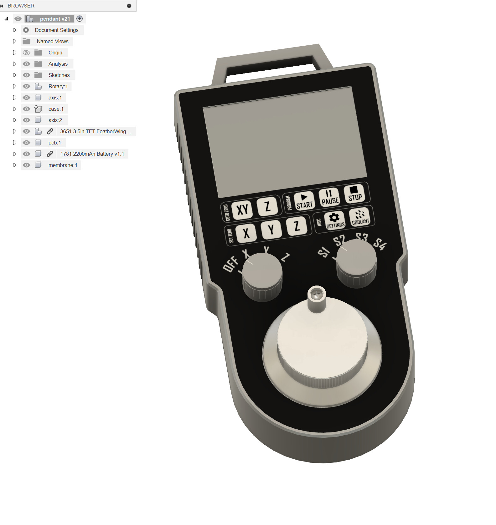

I started designing the pendant unit :slight_smile:
