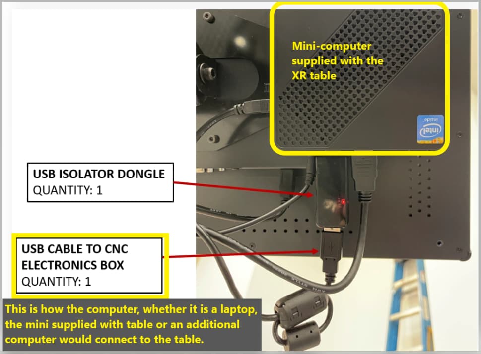

Why don’t you want to use the computer that already comes with the XR?

As for connection to the table:
