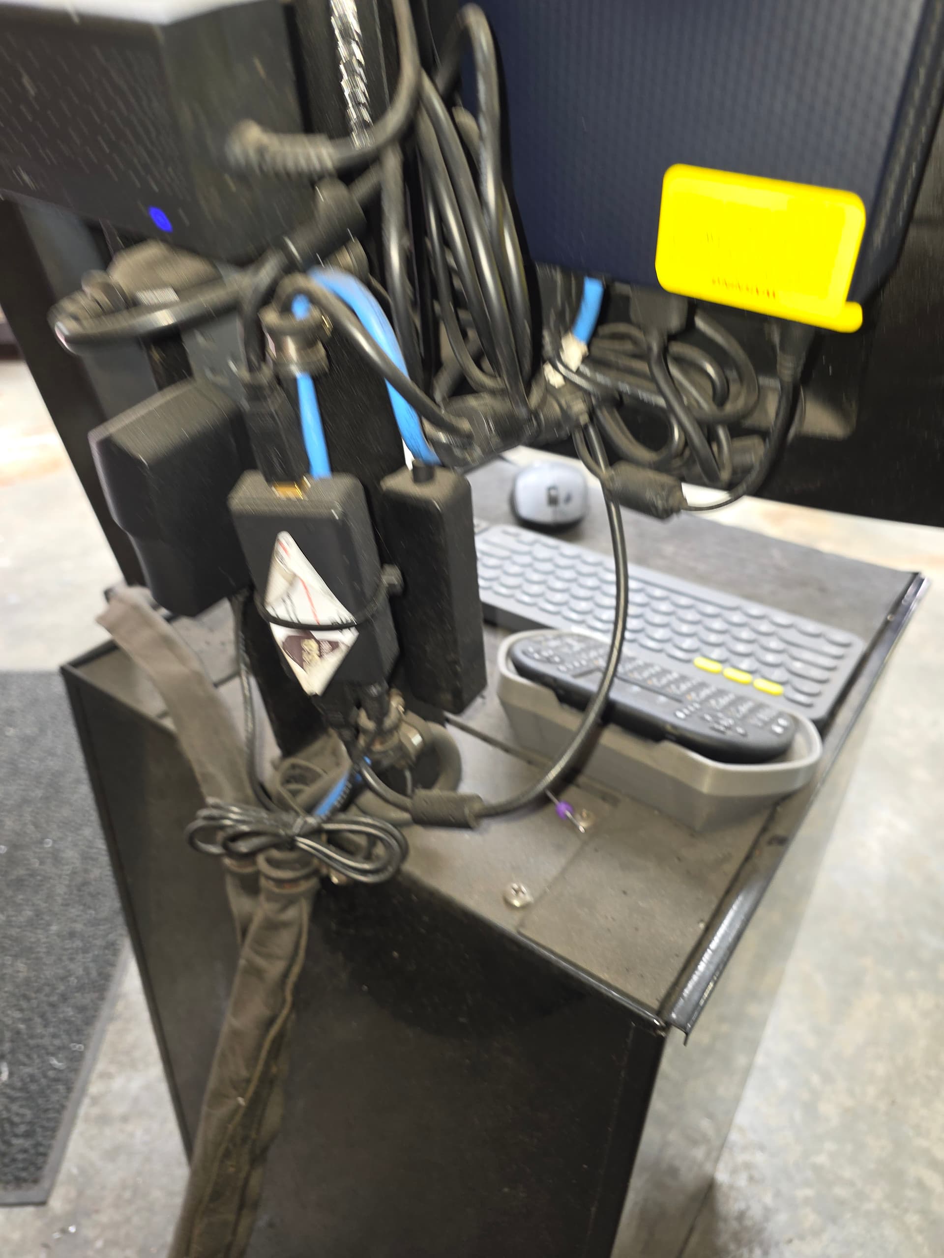

I mounted mine to the back of the touch screen. Although I don’t use the touchscreen, it will connect via cables just like any other computer.
Here is a picture of my setup. Now, I have a Pro, but nothing will change.

Post a picture of the XR’s computer.

I’m impressed, but also confused. What is the electronics box on top, and what are the ones you tie wrapped down below to the post? I am not familiar with the Pro model. Last, did you build this work station to operate remotely away from your Pro, away from the plasma table itself? Hope I’m not asking too many dumb questions, my background is machine shop and welding, and other than my MacBook Pro computer gadgets are new to me.
Yes, I built that toolbox with the computer mounted to it. The wires on the back are a power strip mounted to the back of the monitor mount. The other box is a USB isolator. The small item on the side is a USB extension with several additional ports.
