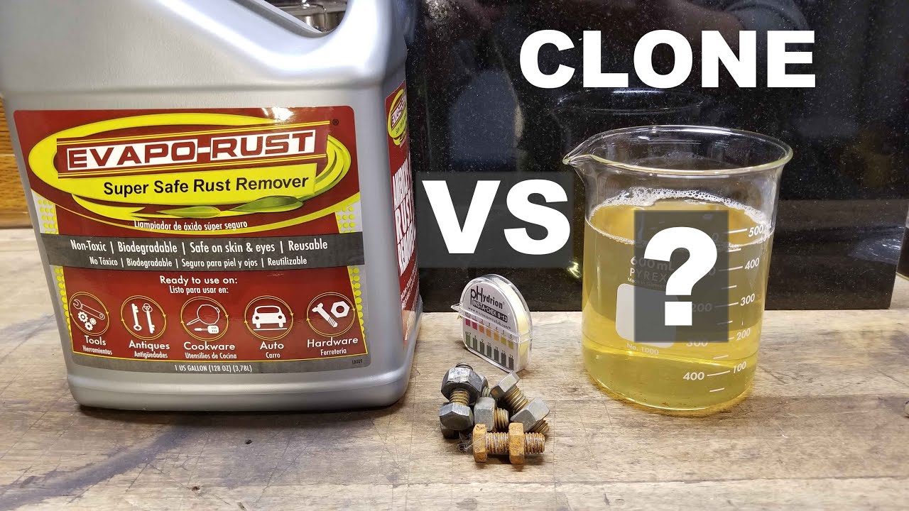

Yeah, I bought some granular citrus 2 months ago and have not mixed any up yet. I’m gonna use up my vinegar and then try this type of solution. I bought “Spicey World” brand off Amazon.
I gave the citric acid a go and quickly went back to vinegar.
What I seen may have been a mixture issue. It works great and quick.
Sometimes when I am doing things I will bath them until I am ready to finish them. Sometimes it can be close to a week.
What I noticed was a difficult to remove crust would settle and form on the metal. I usually have the parts suspended in the bath Not laying on the bottom.
You may want to what you mixture ratio.
This was the citrus mix? Why do you think mixture was the problem?
I began to think maybe I had it mixed to strong. The citric acid didn’t stay suspended in the water.
Best I can remember I mix a pound to pound and a half to 5 gallons of water…
It wasn’t horrible to get off just time. Then had to make sure no residue was left before powder.

This is why I use citric acid. Look at ElementalMaker’s video about EDTA as well.
Hey! I have a 3rd gen taco!
I have not tried your citric acid but you are right, that is rather impressive.
When you rinse off the citric acid, do you have a situation of the flash rust that happens with the vinegar?
Yea, if you don’t neutralize it quickly you’ll get some flash oxides. I keep either a water bath or water/baking soda bath (more ideal) nearby to help neutralize the acid.
I’m going to try the chelating mixture next time I do a batch of parts (100g citric to 40g Na2CO3 per L of H2o). I’ve played with EDTA 4Na, but if memory serves, it’s pretty slow.
