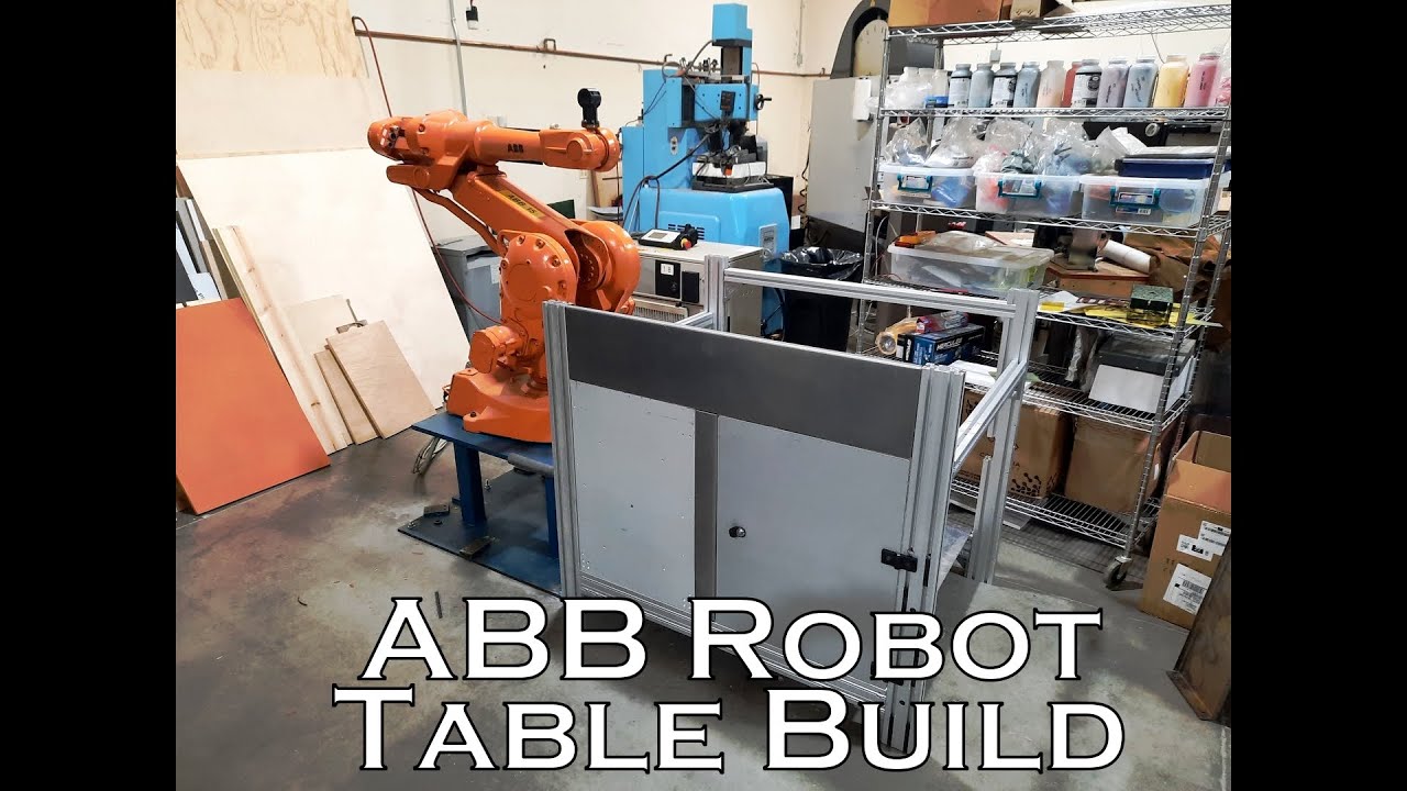

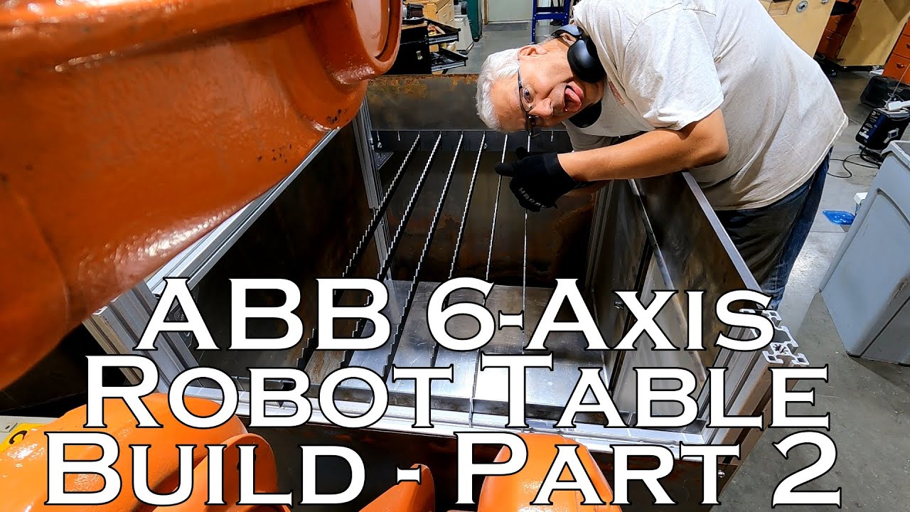

@holla2040 That’s an awesome project! Great job!
Thanks, glad you liked it.
Everyday is like Christmas for you isn’t it? :rofl:
So is ABB the brand of robot?
