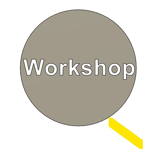

Yes, 3M tape is good stuff and if doing something small like letters holding them onto a backer should be fine. Here is 5-minute example.
below is example of say sign you want to make. you could use 3M tape to put the letters on it. I will always say the trick is in designs.
This is how i would cut it out and put on backer…
You see this is how i would line up my letters to be baciscally perfect without spending hours lining them up. It’s all in the design. You don’t always need to cut the full shape to line things up.
