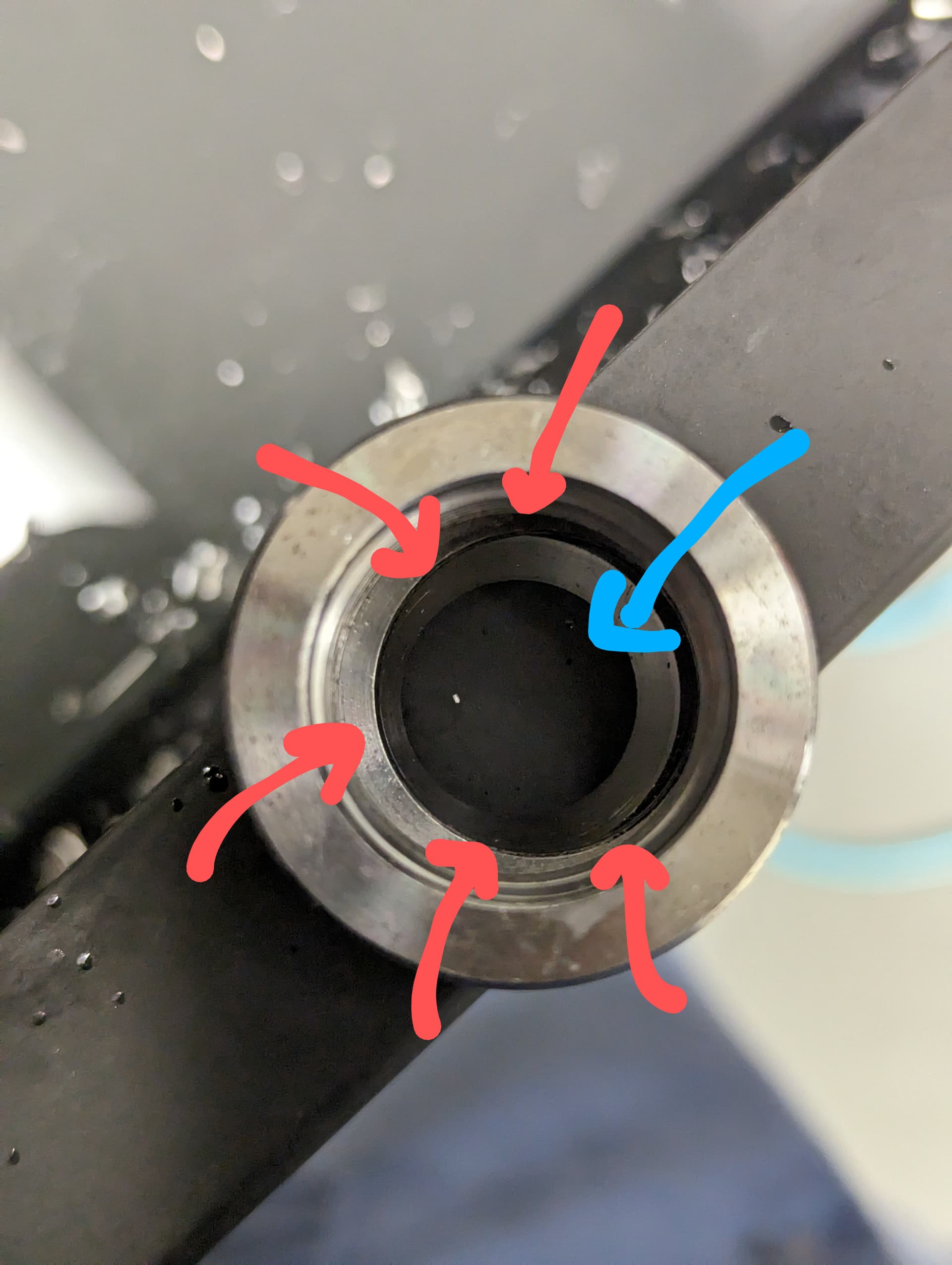

I’m pretty sure I’ve found the issue. Seems to be collet run out with the ER20 1/4" collet from Langmuir. I am using the collet nut and collets from Langmuir. Im indicating .0085" of runout when indicating on the shank of the end mill when mounted in the collet. Indicating on the spindle reads basically zero. So I guess I need to grab some better ER collets and see if that solves the problem. I’m also wondering if this collet nut is normal? (See below) this is the included one with the machine but there is a portion of it (marked in red) that is not concentric with the axis of rotation, of opening of the collet nut (marked in blue).

Evan, that eccentric profile you are seeing in the collet nut is the retaining feature of ER collets. If you look at the conical face below that feature, that is where the load of the nut is applied to the collet.

with ER collet systems, quite often people will mistakenly just drop the collet into the nut and put it on the spindle, failing to snap it into the retaining feature. Doing so WILL result in a TON of runout as well as issues with tool retention.
