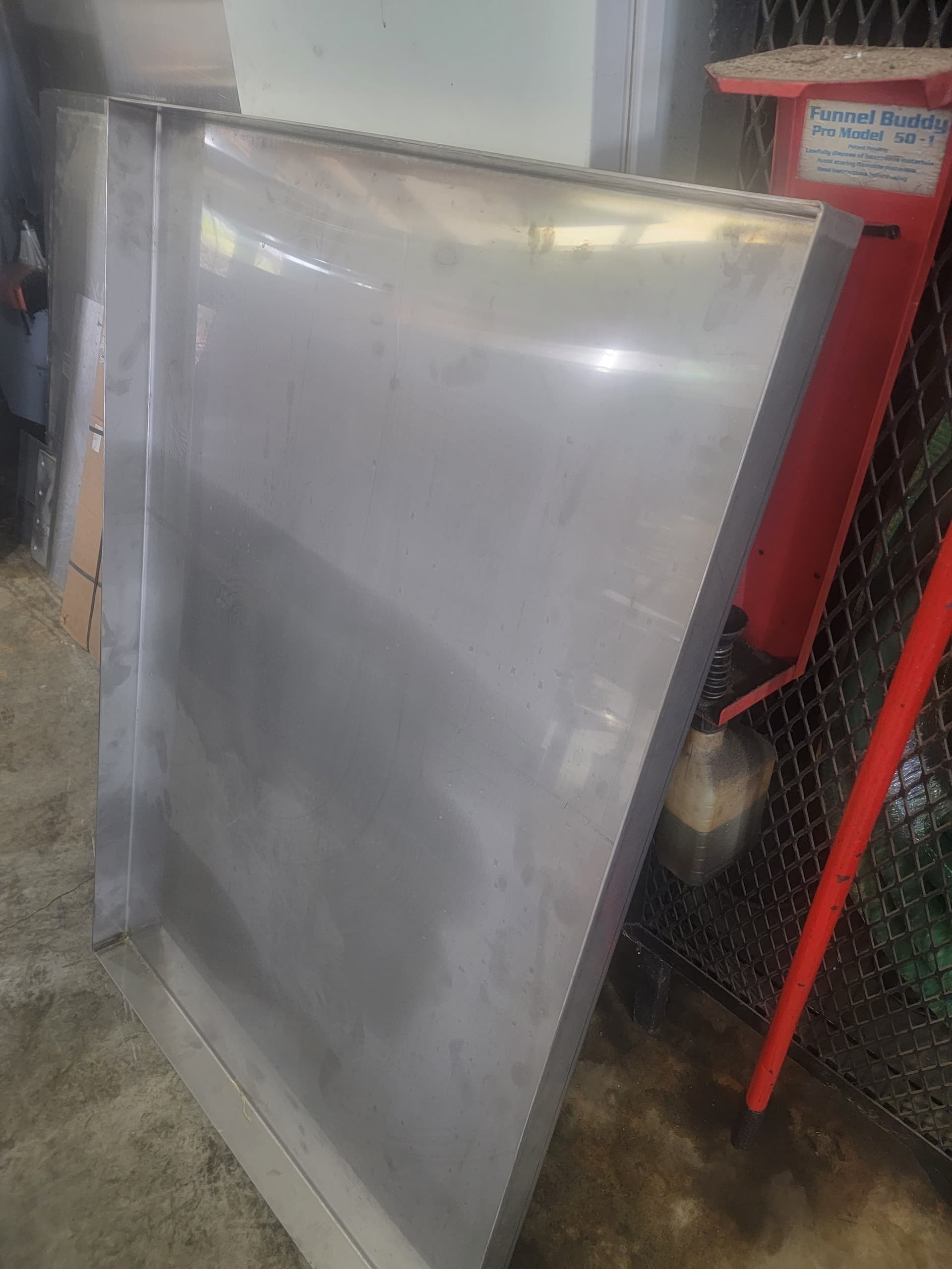

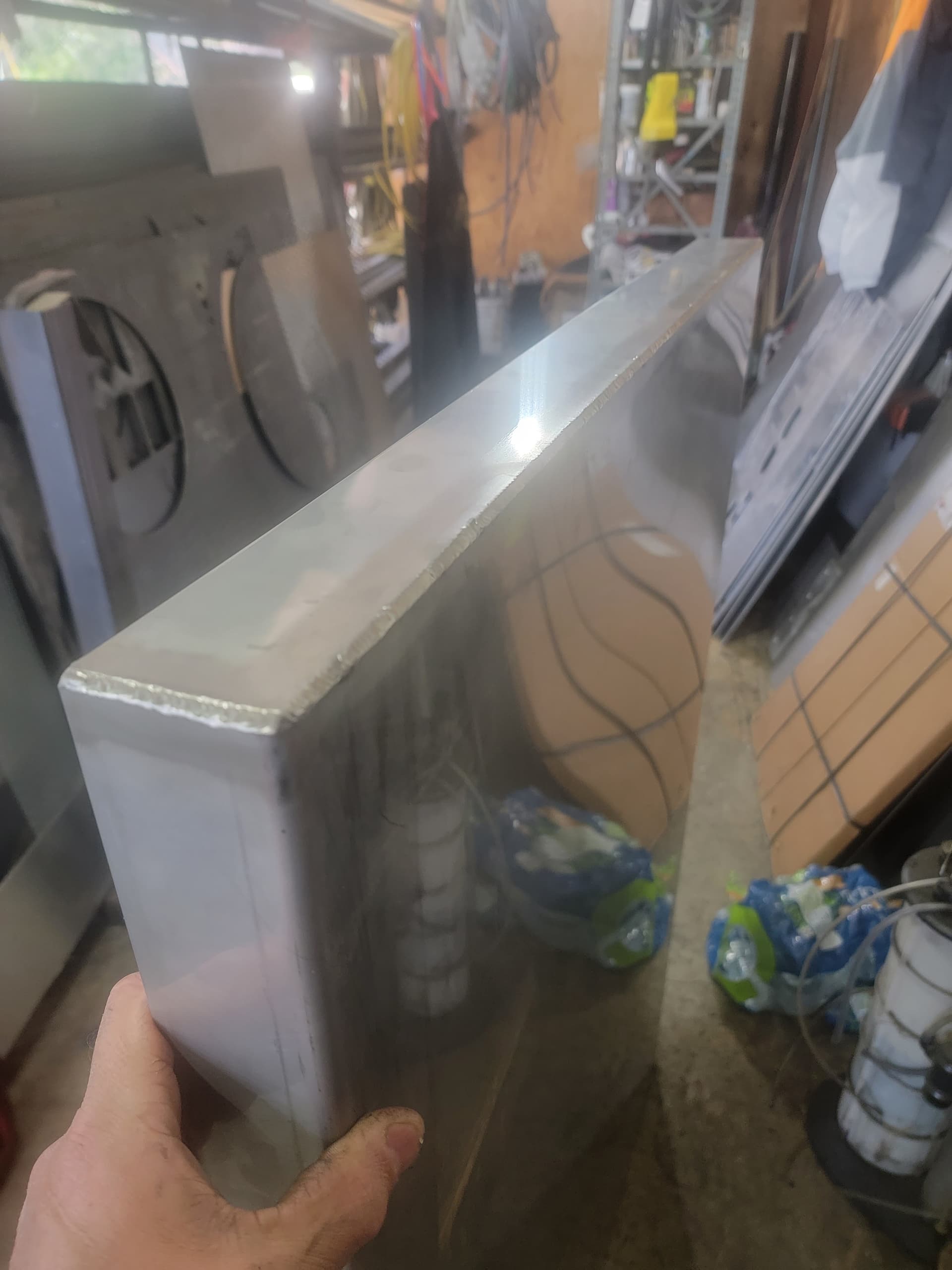

I followed in the footsteps of BD, making my own single volume pan from 16ga stainless with a single centralized drain. Made the side flanges as tall as permissible without raising the Y axis. I don’t do much work out in my garage during the blazing summers here in SE TX (because health things), so I wanted a way to reliably and quickly drain and refill my table for cleaning (and anti-sludge/algae/grossness reasons).
I’ve posted this in a couple different threads, but my reservoir / filter / pump system:

It seems as soon as I replaced my slats with the v type pointed slats, I have had issues with the seam. All the sealant is blowing out and the seam has a 1/4” gap in one area where most of my cutting is done. Headed to my local fab shop next week to get a 14 ga one piece steel tray made!
2.25 inches deep if you want to make it the same size. Any deeper, it will hit the Y-axis trolleys.
I made mine out of 11 ga stainless years ago.
Oversize it on length and width. At least 42 inches front to back. Cuts down on the splashout.
