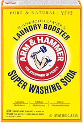

Is this the ANH borax you guys are talking about?
That’s what I use.
I get it at the supermarket though.
I’m just crazy I guess. Since its only 5 gal or so. I just drain and clean the table after each use. It gives me a chance to inspect everything and ensure I’m ready the next time. It takes 10 min. I know that’s not a routine everyone will want to do. But just throwing out there that none of these things are issues when there’s nothing sitting in the table.
That isnt borax might react with the zinc plating
Sorry, you’re right. A&H Washing Soda. :slightly_smiling_face:
I use that in my electrolysis tank and it stained some nearby parts I have clear zinc on. Eventually the plating just came off.
