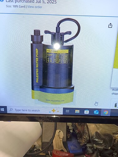

I finally got one from Amazon it was $75 and it flows $3, 000 gallons per hour it plugs in the only thing is it doesn’t have a unlock switch so you have to modify your original one and put a plug in on it so when you can use that if you don’t have the relay but apart from that it works flawlessly
This is the one I have from Amazon it works perfect and everything from your old pump screws straight to it no problems the only thing is it does not have the switch to turn on and off on the lead but if you have the relay for the mr1 then it is not a problem
did your original one fail? I barely use my machine and might have to replace mine already…
Yes it did in the biggest way possible. I asked the guys if they had ever heard of this and the answer was no so I bought a new one and all is well
