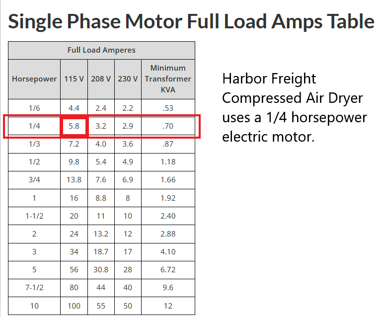

Do the HF dryers run off of 110v? What kind of current do they pull?
110 outlet, and you have to supply your own cord.
Haven’t put a clamp meter to it but it runs fine off a circuit I originally dedicated to my air compressor.
Only asking because my garage is quite limited on the available outlets, and I already have the compressor, lights, and my deep freezer on that circuit.
Guess I may need to drop some more outlets on a new breaker if I go this route.

I could not find the plate on mine. It might be hidden inside. On the outside and the literature it says it uses a 1/4 horse motor.
So it is really not pulling much amperage: No more than 6 amps when it starts.

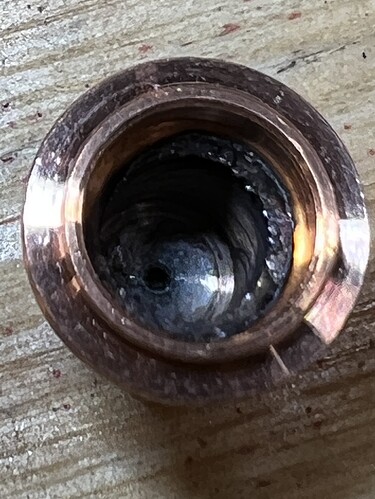

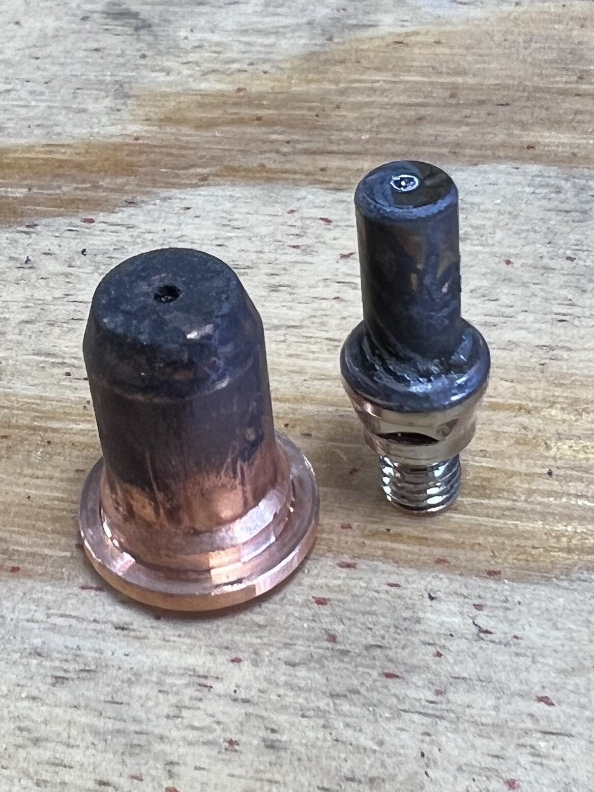

Here are my consumables after 300 pierces
I would say not great. I still see some swirling on the electrode. What do you think?
What do your desiccant beads look like?
And not just the indicator when you pull apart the actual container and dump the beads out , what do they look like?

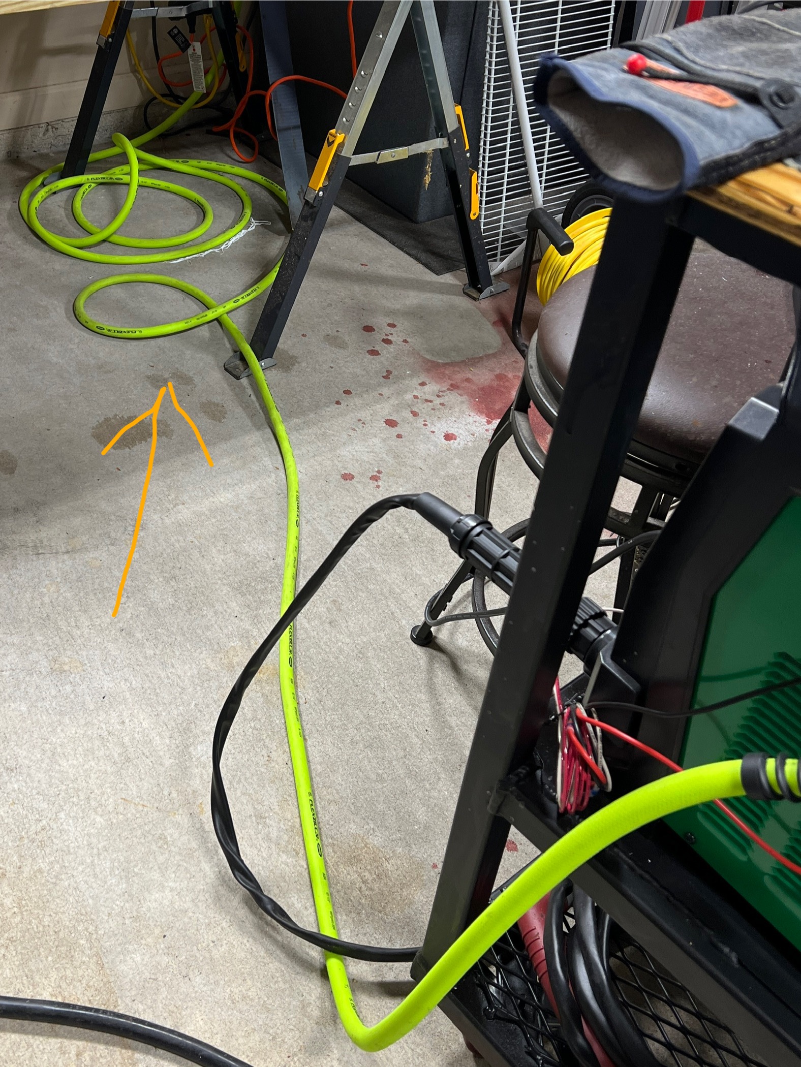

Here is the line from the filter to the plasma. This is 1/2ID hose. Probably 20ft. Could that be it?
It was 15sec for about half of those 300 pierces. I read one of the other threads talking about the post flow and changed the setting. I wish the Everlast wouldn’t default to 10sec. I switch my 50amp extension cord between my welder and my plasma fairly often and i forget that setting.
Sheesh, that’s really bad.
Whereabouts are you located? You and I are running the same air dryer but my compressor is significantly smaller and less powerful (110v and only 25 gallon).
As far as the cutting tip and electrode goes. The cutting tip don’t look that bad. The blackish on the out side is from getting moisture on it and its corrosion. Its not over heating as there is still a lot of clean copper color. Now the electrode and the inside of the cutting tip, that is caused by moisture. I don’t know were its coming from but you are getting a lot. The electrode as far as wear looks good and its not over heating as there is still a lot of shinny chrome on the back side and threads.
