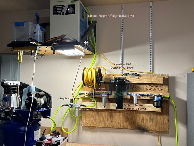

Just to put this to bed, I’m posting what I did to my shop air drying system.
Upgrades:
  1. 1/2"npt air regulator
  2. 2qty 1/2" water traps
  3. Harbor Freight refridgerated air dryer
  4. Speedaire PA-1 desiccant air dryer
  5. one shitty amazon desiccant air dryer (I returned the other one I had as it leaked like a soaker hose)
  6. Motorguard M-60 air filter
    I’ve had to fiddle with the controls of the HF air dryer to get the air temp down. And I went ahead and took the water trap out of it and cleaned it. There wasn’t a lot of water in it yet, but with my luck it would have been a problem. It drains pretty well when I fill it with water.
    all told it is about a $1,200 upgrade to the shop. I’ve disgarded all of the lines I was previously using and went with pex on the wall and a 1/2"ID hose to the plasma cutter where it goes to a 1/4"npt fitting (I may change that out to a 3/8" fitting)
Thank you for everyone pitching with with suggestions and advice. Hopefully smooth cutting from here. My plasma works!!
You know there is a moisture trap in that refrigerated dryer that needs to be emptied every two hours of running???
No. I am just kidding. Looks very good.
