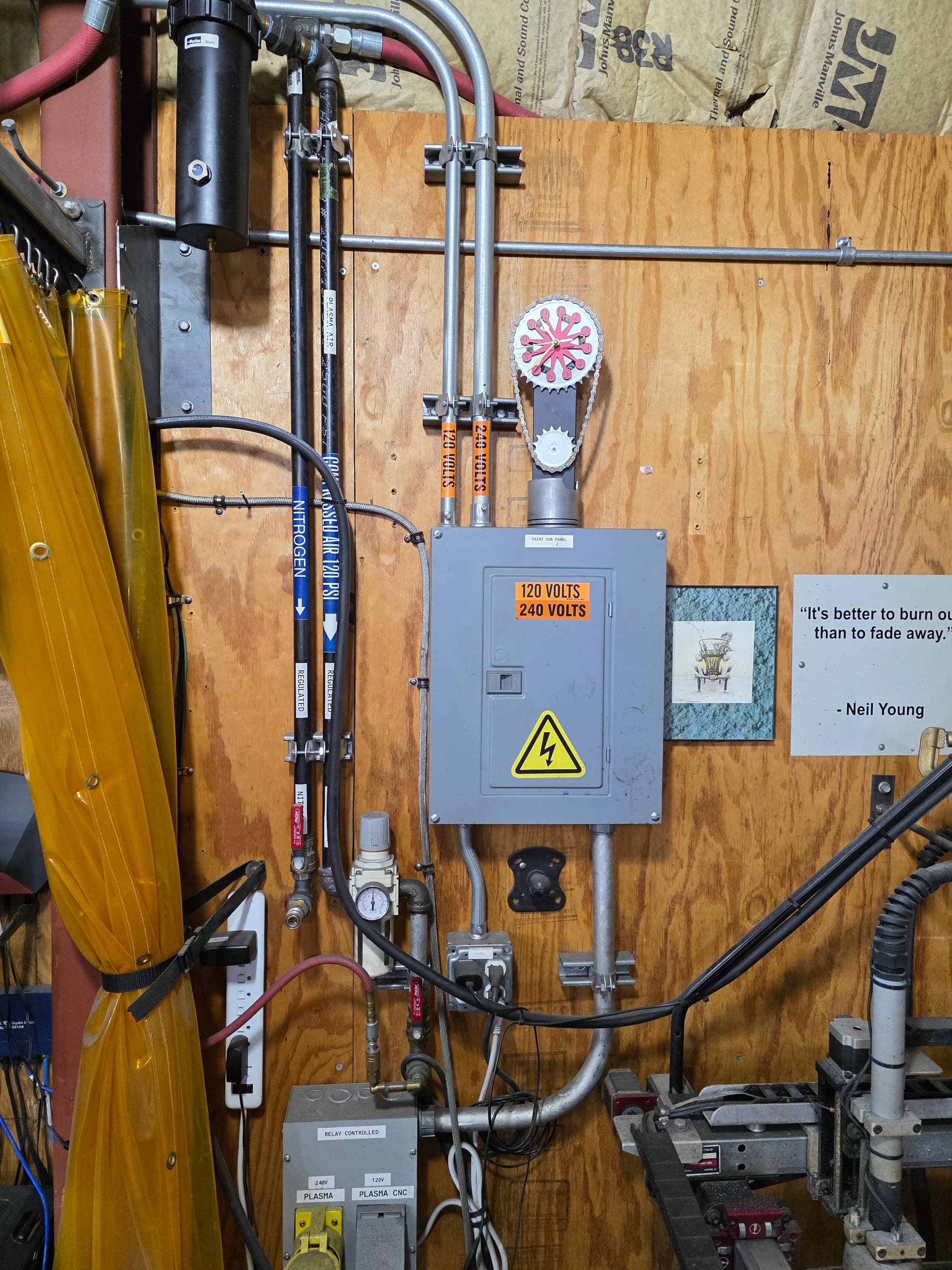

This “First Water Trap” is not likely to catch anything but it is okay that it is here. Some say it needs to be a “minimum of 20 feet of air line away from the compressor” to give the air a chance to cool a bit. That being said, I have six water traps in my set-up and have not seen any moisture in any of them: I am not sure what that means!

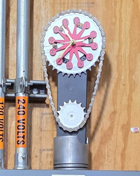

BigDaddy, is that your clock?
what about the air from the compressor to the refrigerated air dryer . what diameter and size is that hose ?
1/2" ID Same hose. I just cut it and put connections on it to make jumpers.

Yes, that is my project from four years ago: Mercury 200 piston. The chain turns, but it drains the battery within an hour or so.Now its just a clock…
