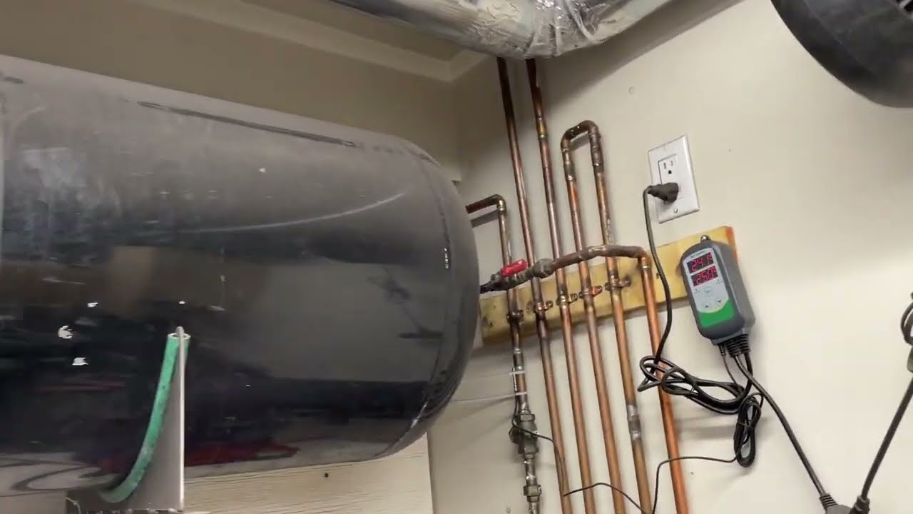

for those that have not seen it…here is my drying system.
I run a Everlast 62i and get easily get over 1250 pierces on 14g with this set-up…
I live in Ottawa Canada where temps and humidity are all over the place…

Compressor-> regulator->optional passive or active heat exchanger( or 20 ft of pipe)>coalescing filter> refrigerated air dryer- coalescing filter>optional storage tank>desiccant >Motorguard filter->inlet pressure gauge>plasma
This is the layout I would go with
