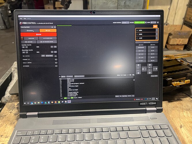

I can no longer see the tool path and visualizer in FireControl. It was working just a week or so ago. I have not changed anything, nor made any updates. I am running the Crossfire Pro with version 21.1.1.5. It is all of the nc programs that are doing it now, not just the new ones that I have recently created. The visualizer is turned on, but nothing is showing in that portion of the screen.

I though of the same possibility. I have zoomed in and zoomed out, too. Nothing. I don’t even have the crosshairs that show where the torch head is. I am also not able to choose the origin point. That one is a real pain.
Is that a screen shot taken while the program is running?

There is a “compatibility version” of 21.1.5 that retains the limit switch function. I’m not sure this is the problem, since it was working before with the same video card. It looks like you have 6 other programs running in the background. Maybe they are taking up too much processing power on the video card.

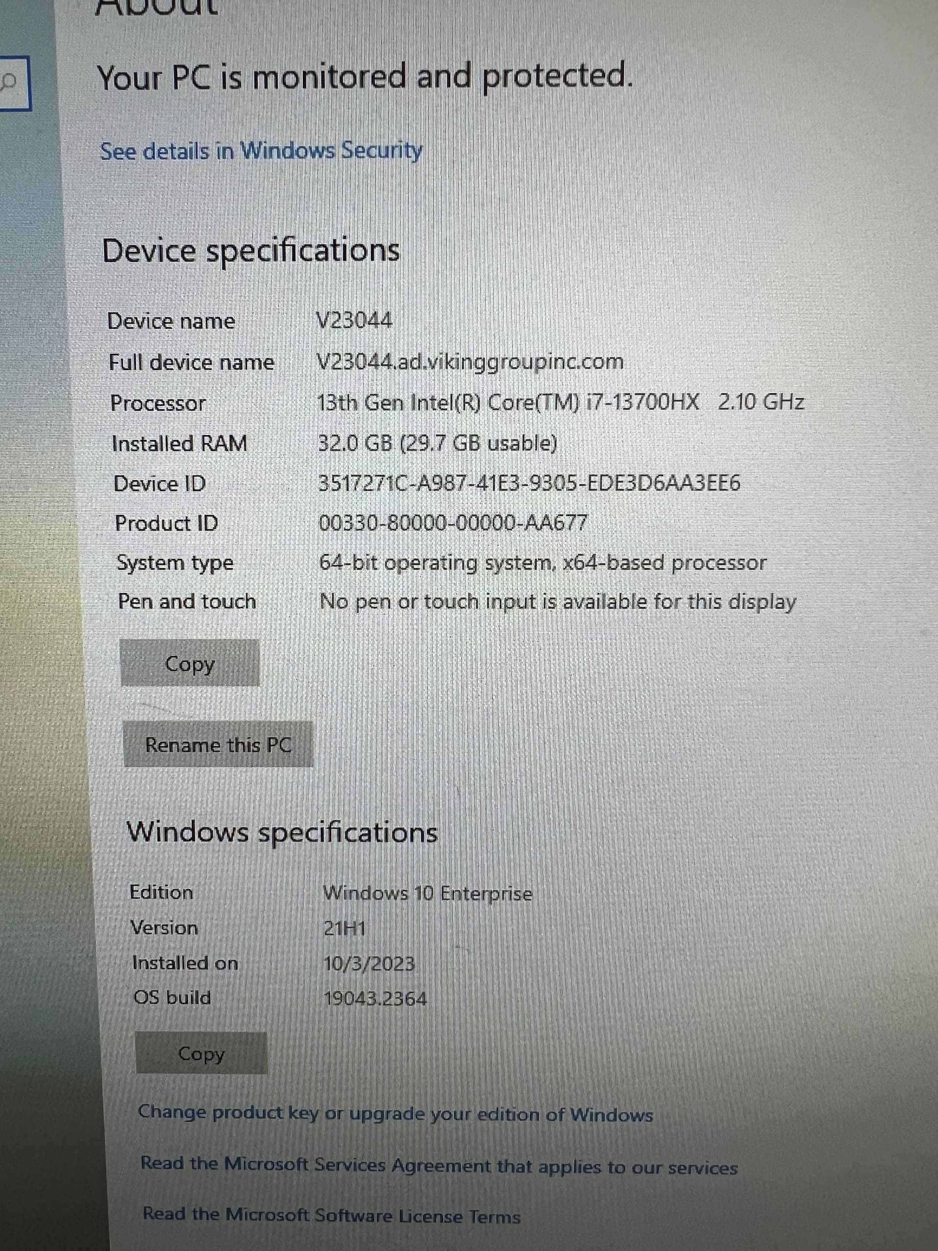

Is there a chance you have one of these CPU’s?
You may need to install one of the FireControl versions meant for slower graphic cards. Use the link supplied above by @langmuir-alex.
Note: This is not suggesting that you have a slow graphic card. But this version is much more stable for what you are experiencing.
