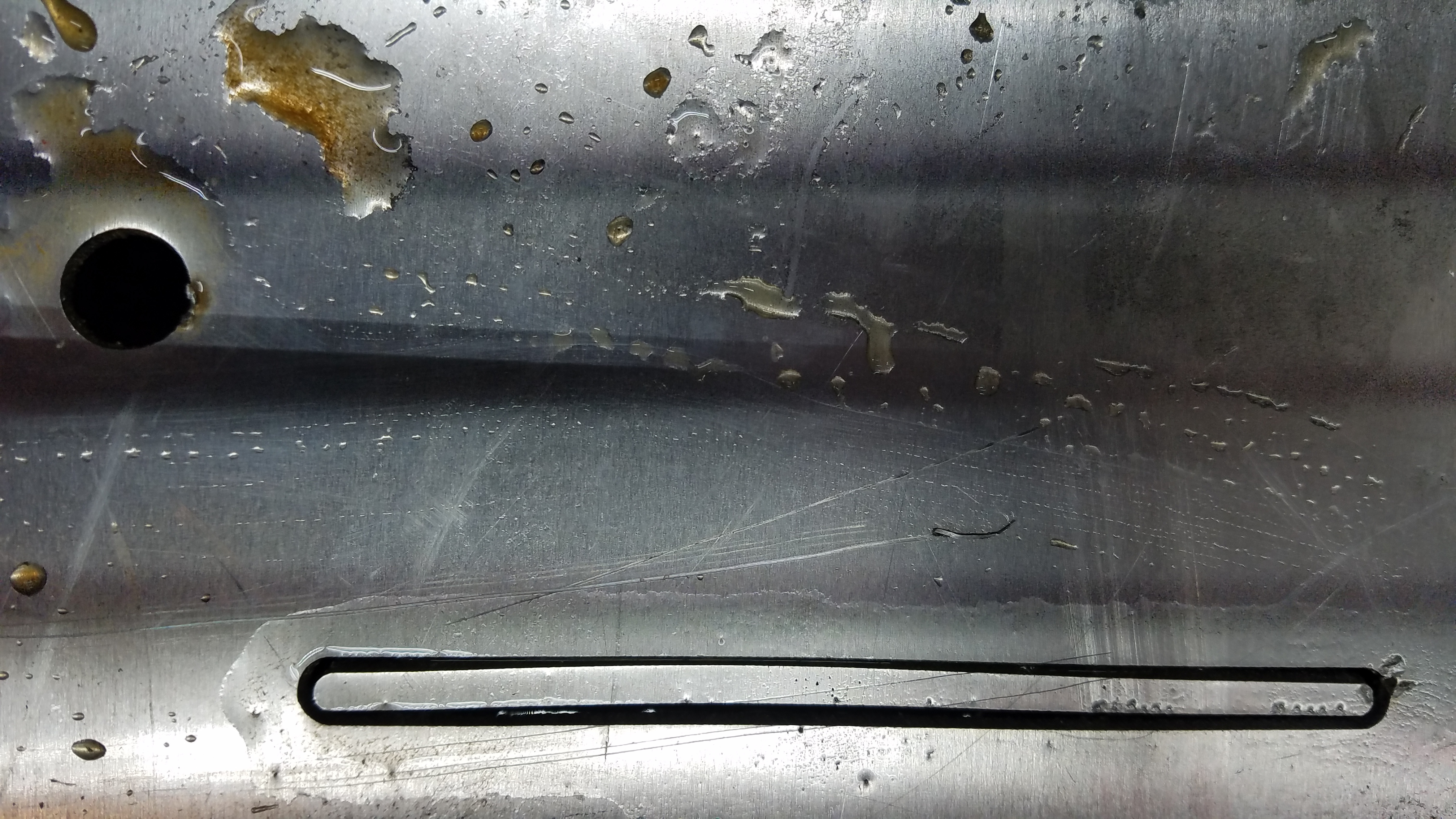

Vipercut 30i What is going wrong here?
I agree with @jimt - Looks like low pressure at the cutter. Try bumping it up at the compressor so that it’s about 75psi at the cutter. Air is what becomes the plasma flame. Too little and it’s not as hot & concentrated as a proper setting.
Also, how far from the dessicant is the cutter (hose length)? You want to have it dry as close as possible.
Just my 2 cents here, but I really don’t think air is the problem. It looks to me to be a lack of power going where it’s needed. Either a ground and/or ground cable issue, or something inside the torch. I had a similar issue with my Miller, and it ended up being a loose snap ring that held the wires to the electrode inside the torch handle, thus limiting the amps to the tip. Id look in the torch for loose parts, and then the ground side of it.
I have not read all the posts and maybe this has been mentioned. I would try attaching the ground directly to the plate your cutting. Only because i see your using plain water in your tank, you maybe losing ground threw your table due to rust on waster bars. In my opinion it definitely looks like the power is not being transferred to ground the cutting your seeing is the pilot arc only then it times out thus plasma shuts down.
Ground was an early thought. Assured grounded well. I just want to know why . :thinking:
At this point, if it was me, I would eliminate the crossfire and Mach by pulling out the plasma. Run the plasma by hand separate from everything else on some spare material. That would tell you for sure if it’s the plasma.

I believe that the torch is only firing on the pilot arc- would not be surprised if there is a loose ground connecition in the torch. I would definetely contact Razorweld. Send them these thread, they will likely know the issue immediately.

Think I finally got it. Did a test cut with once used consumables from my last cut because I’m tired of wasting them. Thank you all for your help hopefully I’m not jumping the gun here but I re-grounded directly to my material, double check and make sure my air was dry and clean, 100 PSI at compressor 75 at torch cuts look a lot better, actually extremely better. Thanks again for all your help good forum good people. Really happy there wasn’t something wrong with my torch.

The 45 chart can be used for the 30 by just either using the 30A and lower settings or using the higher power entries and extrapolating to the 30 - a setting for 45A would need the speed adjusted (slower) when using 30A instead. But at least all the 30A & lower powered settings should be directly useful.
