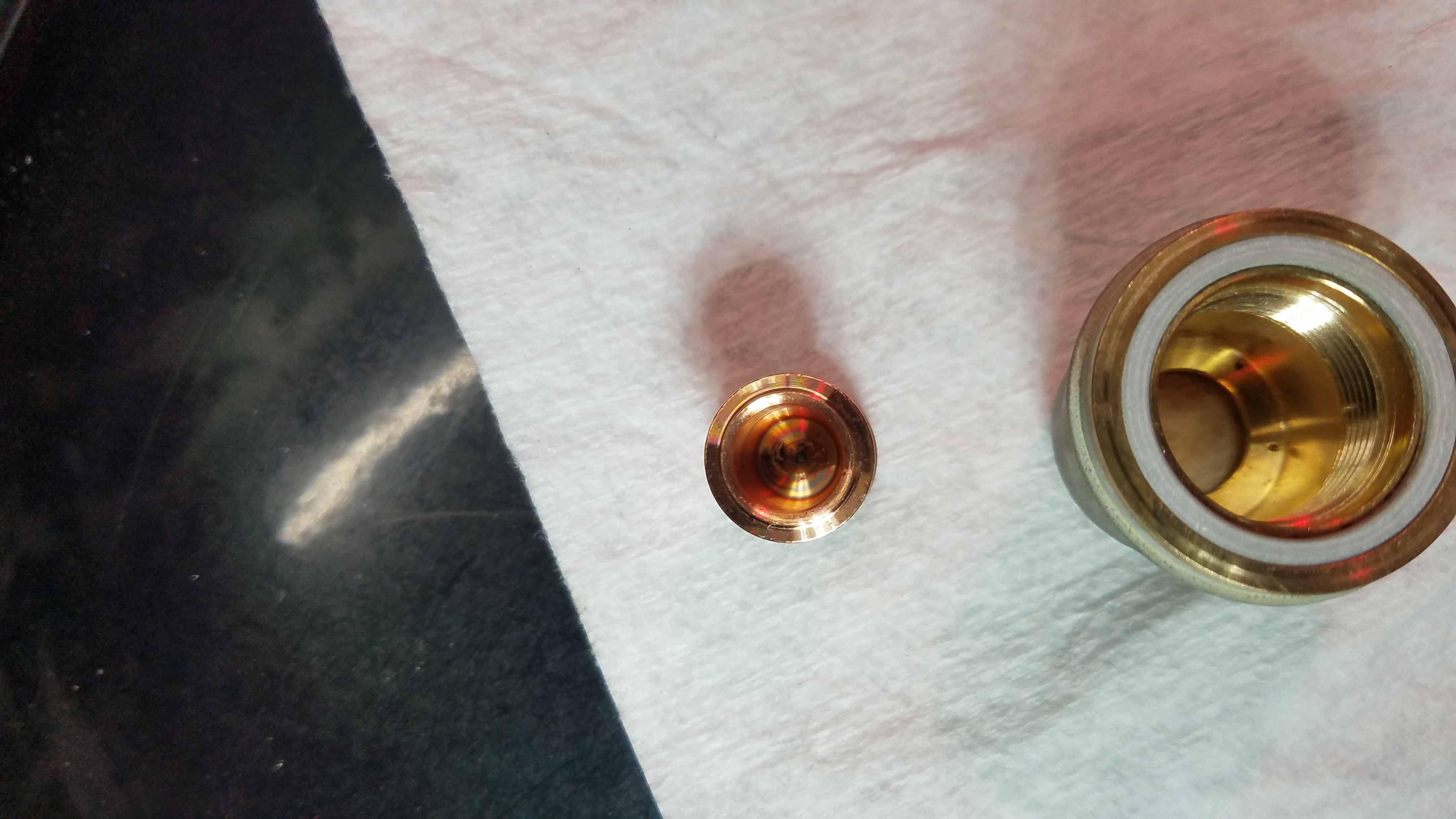

It certaintly looks like its only firing the pilot arc. have you reached out to Razorweld?
In your last pic is the 0.100 aluminium and 100 ipm sounds fast for 30 amps.

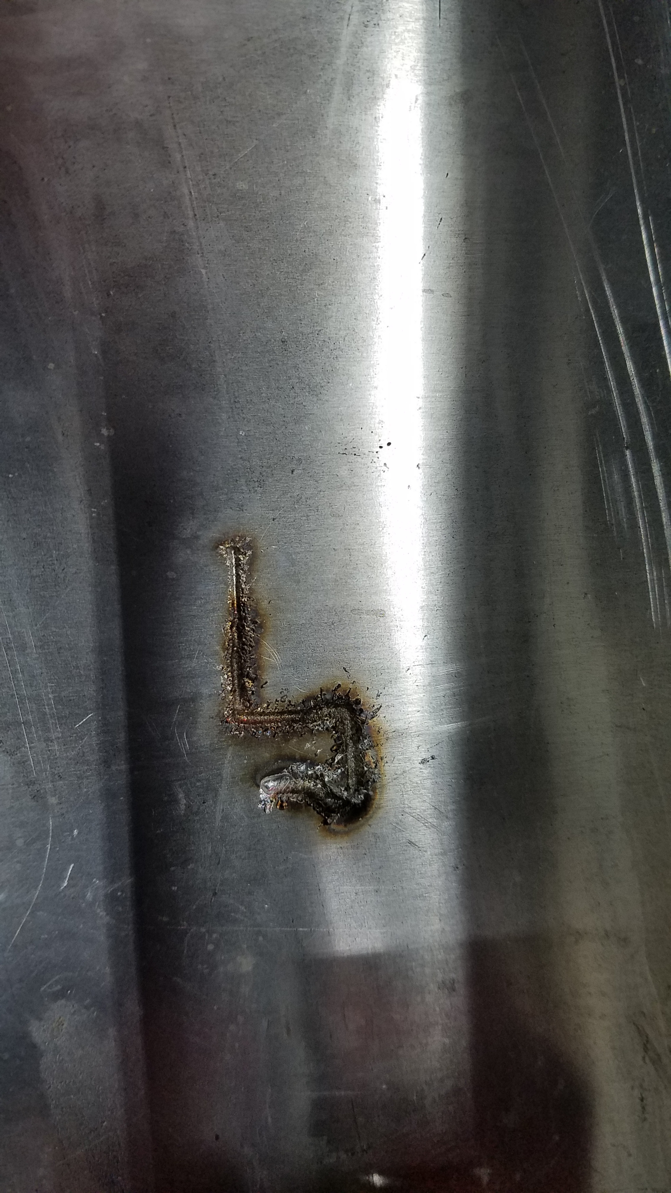

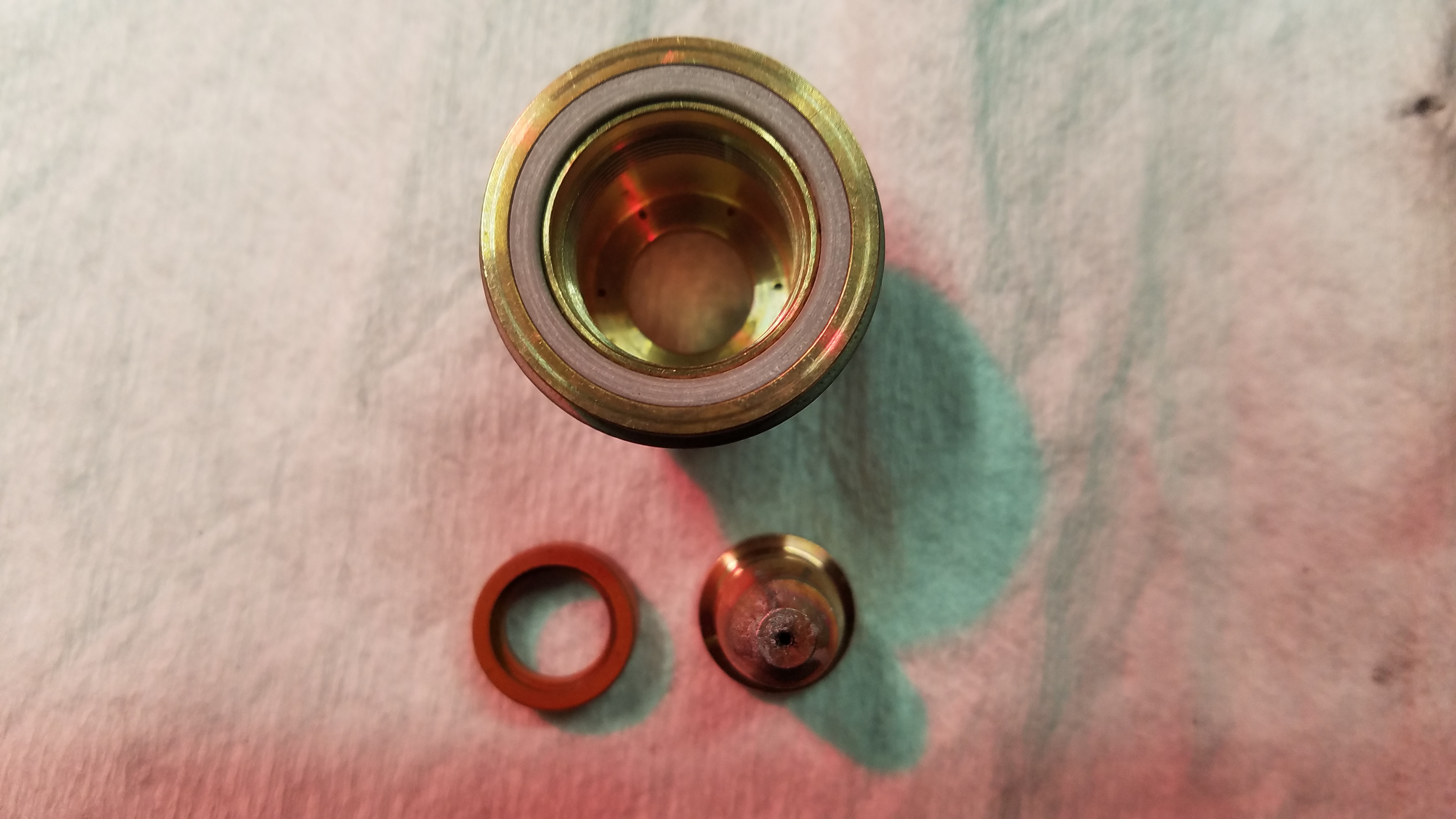

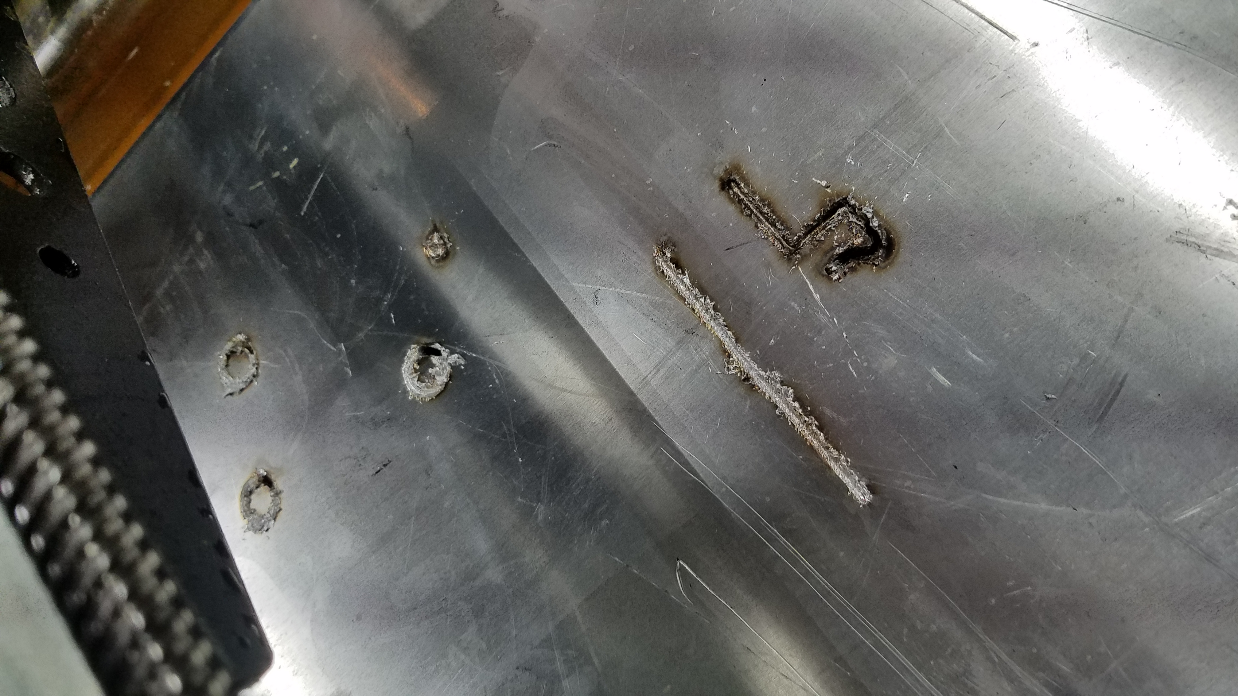

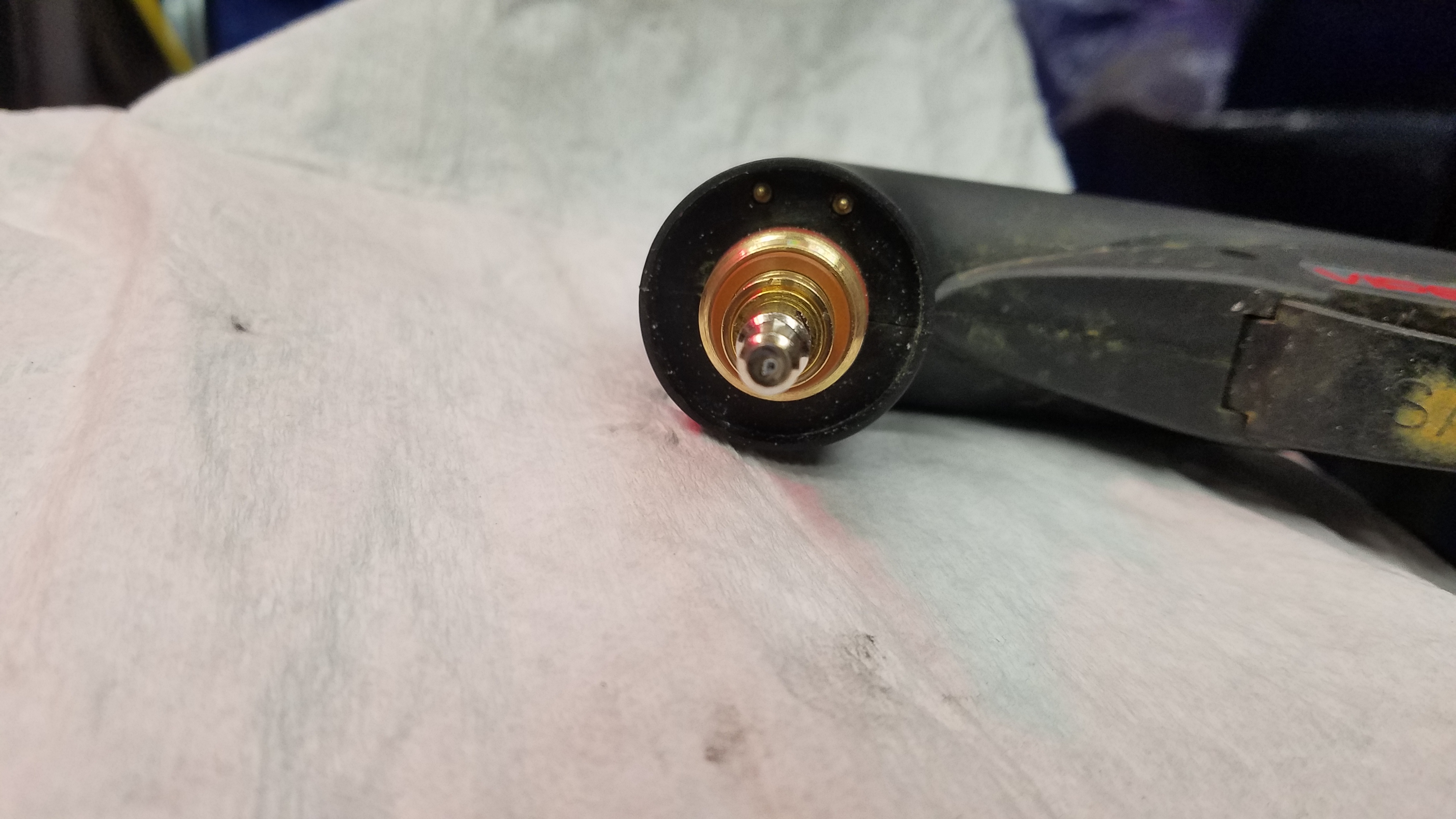

No I have not reached out to RazorWeld. I figured it was something stupid I was doing wrong… Still trying to figure out what is going on. It does this intermittently. I stopped Mach3 in the pic. Went back to zero. Left material in place. Put on another new tip, electrode, and swirl ring (getting expensive). Restarted Mach3. Back to zero. Restarted cycle from the beginning. This time it cut better, still some blowout. Cut all holes and slots decently. Cut all text except for a couple of the straight sides of some letters where it just etched. When it got to the parts continuous perimeter it cut it decent all the way around until it got about 3/4 of the way then etched the material for about 3" cut again for about another 6", etched again for about 3" then cut through to the end of the part. This part is 31"L x 6" W and is arched from one end to the other. It is not just happening with this part. Been having problems periodically for the past few weeks. What is weird is the first 20-30 things I cut turned out fairly well. Seems to be getting worse. I use to cut, finish, & ship out 10 of these a week by hand with a jigsaw, files, drill press, and sander, too much work so I bought this machine. This week I had 7 to ship one is going out and it’s Friday… Really need to get this figured out so I can pay for this thing. Thanks for your help in advance!!! Sorry for the novel…
How old is your material? Could be that you are not getting a good ground on the aluminum because of the oxide layer. Try sanding a small spot on the material and attach the ground clamp to that spot.
I am wondering about the cut speed if it is 0.100" with the VP30 at 100 IPM that sounds fast to me. I am thinking more like 50 IPM if you are 0.100" aluminium at 30 amps on a vipercut. but just guesstimating based on my Razorweld 45 experience and our limited cut spreadsheet.
Based on the excerpt below and assuming 0.100" and 30 amps I would try 50 IPM. The math isn’t perfect but I like the ball park. Also assuming clean dry air.

I also assume if you are not burning through your material that means more blow back and it would be much harder on your consumables. You are operating in a perpetual pierce.
Material is basically brand-new. It is touching the table everywhere I can see I also have a 25 pound cast iron weight on top of the material to hold it down. Air is dry, and you’re correct it is not cutting through in the place of it does not cut through there is a lot of dross on the top side telling me it’s blowing out.
Yeah I continue to have the same issue with mine with no better results. Been reading on other forums it’s the vipercut. You get what you pay for they say. New plasma is next on list. Thin stuff is fine but for 3/16 I use it’s terrible when it does cut.

Alsdo for now move you work clamp (ground) directly to the work piece.
