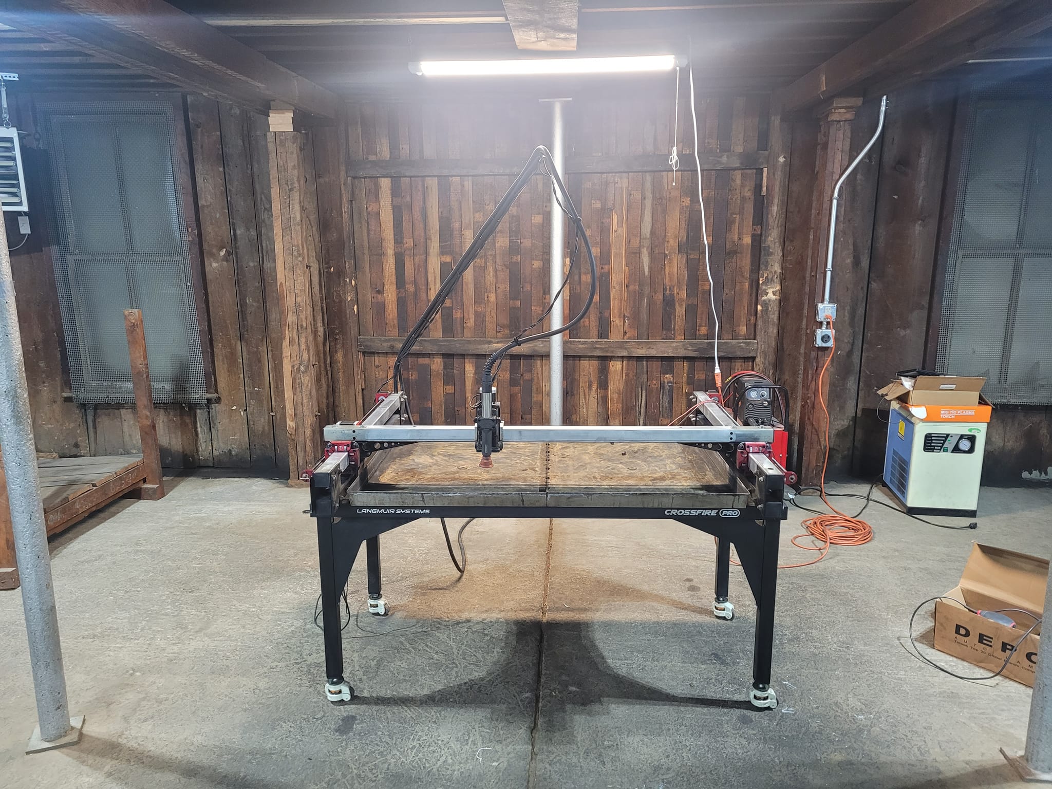

As I’m waiting for some finishing touches on my new work shop, (which includes tin on the wall behind the table), I’m trying to decide on the best solution for an exhaust/ ventilation setup. I do already have a Wen 3417 air filtration system, but I was thinking about a 14" exhaust fan and ducting to over my table, and eventually adding some sort of hood. I plan on doing welding and other fabricating in this work space, so may eventually want to do some more duct work to those areas. I also plan to build curtains around the cutting area to keep the smoke/ fumes isolated to that area. Looking for a more “budget friendly” option at the moment, that could potentially be upgraded in the future.
Since I live in western NY, I also am trying to avoid sucking all my heat out, and have also looked into fresh air exchangers, but not sure if that will work in my shop space (40’x30’x10’ish).
Link below is the fan I have in mind.
https://www.amazon.com/…/B001Q…/ref=ox_sc_act_title_1…
Thanks for any input! Any pictures would be helpful in visualizing what’s best for me.

Unfortunately since the two back windows are blocked off and the door is about 30 feet away from where I plan on having my table, I think some solution out the back wall is my only option at the moment.

I think i’ve decided to section off and area around my table for the time being and building some sort of down draft system around my table to vent outside. I’m hoping the sectioned off area will help keep the heat in the rest of shop and confine the fumes to that area.

I do have plans to mount a exhaust line right to the Z axis for now…but I am looking at building a welding blanket enclosure around the top of the table…something along the lines of a shower curtain design…with a duct hood at the top of the enclosure…this will allow me to draw minimum air out of the shop but maximize the venting of the smoke and fumes
