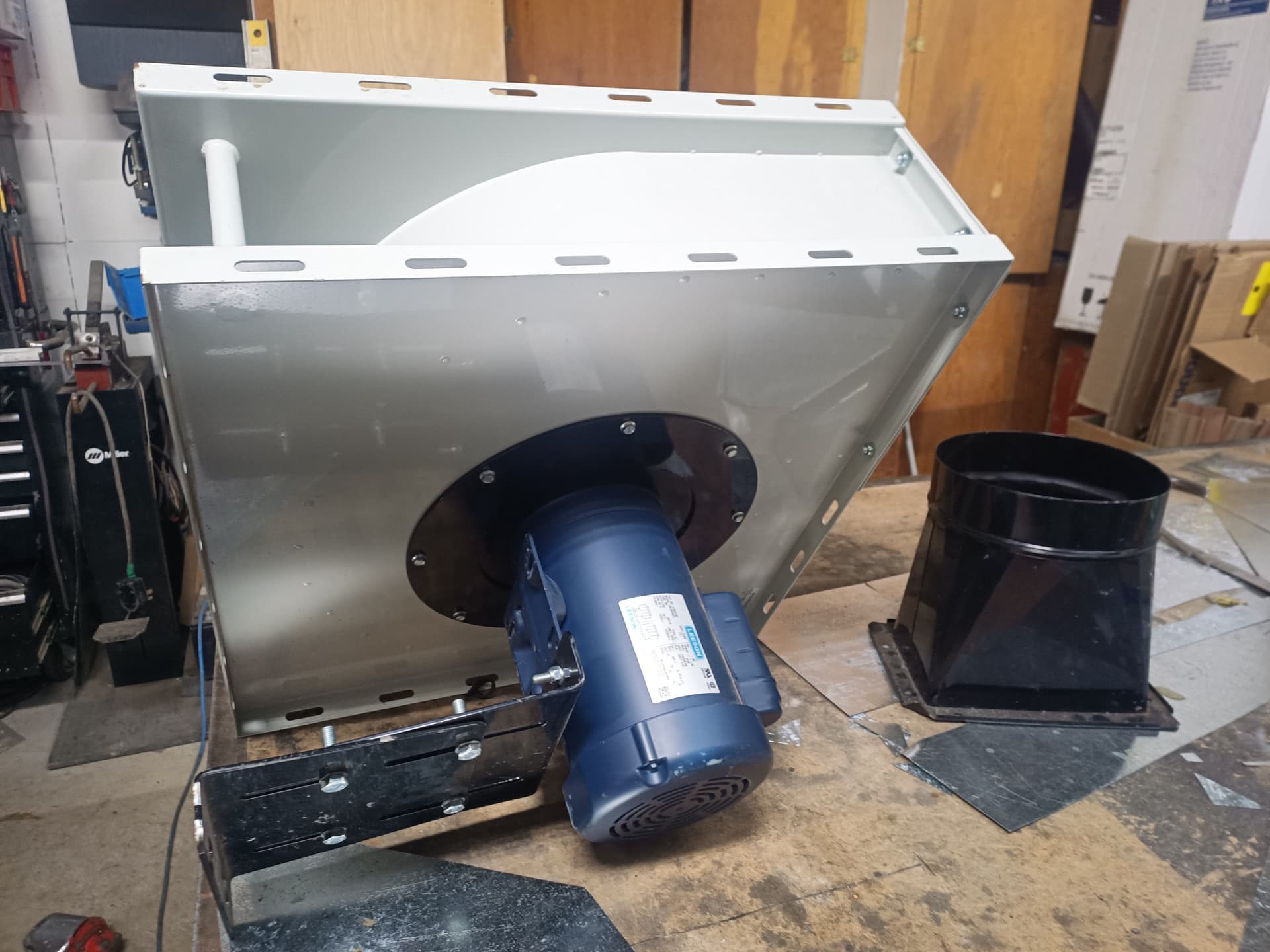

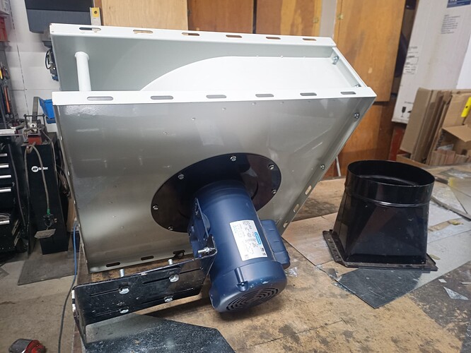

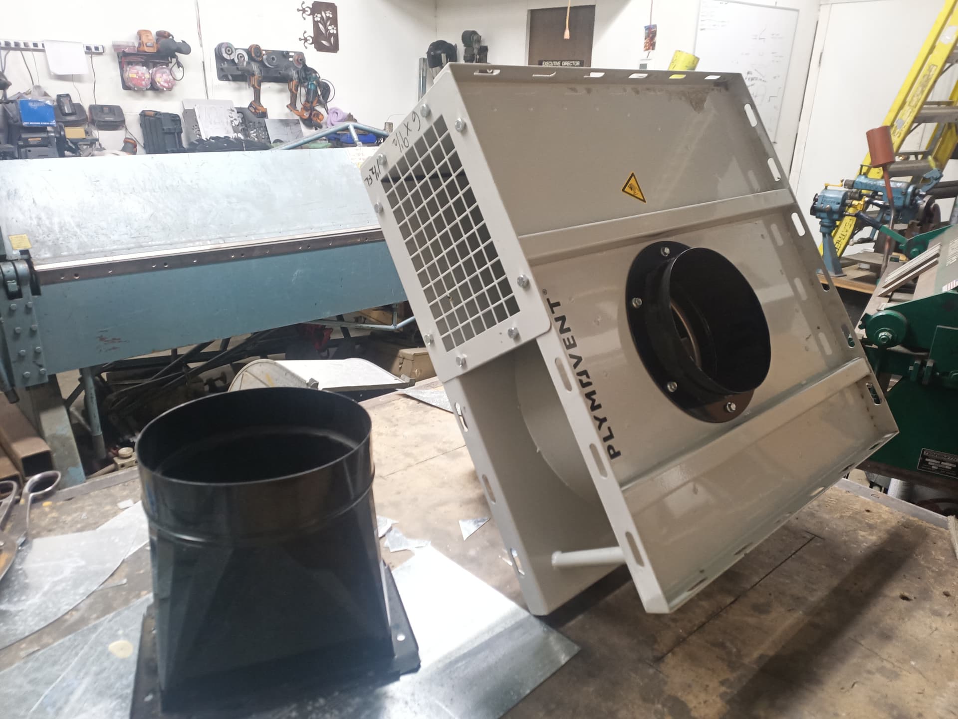

I just got my new ventilation fan.
It is a beast.

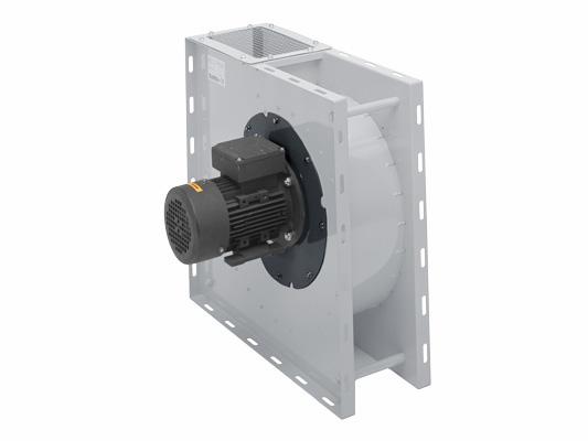

PLYMOVENT TEV
https://www.plymovent.com/us/welding-cutting-fume-removal/fans/tev
Mine is the little two horse model.
tev
Here’s a link to the spec sheet of anyone’s interested.
Is that to vent outside or to filter?
I’ll be venting out side. I have a large make up air duct that come in right by my table.
I also plan on it suck from the sanding table and from the welding area.
I will be adding a dust collector before the fan
Air make up heated?
I cant afford that. I placed the make up air right under the plasma table so that cold air make up doesn’t really mix with the room’s air.
