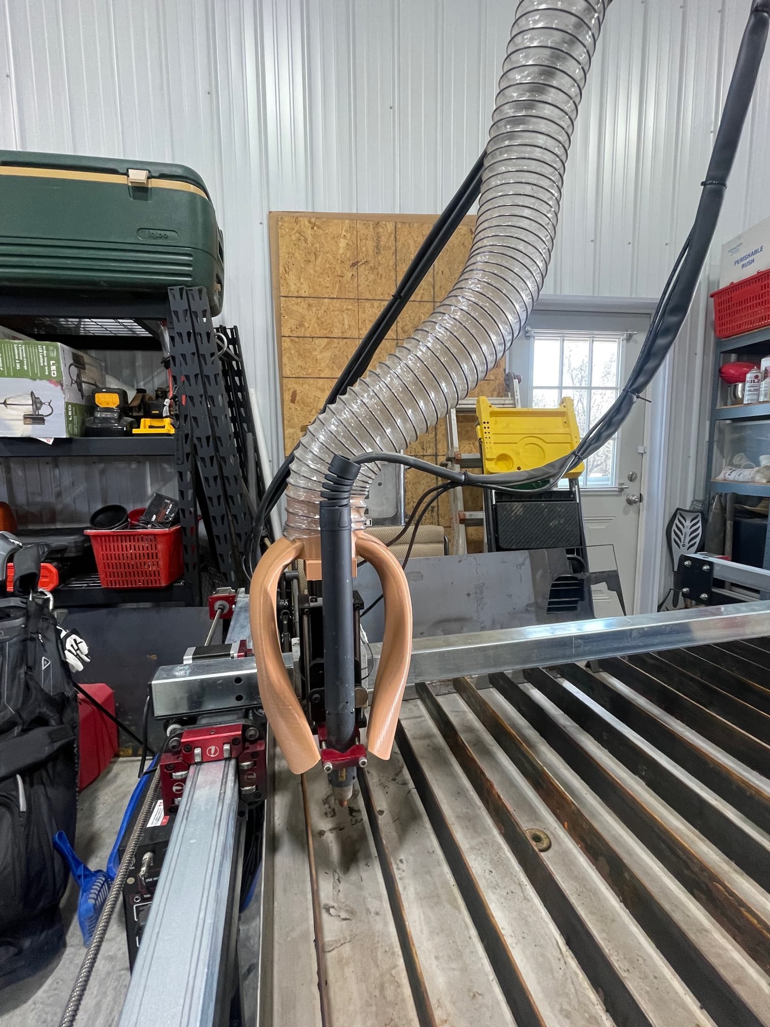

Would anyone be interested in a 3d printed fume extractor that pulls from both sides of the torch and moves with the torch. I have designed and printed one. It works well. I can post a picture if anyone is interested.
I would like to see if you have time, and I am sure
others would like to see it too.
Here it is. If anyone is interested let me know on here or it would be best to call or text.
Zach 317-442-9263
7575dman@gmail.com
Do you have any videos of it in action?
As clean as that hose is doesn’t look like it’s been used yet.
I would like to see how much pull it has. That also depend on fan as well
