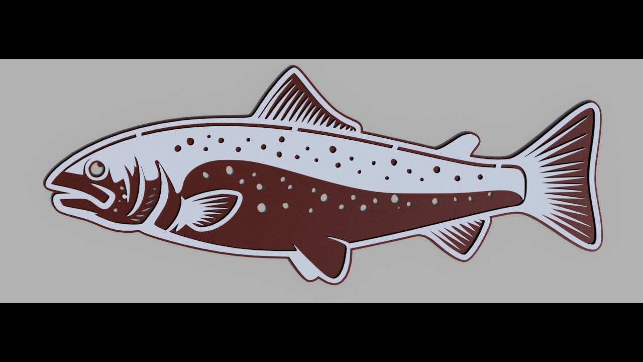

Next Stream is making a 2 foot rainbow trout of a customer. We will comb the internet looking for a suitable image or vector, Scale it and modify it with Fusion 360 and finish by making the CAM.
Start 520am mst
