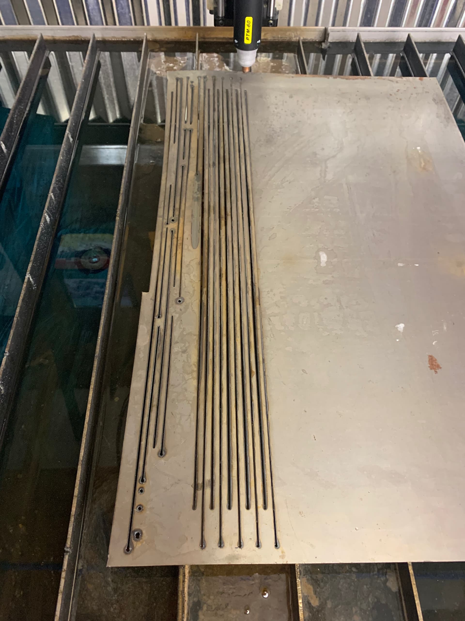

I had my z axis motor acting up and I squeezed the outer shield of the plug down a little to make it contact the plug at the box better. That fixed mine.
So, I actually have a complete Z-axis assembly. I was instructed not to swap it out until I had eliminated the freezing issue, for fear that it could become damaged again. I suppose I could swap just the motor.

I’m sure you guys can appreciate that I am hesitant to call this “solved” after everything I have been through with this machine. More testing is still required.
It dawns on me that when FireControl froze previously with the Z-axis unplugged, it was before I had fixed the USB port contact, so perhaps this was a two-parter. :blush: Fingers are crossed.
That’s roughly 20’ of cuts you’re looking at without a single issue. This is VERY promising!

So the Z axis motor has a short or what? I probably missed some info somewhere.

Bret, yeah, seems to have been. It was back-feeding arc voltage into the electronics.

Scott, yeah. I swapped the Z-axis motor, and that seemed to do it.
@nicaDd:
Joe, I’ve been waiting to install the new Z-axis until I was sure it wasn’t going to crash again. Never figured the Z-axis was what caused the crash. So, yeah, I swapped just the motor for now, and when I get a few more cuts on it, I’ll swap over the rest of the assembly.
And interesting side note, all of the motors seem quieter now. Could totally be my imagination, but I don’t think so.
