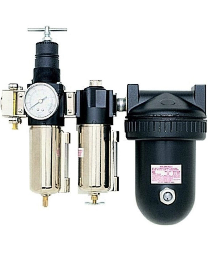

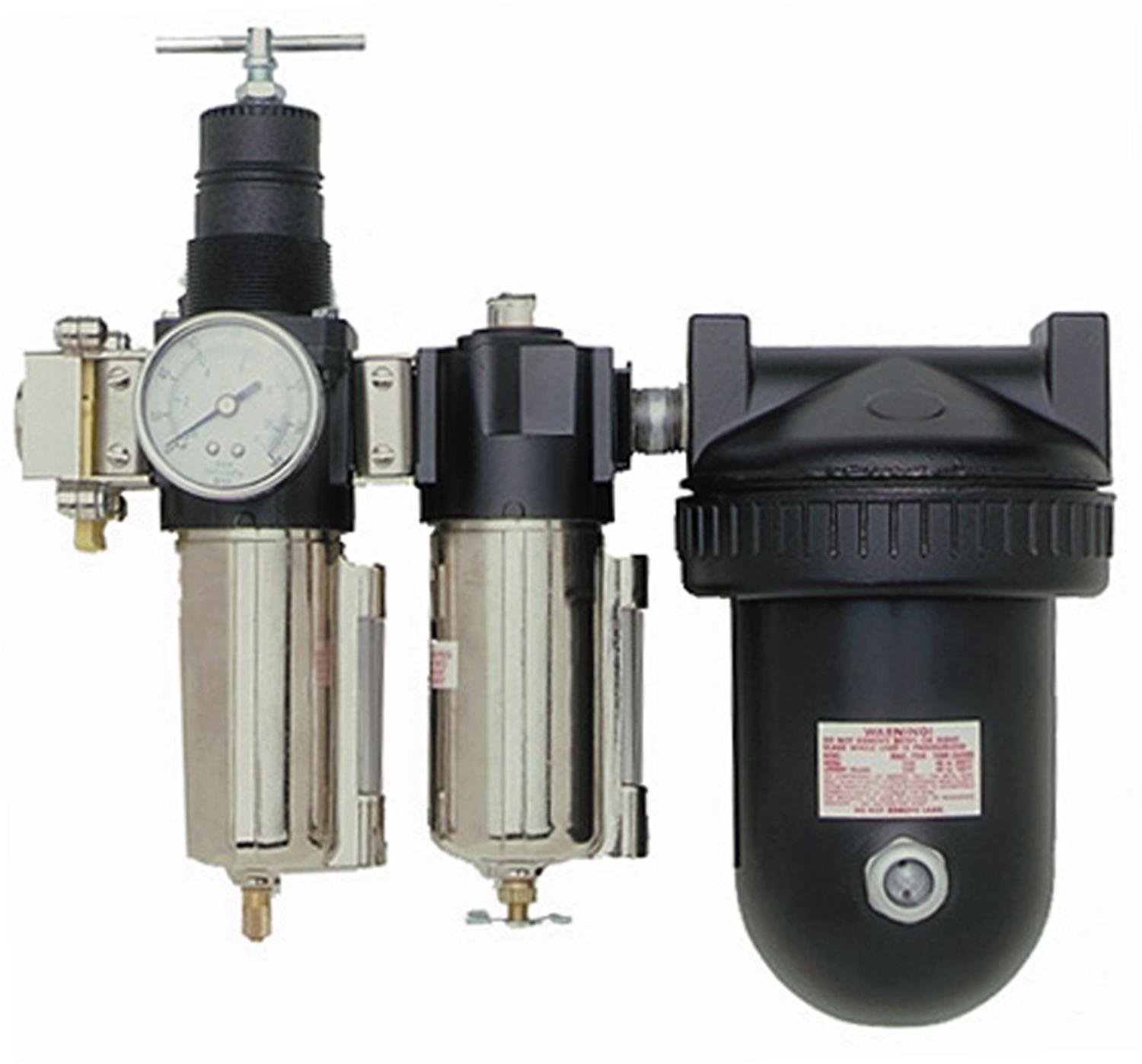

I know that stupid filter/regulator that Everlast includes is a restriction, but if I use it, I can put 120psi THROUGH my air dryer, and turn that down to 70psi at the back of the machine.
Otherwise I have to run 70psi into the air dryer, as the regulator is on the input and not the output.
It’s probably a moot point. And I’m sure I’m misunderstanding something basic about fluid dynamics, but it seems like I might do better with the restriction as close to the end of the line as possible. Can you speak to this?
Also, what I have, George, isn’t the standard “toilet paper” filter, but this guy right here:
It’s a pretty nice system and I’ve been running 40 days and my beads don’t even show a hint of moisture. I’ve got 10’ of 3/8” hose with Milton high flow fittings between it and the back of my plasma cutter.

You can just take the filter out and still use the regulator.
@CrazyCasey Thats what I do, I run full pressure right up to the input side of the regulator on the plasma cutter. then i do any adjusting i need to right there. I just went out to my system and did some tests. My torch will fire all the way up to 89indicated psi on the front of the machine. I get anywhere from a 4-6 psi drop once air starts flowing. Everlast 52i.
