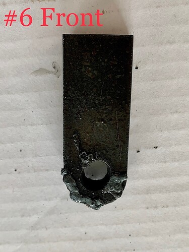

OK. THANK YOU everyone for taking the time to read all of these posts and help me try to figure this out. I have conducted a fairly exhaustive test, and I am having some better results, but still not anything close to acceptable. In fact, I’m honestly more confused than before.

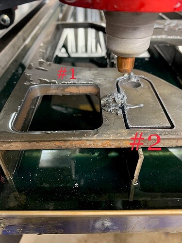

Cut #1 (2" square with 1" circle) was done at 55A/75psi, 30ipm feed rate @ 0.060" height, 1.5 second pierce delay. This was the best cut of the 6 I attempted, but top and right sides had heavy angularity out towards the bottom. Pierce also created a volcano of topside dross.
Cut #2 was run exactly the same, with the exception of trying a 1 second pierce delay. Topside volcano was worse, and the cut didn’t full puncture the first part of the cut.
Will be continued in next post…
In cut #3 I tried changing the pierce delay to 2 seconds. Topside volcano wasn’t as bad…
Cut #4 I went with the same 2 second pierce, but dropped my feed rate down to 25ipm.
Cut #5 I stayed with the 2 second pierce, but bumped feed back up to 30ipm again. Didn’t cut through on the corner…I think at this point my consumables were already on their way out the door…
Cut #6 I tried the 2 second pierce again and went all the way down to 20ipm. This was one of only two cuts that cut all the way through.
Like cut #1, I had really bad angularity (out towards the bottom) on the top and right side of the cut, and really bad taper inside the hole.
***I will note that I watched Fire Control instead of the machine on this cut, and the only corrective move I saw the THC make was downward (not upward), and the cut was made at the nominal (smart) voltage of 105V for the most part.
At the end of these 6 cuts (12 pierces) may brand new 1.1 nozzle was already trashed again.
Anybody have any thoughts on where to go from here?
It seems to really want slower speed and longer pierce delay. But I have no idea why it’s killing nozzles SO fast…

You really need to make sure the torch is at .06". It’s really common for the IHS system to have the torch to high, due to the IHS springback and backlash settings. On 3/8" material, I’d set those to zero.
The THC won’t fix that bad cut height. It will only try to maintain the incorrect height that it started at, unless you input a nominal voltage.

Ok, yeah, I’m at 0.020” springback, which probably means I’m actually cutting at 0.080” instead of 0.060”. Would that account for my rapid consumable failure? Also, where do I find the backlash setting?
Do you have any thoughts on the rest of the settings? Or the angularity that is out towards the bottom on the top and right sides, and in towards the bottom (taper) on my features?
along with what @ds690 mentioned, i noticed in one of the pics that you might be using the hard torch holder with your machine torch.
maybe @mechanic416 can chime in but it’s not good to clamp a machine torch by the torch head. It should be clamped to the body of the machine torch. You could be pinching the inside working parts and restricting it from working property.
OK, I just watched the video , that I should have before. The torch is mounted wrong.
And the torch height is way to high that is way all the blow back and your consumables are burning up so fast.

@mechanic416, I appreciate it. It sounds like I’ve been cutting at at least 0.080”, because of the IHS spring-back setting. But it sounds like I can’t set plunge rate with Fusion 360; it’s default of 100ipm.

75 psi is the book setting for 1/2" for the PW Cut60 I don’t think this is causing you any issue.
The taper could be from the torch being too high or speed being too fast. Beveled corners can be improved by slowing down the cut speed on corners and tight curves.
