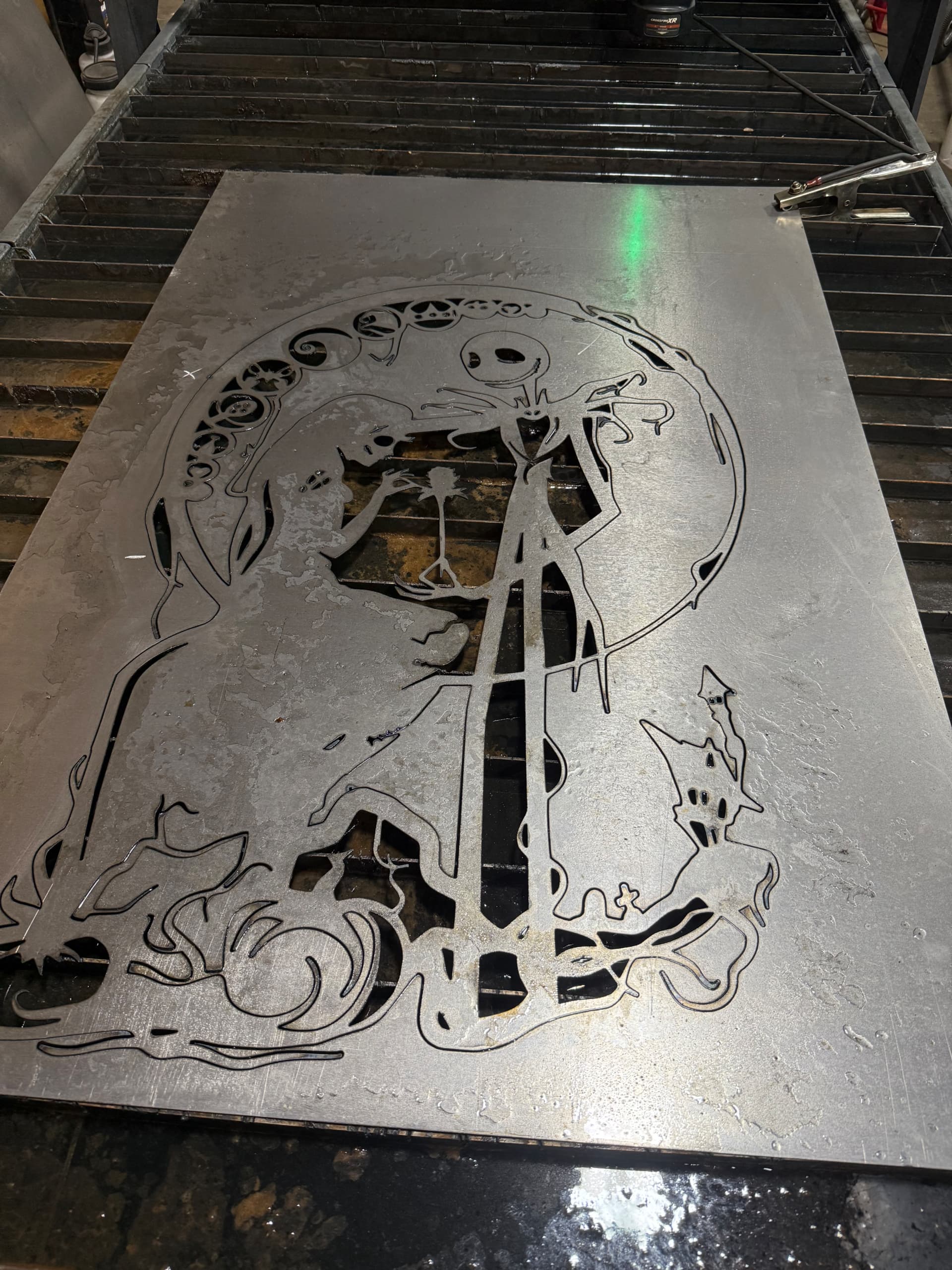

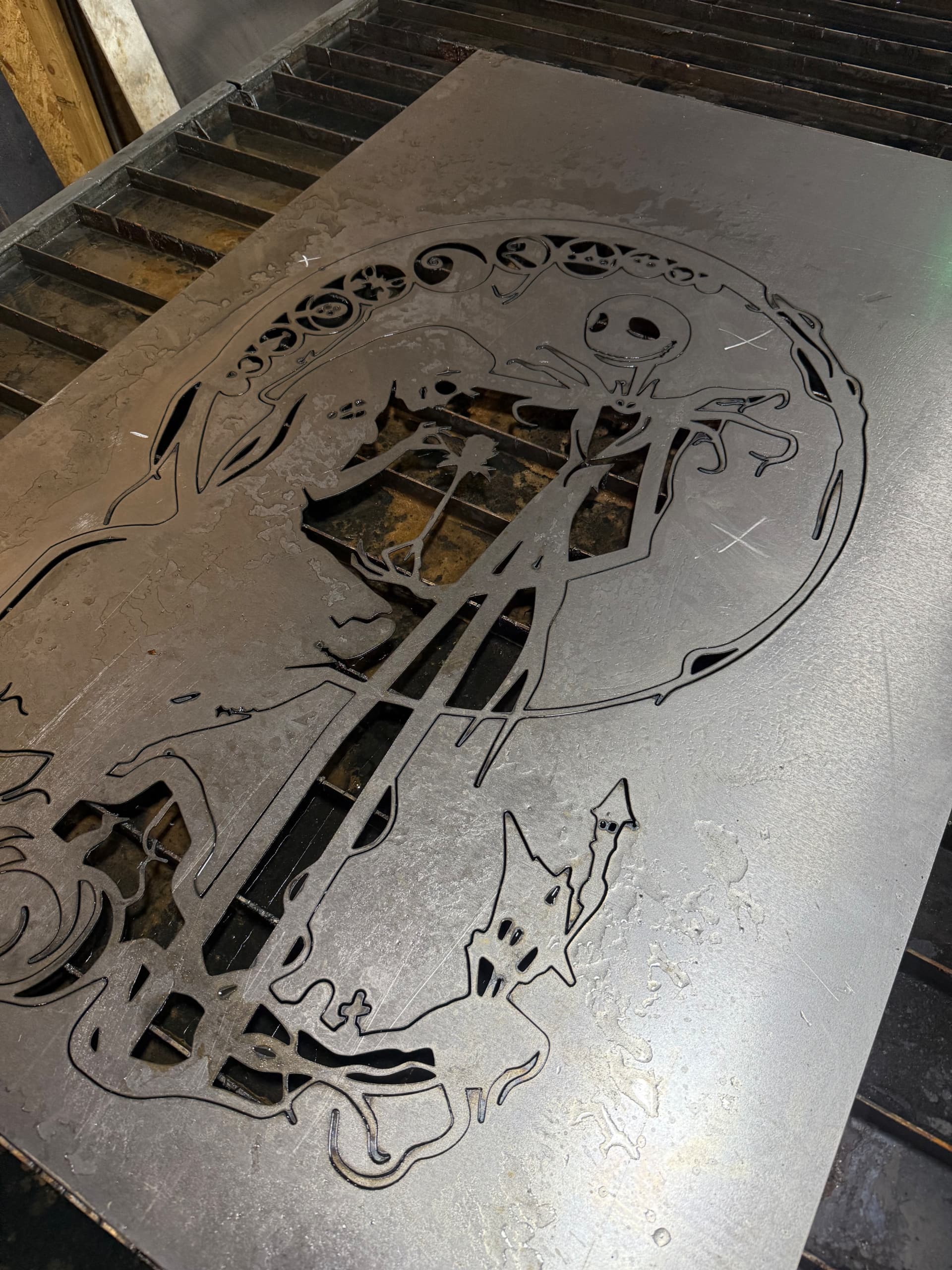

Ran the 3rd program which was a long run and noticed that during the cut this time the torch drove the tip into the material (16ga steel) and was dragging the the tip across the metal . It did this twice in the same program but opposite sides of the part. It did it on an inside contour and then lastly on the outside contour.

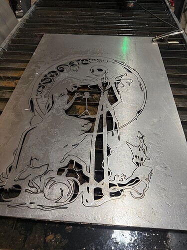

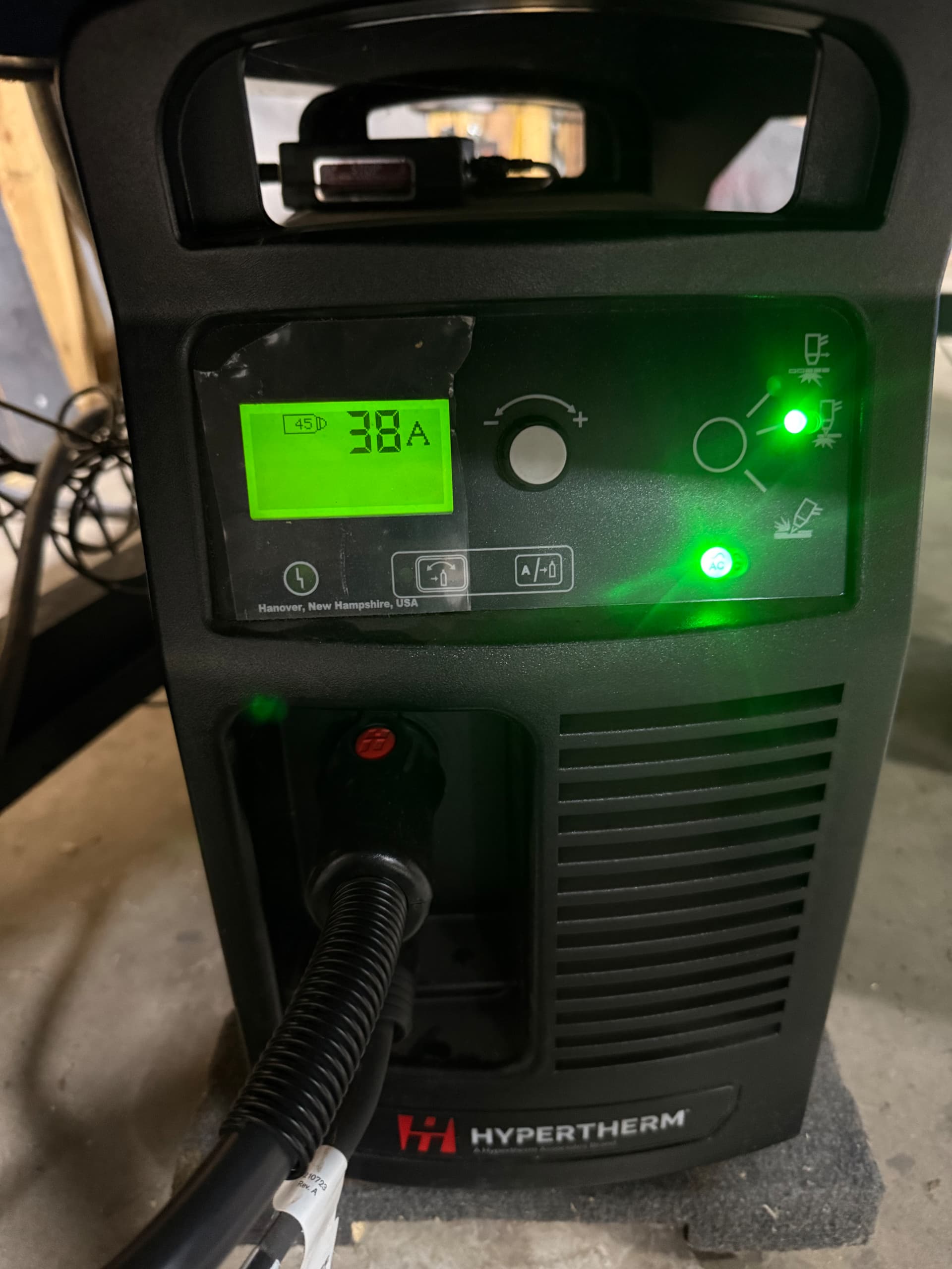

I did a voltage test prior to running the longer program as well just to make sure that was correct before I started. Here are some pics

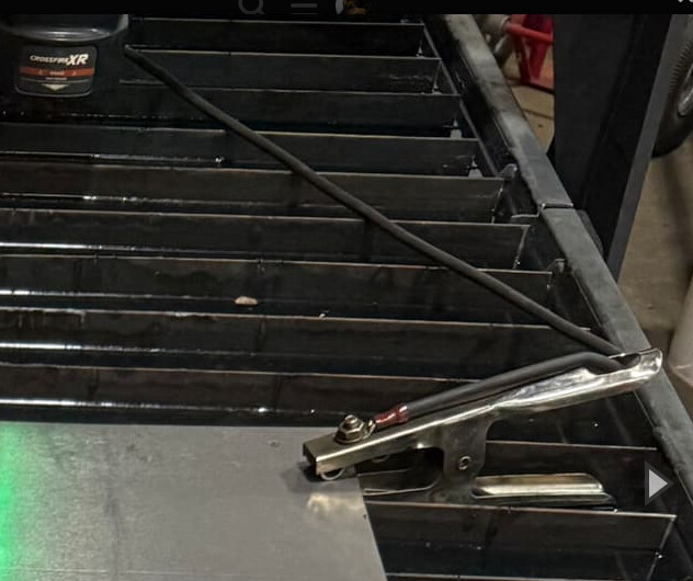

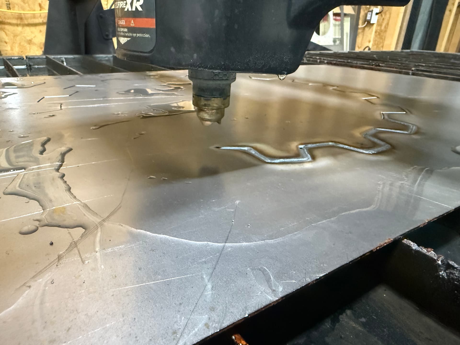

The soapstone marks on the upper right and left is where the tip took a dive, ground clamp at top corner. It messed up on the longer cuts maybe 1-1.5 feet in length before it dived.

What’s your screen show as far as voltage when the torch dives? Technically it should maintain whatever voltage it referenced on initial pierce so I would be watching my screen (or at least screen recording) so you can catch something you may have missed.

If you are using THC, the torch will be directed down if the voltage increases. This can be caused by increased resistance. Check your work lead to make sure there is nothing awry. Looking at this picture, there appears to be considerable strain. Perhaps with repeated abuse there are some strands broken, corrosion with the connection to the clamp or connections at the machine.
But if the torch were to dive on inside curves, one would expect the THC to be automatically turned off. If it dives at that moment, the height had been maintained appropriately because THC was reacting to what it perceived as “not enough voltage” and kept the torch higher.

There wasn’t that much tension on the ground clamp. It just looks that way in the picture

Everything seemed to stay at the same height throughout the program during the cut except those 2 spots in my part.
I will have to do another program and check, I stopped the cut and restarted at that line when it dived.

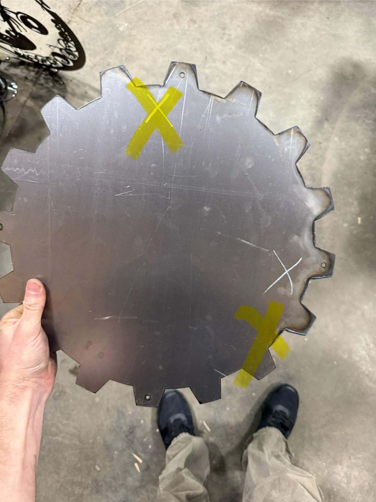

This was something I drew at work a while ago and finally got it cut, the yellow “X’s” is where the torch came up off the metal and rose almost an inch. Again this was before I tightened the ring terminals.

Looks like you have voltage after the torch turns off.
Unplug your limit switches and see if they’re still there.
You probably have one of them shorting out.

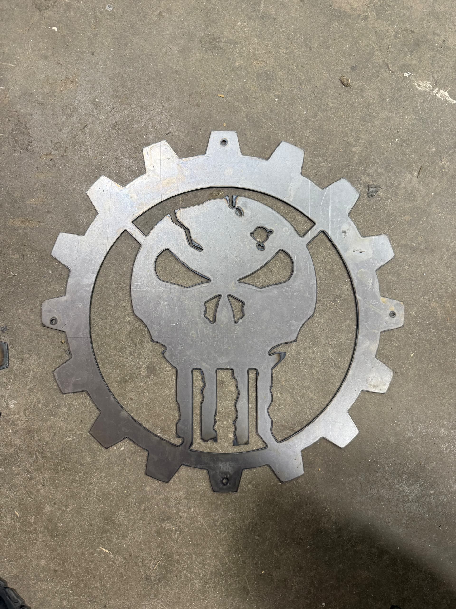

Ima post this to. Forgot I took pictures This is the part that messed up So in this pic this was the torch height it was cutting when I stopped it
When you do a screen recording again can you do it far enough away that we can see whether or not the IHS is coming on and off during the cut?
That cut height is way too high.

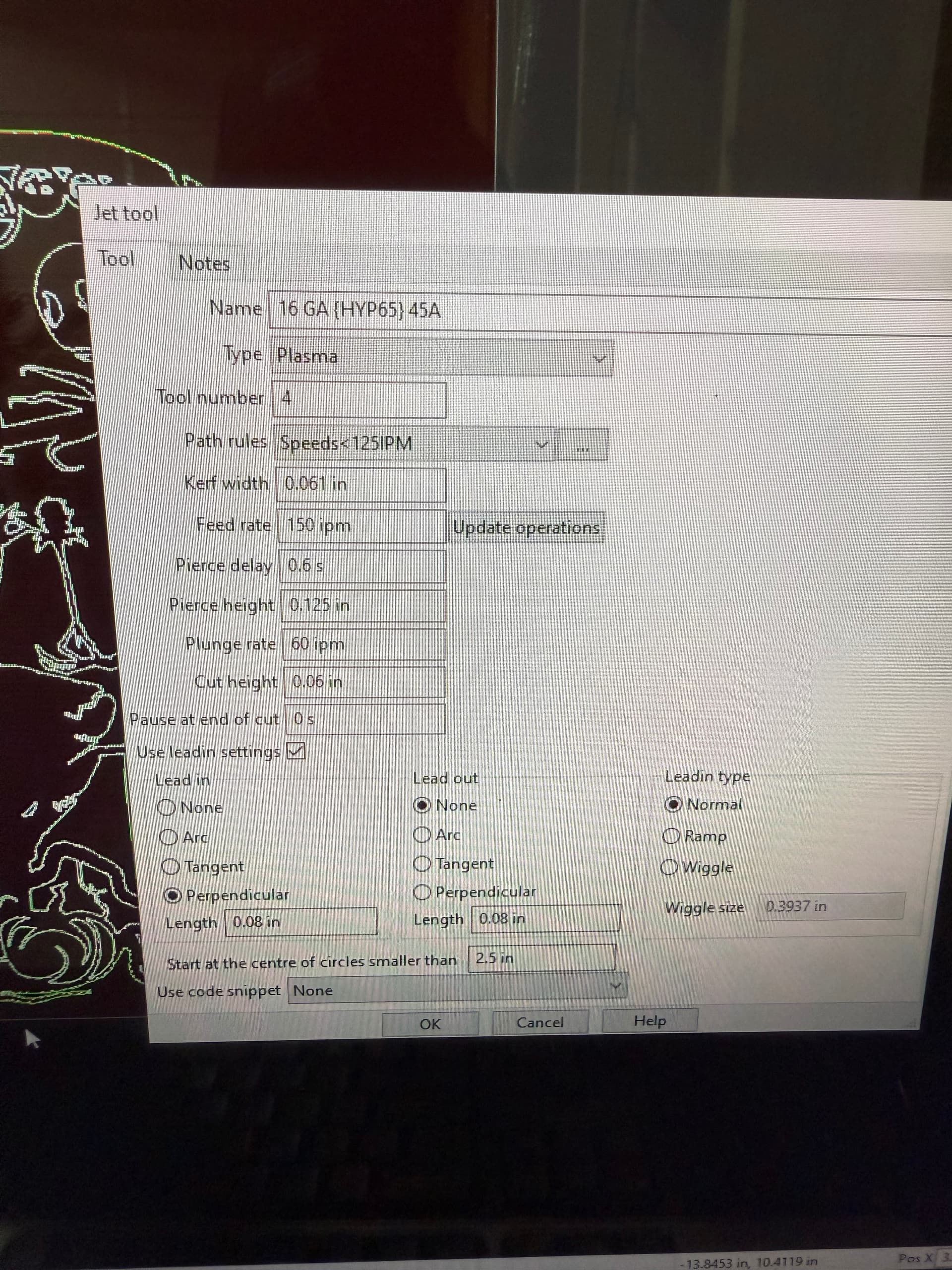

Could you post the tap file that you’re using

I can try to tmrw. I’ll have to figure out how to do it
And if you do another run try to grab a video from farther back or just do a screen recording on your computer itself. It’s a lot more information we can glean.
