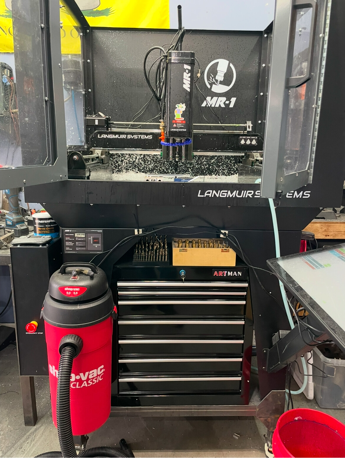

I have been making a few minor upgrades to the mill and also figuring out how to efficiently use the mill.
I added a shop vac to suck up the chips and a tool chest under the mill to hold all the tools and end mills.

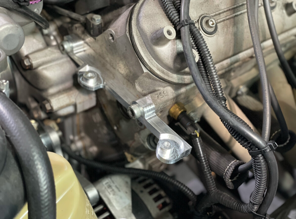

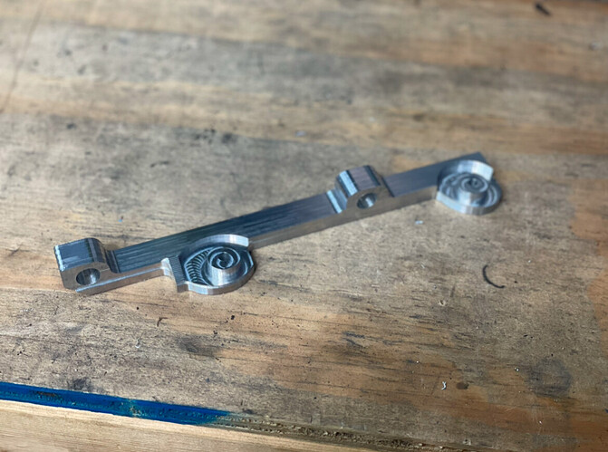

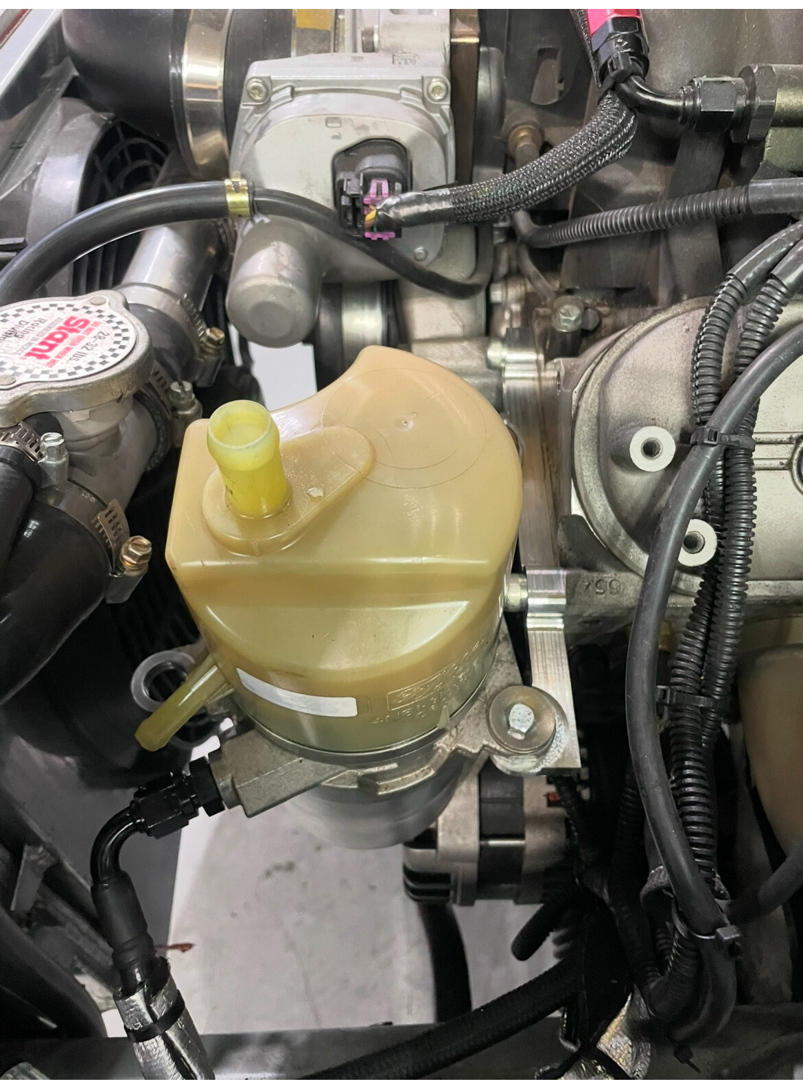

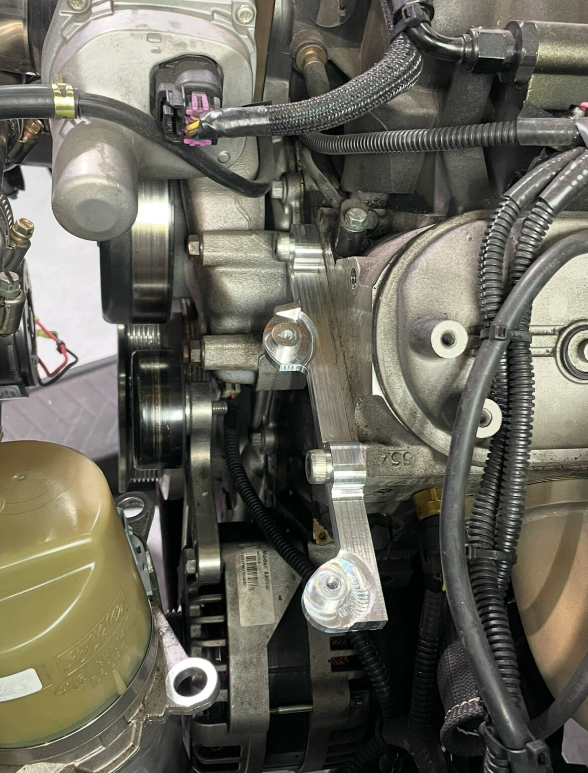

Also I refined the last version of my power steering bracket and this one is perfect for the Volvo power steering pump.
Can’t wait to design and make more parts!
