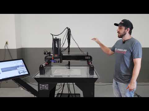

The machine homes in great now and I was starting to set the soft limits however I’m noticing that the X axis hits the hard limits about 1” from the bearing block. Is this correct? In the Langmuir video it looks like they can travel right up to the bearings. Pictures below for reference.
Are your soft limits disabled? The only hard limits I know of on the MR1 is when it runs i to itself. That looks like the soft limits are catching it well before the collision.
My thought is even with a different soft limit it won’t travel any further but I might be wrong. I am going to try and adjust the soft limits tonight.
The soft limit is/should be the amount the machine is ‘allowed’ to travel from the home position which is where the limit switches are tripped. If you aren’t able to get full travel after setting the soft limits by their instructions there may be a bug keeping it from going all the way.
I noticed the other day while machining that when I jogged the Z axis up I had the soft limit warning a couple of times before actually reaching the soft limit. I suspect that’s one of the quirks of the last software update, and hopefully it goes away in the future.
Would you happen to know what your X axis travel is from its home position as a comparison to where mine is currently stopping?
Turn off the limit switches on CutControl. Then see if it will go all the way.
As soon as I get how me that’s what plan to do. When the X ball screw wasn’t attached I could slide the mill head full left and right so it probably is the soft limits. I will report back.
I disabled the limit switches and the soft limits were turned off and it is still stopping in the same location.
Very unusual. Do you have the lead screw nut to tight on the end? Are all the support brackets squared up? Try loosening the bolts on the end bracket to see if they are causing a bind. Run the X as far as it will go. When it stops at it usual place, loosen the lead screw support end bracket bolts to see if they snap into place.
I loosened the bolts and there was no difference. I tightened all of the bolts and tightened the coupler and the same thing happened. Honestly the mill head is over the drain at the farthest point and there is .69” from the leading edge of the mill head to the bearing block. I think that’s pretty close. I sent a video to tech support to get their input as well but it I could live with it if it is what it is.
