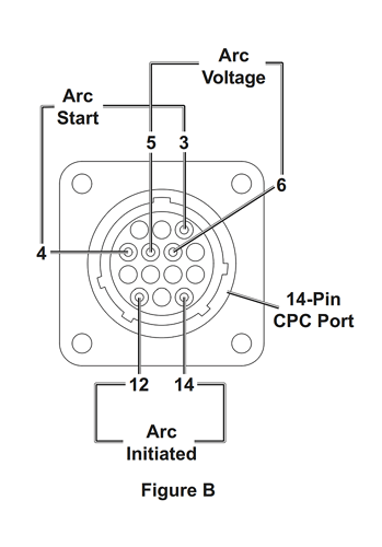

Arc Voltage
The Arc Voltage circuit is accessed through pins five and six of the 14-Pin CPC Port; it has a default arc signal ratio of 20:1. Pin five is negative and pin six is positive.

I located the CPC port connector for the New Model Titanium 65. Now to put the appropriate pins in the plug. Per the HF instruction book looking at using the “Arc Start” and the “Arc Voltage” spots. Anyone out there have any ideas if I am on the right track?
Best wishes. Thanks for helping
Raw Voltage. The machine has the wrong divided voltage output @20:1. Your table needs 50:1. You can use the CNC port for your torch switch though.
I believe the pins 3 & 4 are what you want.

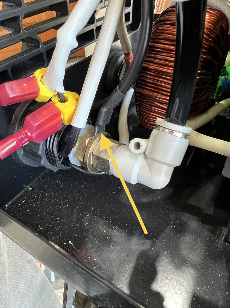

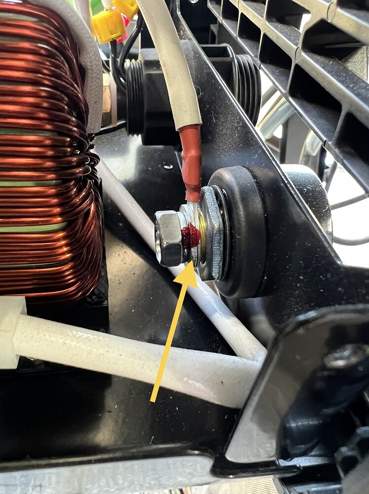

Red to the work clamp… Black to the torch.
Hook it up just like this. Pay attention to the table connection in the picture. No connections right of the blue line.
In this picture you can also see the torch on/off connections just above the torch connector bolt inside. Black wire torch. Red wire to work clamp.
The torch switch connection is just a switch, so the wire hookup does not matter.

So. I did as you advised inside the cutter to get raw power. One lead to the clamp. The other to the torch power. Those leads on the banana plugs into the small box. One clamp. One Torch. Then on the CNC port with the correct plug. Pins 3 and 4 arc start on the wire/pigtail plug going into the DIV input on the small box. Now the other side. The patch cord from the table box labeled Torch into the PV output . Now the other plug in cable goes ?? Only the DIV Port has nothing in it. Questioning if I am there or this last plug in cord is used. Still wanna not ruin some good equipment. Thanks for your patience with me.
PV to the THC aircraft connection on the control box. The Torch on/off to pins on the CNC port.
No connections to divided voltage pins. Only the banana plugs to inside the plasma cutter. Black torch/ Red work clamp. No divided voltage. Pins 3 and 4 to torch on off on control box.
Nothing connects on the right side of the blue line in the picture.
