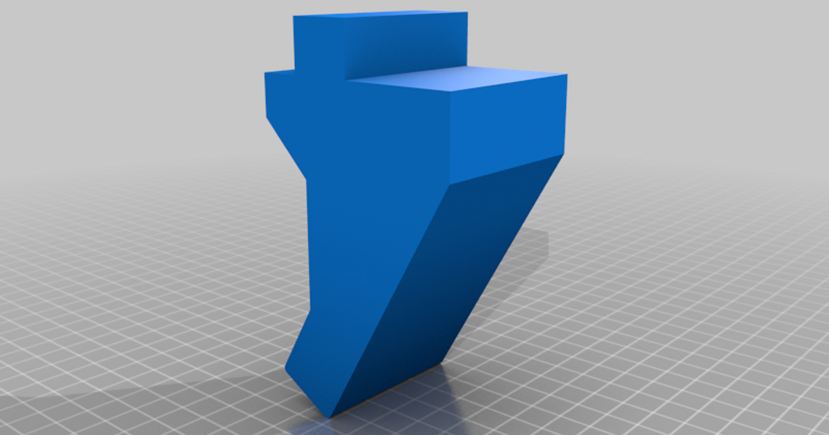

I can confirm that 3d printed dies with 100% infill have no issues bending 16ga steel in press brake. I made a gooseneck and v nose die this weekend as test since I already had the template from when I cut some out of steel this last summer. I have swag off-road finger setup and this is solid backup for any odd ball dies you might need in future if you have 3d printer.
what did you use for Filament?
I just had a friend make a couple of dies for a very specialized press I have and he used PETG.
It was between that and PLA. I have yet to try them.
I will post pics and post how they work once I get them.
PETG and make sure he did 100% infill. You’ll know because they’ll feel solid.

It was 100% infill, I will see if it will work, these are totally different than Press brake dies, so who knows
There is a good YouTube video where a guy tests 3d printed dies in his brake. It’s very promising. Was always gonna have a buddy print me dies but then I started hunting auctions. We’ve got a pretty good auction company in the area that just does welding and machine shop auctions. I’ve bought regular dies, punches, gooseneck punches, and a big section of 4 way dies. Was bidding on a nice set of 3.5" dies but they cancelled the auction part way through. Those would have worked with both 3/8 and 1/2 steel.

Have you posted these files anywhere? I just got a 3D printer and have a lot to learn!
Donp does not come in here anymore he has moved on to laser engraving and 3d printing
Here is one of “Printables” that should get pretty close.
