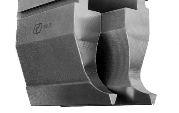

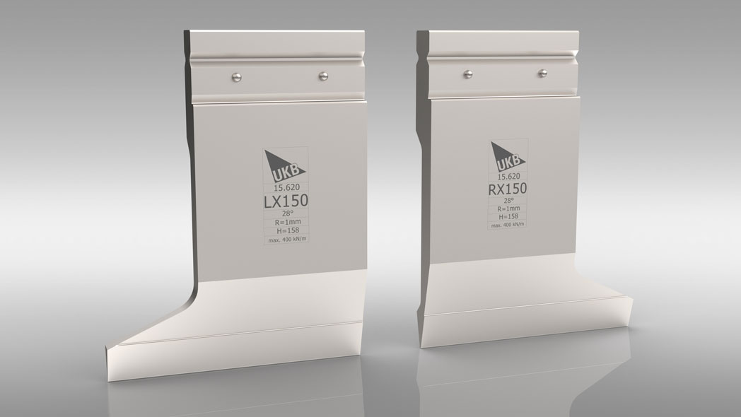

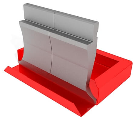

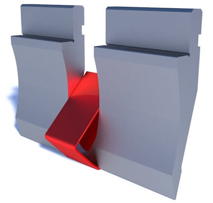

@langmuir-sam I thought I would bump this request again for horned extension punches to match up with the ends of your existing tooling because we have a project that these would be perfect for.
I guess if I had access to a wire EDM machine I could cut my own nicely. I would prefer to just buy some from you guys though.
Anyone else out there have any interest in horned extension press brake tooling to match up with the existing offerings from Langmuir?
