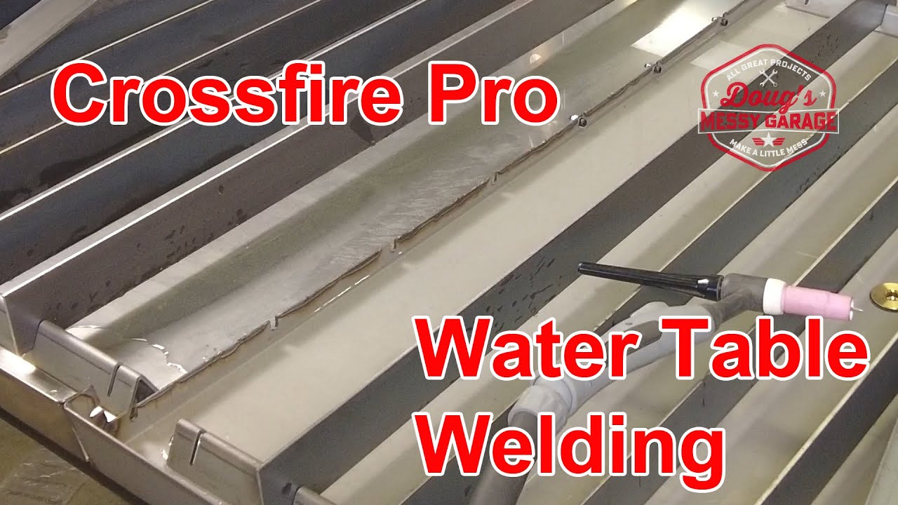

Thanks for all the info on this thread. Finally got around to welding my pans together. Worked out great and just thought id post so others will not be afraid of doing as i was. I simply clamped by pans down to a certiflat table and welded in small sections as was recommended. I used clamps and a few bolts on the seem as needed. Where the bolt slots were at I used a cutting wheel and opened them up to allow for easier welding. All things considered I was just putting it off as I thought it was going to be a very hard weld to tackle. I used no filler rod and and it turned out fine. Just took my time. Also made my own system with a couple sockets and a bolt to dimple the drain. Ill post a couple pics of that as well. Hoping to get table up and running this week.

I am not a master welder by any means…the trick I found was to bolt the tray down on the frame…bolt it together without any sealant…the add 1/4" water in each pan and fuse/melt the seam together…just like the picture above…worked great for me
I followed Toolboy’s guidance and was fairly impressed with how the welds turned out given my lack of time running a TIG torch. I recorded my experience for YouTube and will be posting a video in a few days.
If anyone is interested, here is the video I did about welding my water table.
