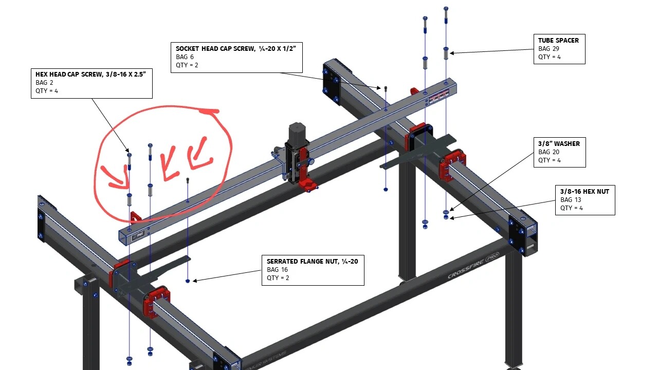

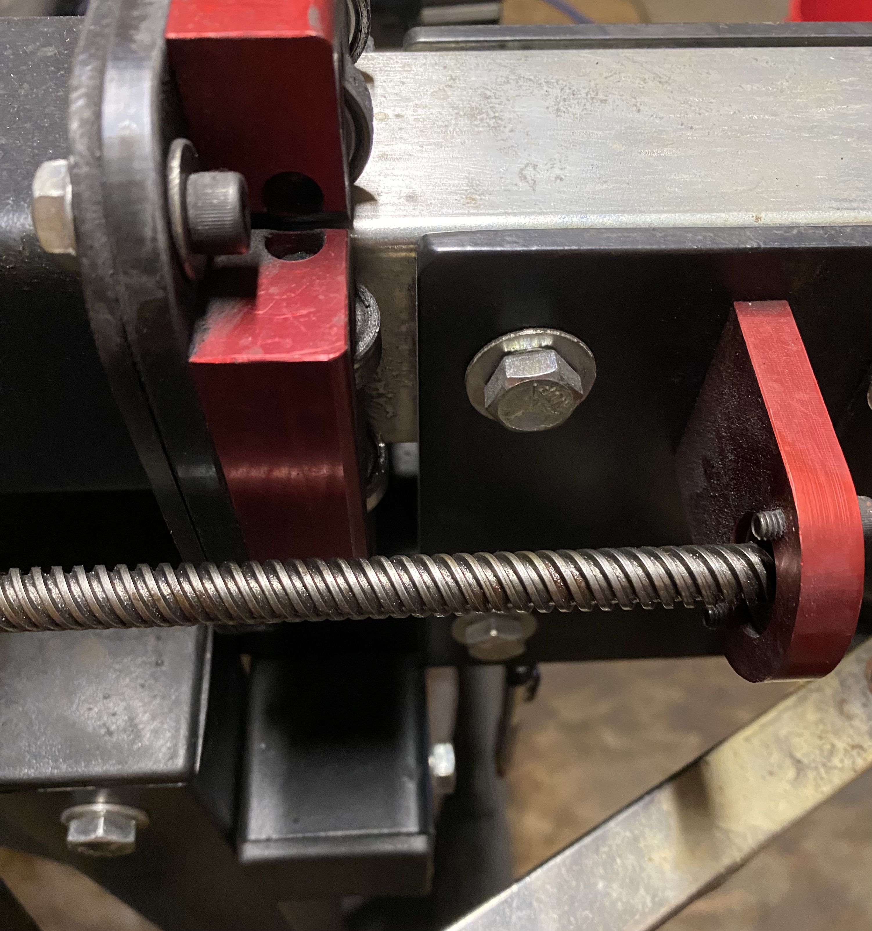

Now I got it square but my gantry arm is stopping early on one side
Loosen the bearing carrier bolts just a little. The carrier is not totally square with the frame.
Run the carriage as far as it will go, take an Allen wrench, and loosen the bolts. The carrier will snap back into the square. Then, retighten the bolts. From the picture, it looks really out, but that could be the angle.
There are three bolts on each side of the X axis rail that attach it to the weldments. There is enough play in those mounting holes to allow a considerable misalignment of the X axis.
Run the Y axis up close to the stops and then loosen all of those bolts. Turn off the power to the control box and turn the lead screws by hand until both sides are touching the Y rail supports. Tighten the bolts holding the X rail again.
The X should now be very close to square with the Y axis. It could be slightly off, because the Y rail supports have some play in their mounting holes, as well.

These three bolts on each side of the X rail. They attach the rail to the carriages that ride on the Y rails.
You should consider going through the assembly instructions that can be found on the support page of the Langmuir website.
You guys are awesome ds690 and bigdaddy2166 thank you so much she’s going good. Got her fixed up I was doing all the wrong things.
