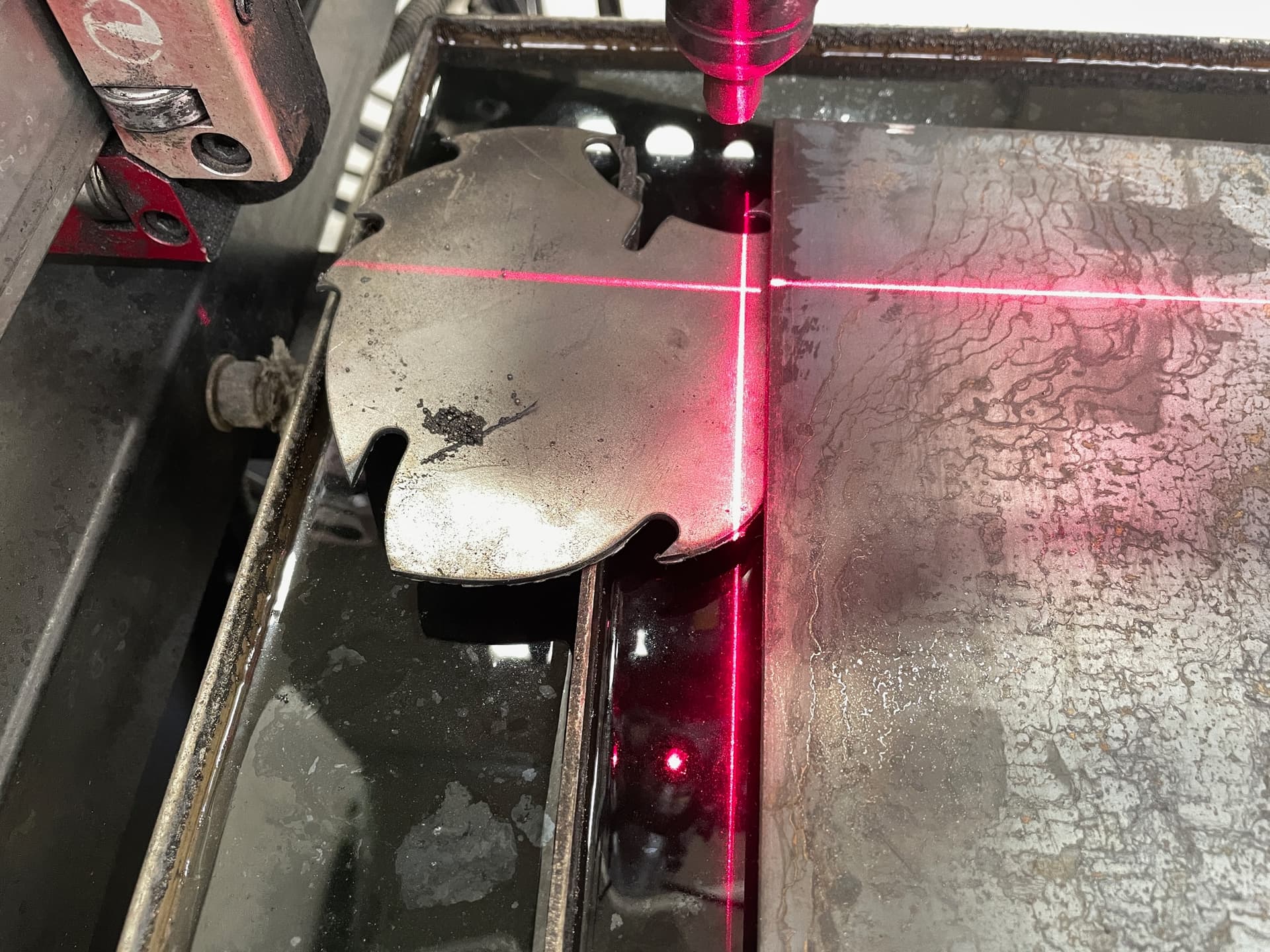

I installed laser lights on the THC…and they work great for setting torch up when cutting filler pieces out of scrap…
but I noticed something the other day…I am not getting square cuts in reference between the X and Y axis.

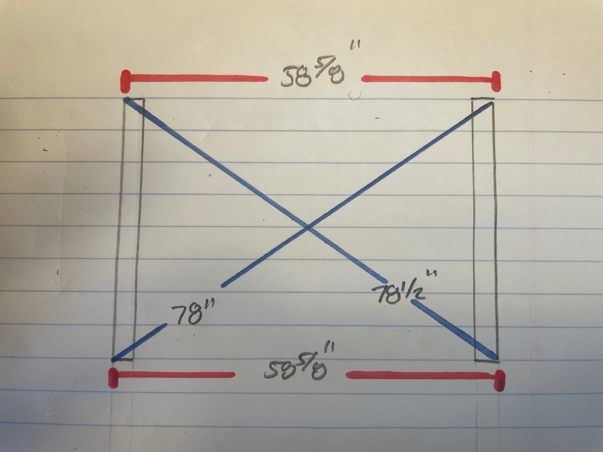

so I did some checking…first I measured all cross table and side to side…WOW…out 1/2"
The sides are parallel just fine…

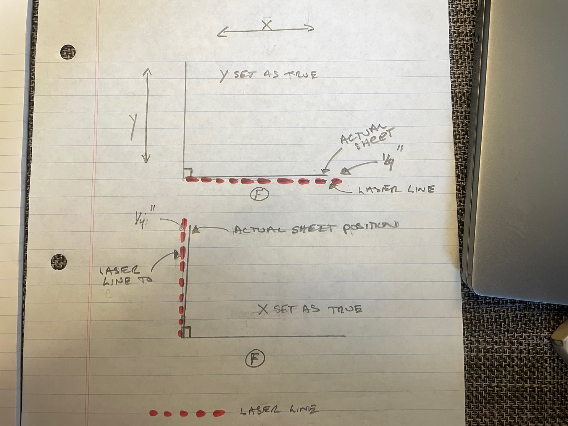

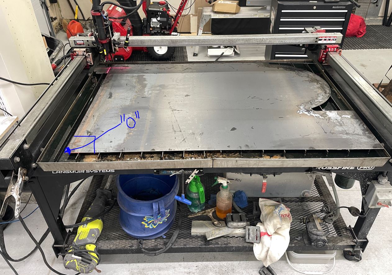

Then I set a perfectly square sheet down on the table and checked it for square with the 3-4-5 method and with a large frame square…
I set the sheet with the lower left corner as reference “0”
I then lined the sheet up running the Y axis to the top left and set the sheet square to the Y axis.
When I went back to “0” and ran the X axis at 40" the laser was 1/4" below the sheet.
So then I lined up the sheet with the same “0” point and made the sheet square/parallel to the X axis.
When I ran the laser up the Y axis…I found it also out at 30" out almost a 1/4"…again the laser was outside the sheet…

Based on your measurements, the table is clearly racked. The Y rails can be parallel and still be racked. The measurements say that the right side needs to be pushed back and the left side pulled forward, in order to make the parallelogram into a rectangle.

I say need to loosen up table and shelf and get the cross measurements to be equal and tighten it back down and make sure it is level. I would think at that point should cut square as long at fhe gantry is square as well.
