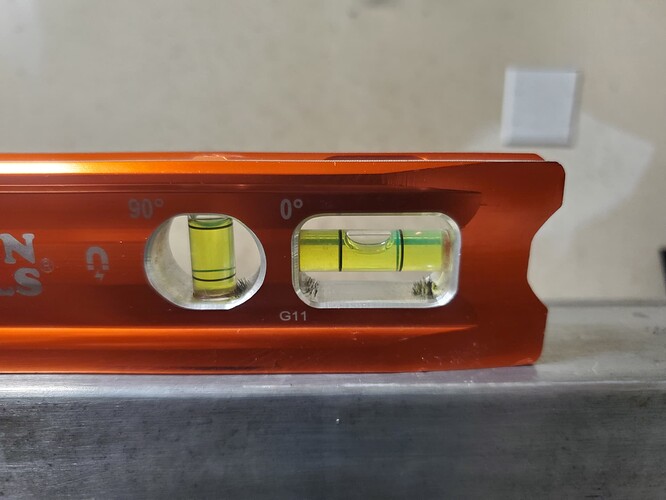

No it isn’t tramming your z it’s called leveling your plate to you z axis …
Your plate will not always sit square to your z axis.
From one end of the 2’ x 4’ plate, torch head is square to the metal the same way it is on the other end.
If the frame is out of square, this would twist the already flexible water bed.
One experiment I’ve yet to do that was suggested is -
Tape a pen, or sharpie, to my torch and run an X axis movement from left to right and time it
Then run the same X axis movement from right to left and time it
Ensure it works equally from left to right and right to left
I don’t think you understand. Did you check to see if the plate is level?
It is a simple test to try to see if it helps.
You’re right, I don’t understand.
But, does this help?
Plate
X axis tube
Y axis tube
The plate you are cutting. If it isn’t level. “square” to the head it may not cut straight. Think machine work.
Just a thought.

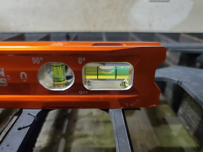

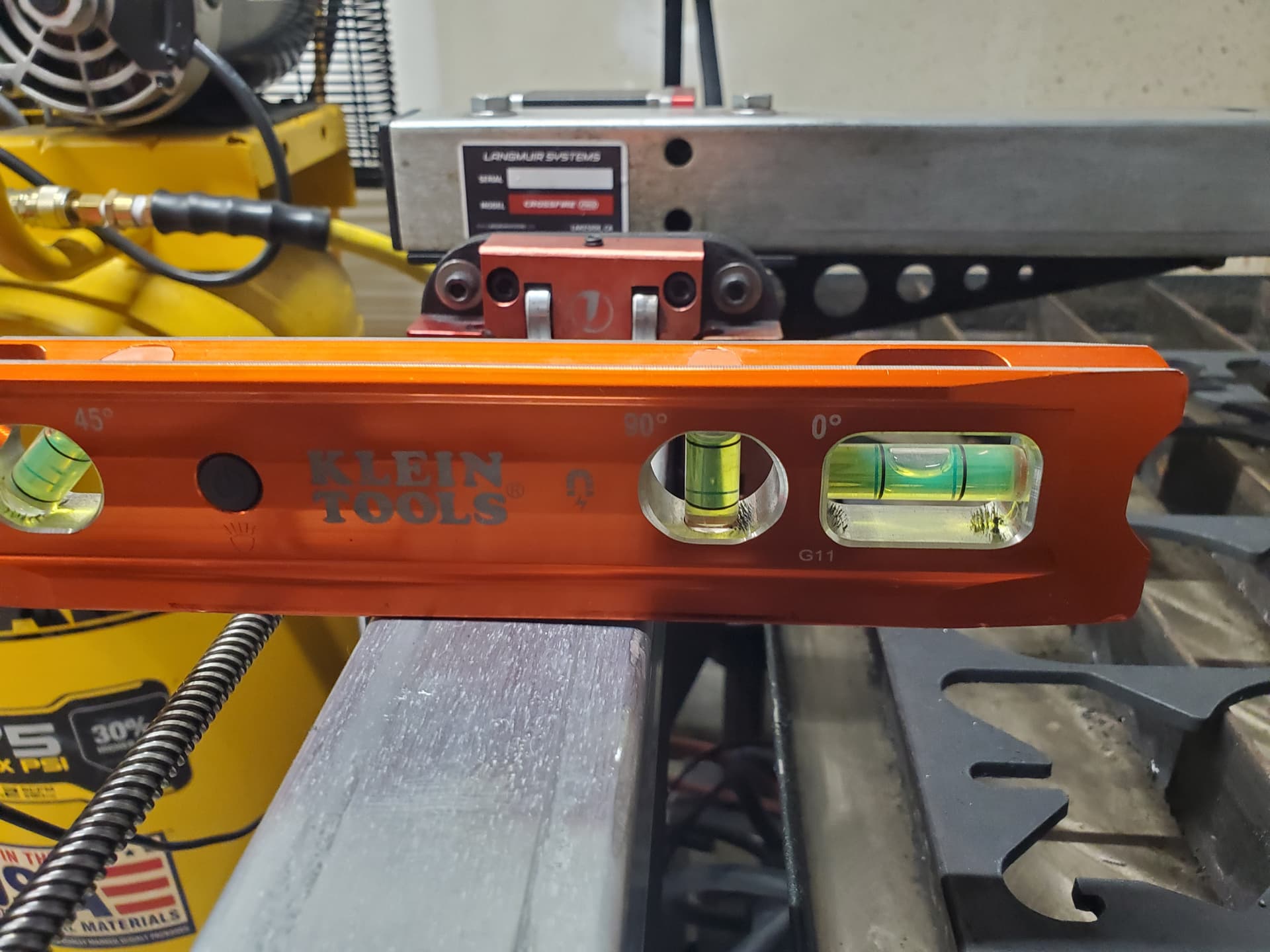

the plate could be level but not square to the torch. Checking anything with a carpenters level or a small 9" level wont tell you much. you would need a machinist level.
I think the torch being Sq to the plate is what matters (as long as the table is fairly close to setting level, not all jacked out of shape)

If you have your head square to the slates and lay a piece of metal on the slates you can’t assume the plate being cut is square to the torch head. That also gets worse as you cut on the slates … And a quality torpedo level will work fine.

If I was checking for Sq I would never check the Slats themselves I would always have sheet or plate on the table.
